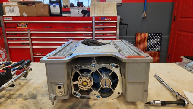

Anyone have access to the torque specs for these T30 water manifold screws? Looking at T30 screws the max torque is 31.1 - 37.4 Nm (23 to 25 ft/lbs) which feels way too much.

If you don't find a factory torque spec, look for a spec for the thread size in ALUMINUM, don't even worry about the screw, it's not the limiting factor...

What size are those? M6?

M6
Guy on the other forum posted the factory manual spec at 7 ft/lbs. SDG had 10 ft/lbs when installing their billet manifolds. I went with 10.

5.7lb-ft is what I came up with, but I didn't have all of the variables

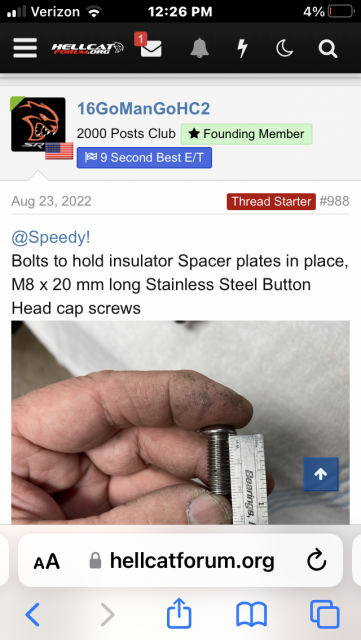

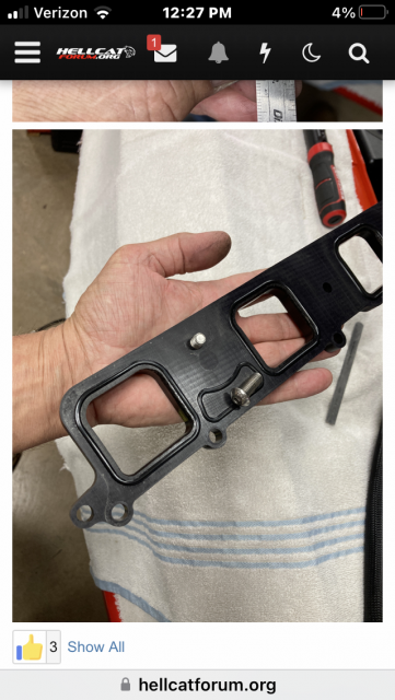

Bringing this back to life. Planning on re-assembly tomorrow. @16GoManGoHC2 you suggested I use SS button head bolts instead of the plastic push pins on the FI spacers? Do you remember size and thread pitch? I think that's the only thing I don't have sourced.
Mike confirmed these are M8x20mm figured I'd mention it for anyone following a long. I couldn't find them at the big box hw stores so I had to go to Ace. $1.60 each (!) and I needed 4.

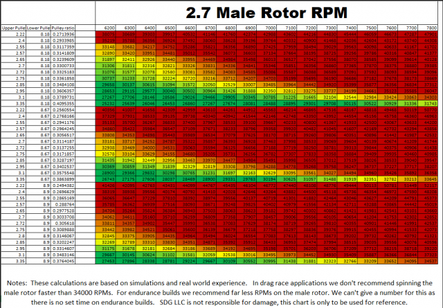

SDG blower speed chart for a 2.7 you are fine at 6500 2.85/10%
7,473
19,638
Thread Starter #199
That's what the chart says.

2.7L Efficiency Chart from SDG for those interested. Of note is the text at the bottom which my attention was drawn to.
