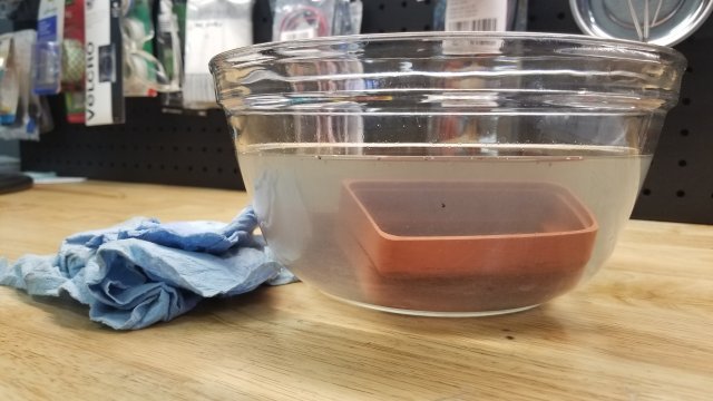

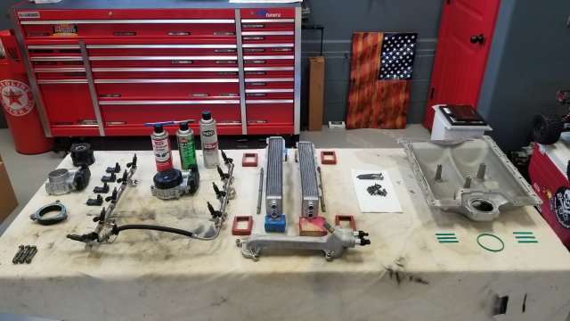

Thread Starter #159
All cleaned up.
1,569
3,916
looks like the Doc is prepping for surgery :)
