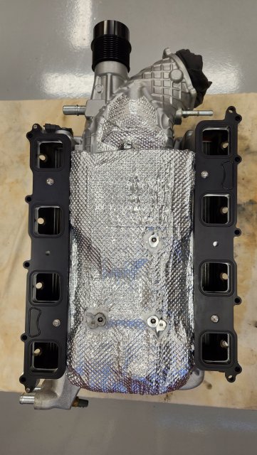

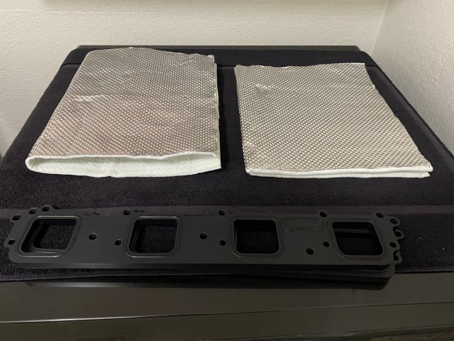

Yes I have spacers and blanket, wish I knew your buddy had them for sale but I got mine back in July.
