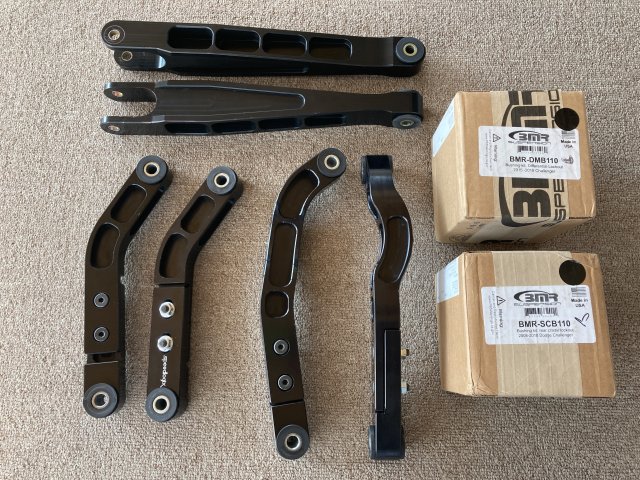

I would do your lock out kit first an no you don`t need to drop exhaust. start on one side first, I started at R.F. corner of cradle an if you need more drop back off R.R. corner . hardest part is removing that odd shape safety wafer they put there. once you have done both on right side torque your bolts before you move over to left side ,that way there`s less chance of misaligning the whole cradle.I would do these first then take it for a ride to feel the diff. the arms are more involved but no need to remove exh.
when you do the arms remove the camber arm first then the upper forward arm , do the lower trailing arm last. install uppers with lower still in place .
they sent with stock length tabs in place. lay the new arms over top of stock arms an you can confirm yours are set at stock length.

just looked again at the parts picture an see you have speedlogic arms without the tabs for adjustment. hope its all going smooth for you.

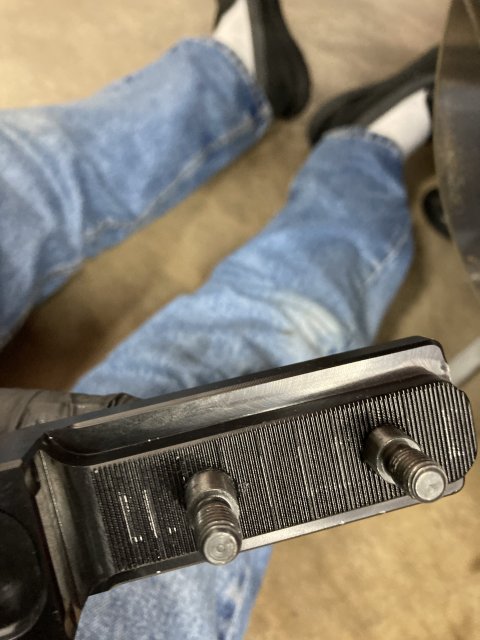

Done, from this
To this
The Speedlogix ones use serrations, each click is .030”. I set them 2 clicks out from matching the OEM arms.
6F6AB759-C6F6-47A7-82A7-48F43B5F86E0.jpeg EED06050-8C61-4C52-9B3B-8D069A5AB8A5.jpeg

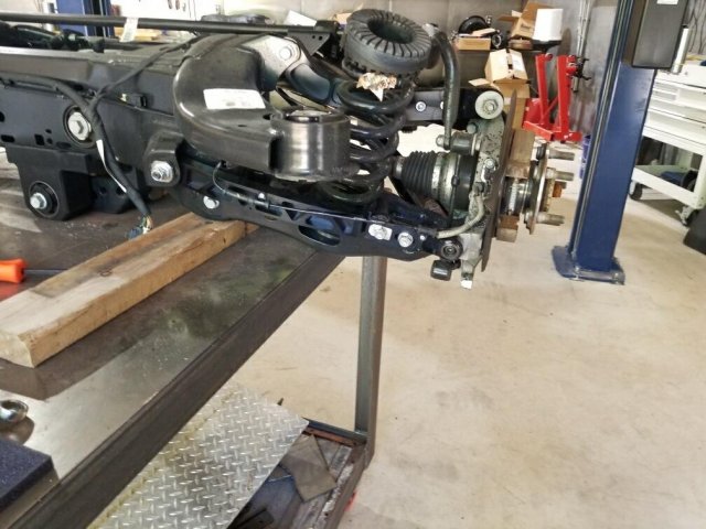

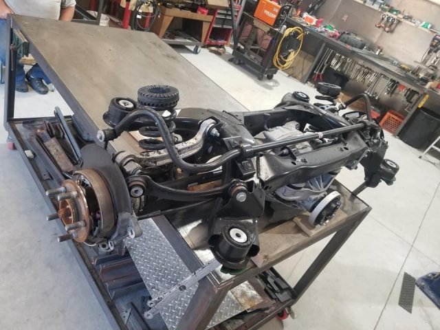

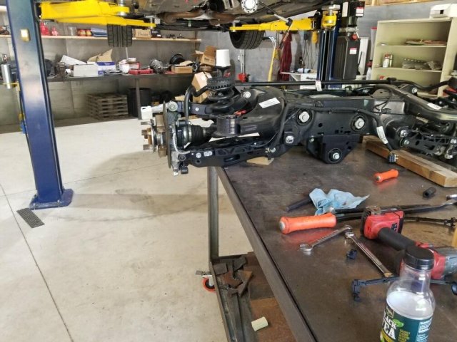

We just finished installing the AAD drag pack kit( https://aadperformance.com/collections/dodge-charger/products/drag-pack), and the BMR cradle lockout on my car. Went over and got it aligned. The guys at aad talked to my alignment shop about setting it up.
Here are some pics:
Before
dropping cradle out of the car
Detail of all components, particularly the 4 cradle mounts, notice the bushings
After-
assembly complete

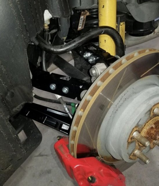

detail photo
Isotators inserted into 2 of the bushings
Wheelwell view

#79
@NJ_Redeye
Those appear to be a shortened rear end link for the sway bar?
When that cradle was reinstalled did you have any interference or contact between the sway and the upper control arm at full travel?
@16GoManGoHC2
Do you have shorter links on your car?
3,654
8,590
#80
@NJ_Redeye
@16GoManGoHC2
Yes, I have shorter sway bar links on my car to clear 17” rims used at the track
