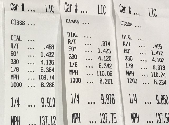

Well you’re going to be the perfect candidate to measure exactly what happens. From sixty ft to trap speed with your proven performance.

The trade off with going to the bigger tire is weight. They are heavier. One could assume that its going to cost you some mph. It will be interesting to actually see the results with a highly documented performance car such as yours. Looking forward to reading all about it.

Speedy..., My first time out with the 3.09 315/50-17 combination and adjustable control arms (Spohn) with alignment. 0473A4B0-3B73-4F53-A48F-146E45511285.jpeg

Speedy..., My first time out with the 3.09 315/50-17 combination and adjustable control arms (Spohn) with alignment. View attachment 19866
