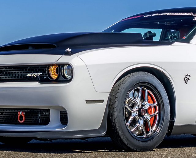

Sorry but the only suggestion about the fronts I can make is go to a frontrunner. The weight savings with the lighter wheel and tire, in addition to the decreased rolling resistance, will show up on your time slip. The M/T Sportsman is even a excellent street tire and is designed for the heavy weight of these cars. I run mine at 40 lbs on the street and go up to 65 lbs for the track. C6046C96-2D73-4D5C-9CCF-4D9FD468B6EB.jpeg

Sorry but the only suggestion about the fronts I can make is go to a frontrunner. The weight savings with the lighter wheel and tire, in addition to the decreased rolling resistance, will show up on your time slip. The M/T Sportsman is even a excellent street tire and is designed for the heavy weight of these cars. I run mine at 40 lbs on the street and go up to 65 lbs for the track. View attachment 19926
That hood looks awesome & the whole car !
I am kinda surprised that you run your front tire psi that low , I was running mine at 80psi.
