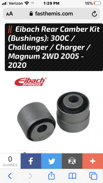

Any one ever think of trying these before changing all these arms and such? Sure a whole lot cheaper and looks a whole lot easier to install ??
