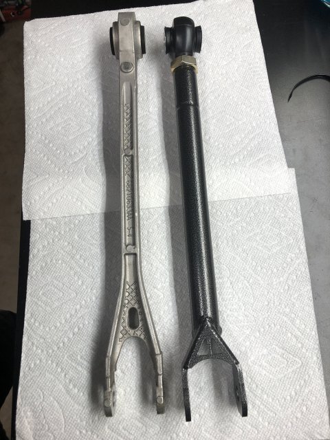

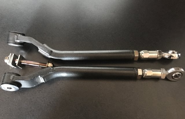

I called BMR on the width issue with the trailing arms, needs a washer on each side then was a perfect fit. I put rubber boots over my rod ends as well but will be removing these links and putting the on car adjustable ones on as they look beefier. 6404417D-FC14-484E-89AB-26DE971EF85D.jpeg 5D9F9EA0-0D5F-44A2-86ED-4A0D0387E9AD.jpeg
3,630
11,710
I called BMR on the width issue with the trailing arms, needs a washer on each side then was a perfect fit. I put rubber boots over my rod ends as well but will be removing these links and putting the on car adjustable ones on as they look beefier. View attachment 16561 View attachment 16562
A picture is worth a thousand words! Look at that weakass cast aluminum trailing arm. They break! Even had one break on the dyno. Not everybody wants to go to a full drag suspension but if you are modding at all..... that along with the DIRS brace, is one of the things that needs to be done.

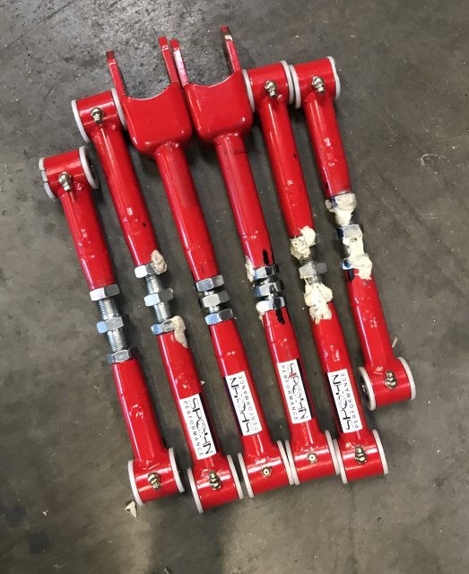

. These are the Spohn adjustables I just pulled out. Chromoly and very stout. No bending those. You can see my “goop” application that keeps the lock nuts in place. Professional all the way 😝. Those are sold to Primetime. I also had a BMR toe link on there and those are going to be for sale. They are the skinny end joint version from Carlyle for a 15” wheel conversion. E91BE137-AA7C-4646-861C-D67828A76E9B.jpeg 2D5C6E8A-C61D-41F3-9E7A-07ADF3B11B6E.jpeg

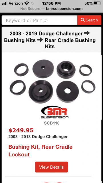

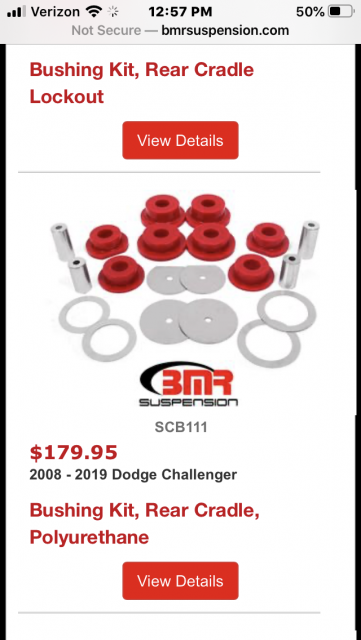

@Hpindy
What cradle lock out kit did you use? Any idea on part number?
3,750
8,901
One of these? 7137E3F4-968A-4A8C-B072-9F5777D9B932.png C883B939-F9A0-40E8-A89F-4C6249CF2E20.png 96B7C766-8F36-4B04-8E71-26698DEC8F3E.png

@Hpindy
I got this one
