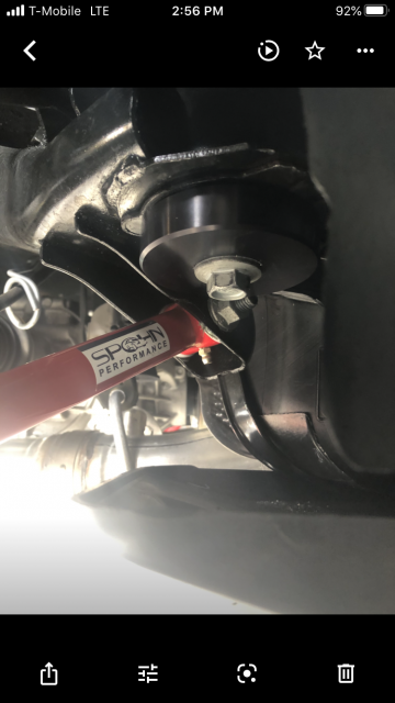

I followed Hp’s instructions for the installation of that BMR Cradle Lock Out Kit and had it done in less than 2.5 hrs. Dropped one side at a time as he instructed. Maybe 2 inches at most. Biggest pita was drilling and hammering off the limiter plates, but with a sharp drill bit, not all that bad. Generic instructions BMR provide are not nexessary for us. No dropping exhaust or filler neck. I don’t know about the center section kit above but am also interested in doing that as well. Pls let us know how that one goes.

I did mine the same way. The limiter plate wasn't as bad as I thought. I drilled in the side then over about 1/4 the way around I drilled up into the plate. Not through but enough to weaken it. Couple of hits on a big screwdriver to get it to start twisting. Then it popped off with little effort using a pry bar. I used single edge razor blades to cut the bumps off the rubber. Then a new one and cut the rest off to the metal.
I was surprised it went so well.

No need to drop the exhaust , filler neck, or anything . Just drill the limiting plate to split it the knock it off . The cut the rubber bumps out of the the way ( I finished with a die grinder and a sand paper roll to get ALL the rubber off and down to the metal ) . Then put a jack under the control arm and both cradle bolts from that side and lower it enough to slip both top rings in . Press them into place with a screw driver or pry bar just to make sure they are fully sewed. Then jack back up into place . Insert factory bolts threw appropriate lower lock out pieces then thread in by hand . Then torque to factory specs . Repeat on the other side . Check torque after 100 miles or so .
