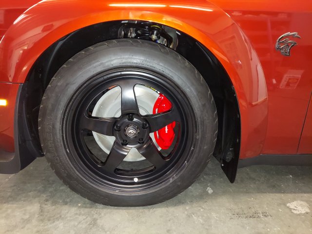

What was the weight difference?
I didn't weigh the SS rotors and calipers. By the time I was ready for those parts I had getting the car back in one piece on my mind.
I did weigh the stock rotors and caliper though. The rotor weighs 33 lbs and the caliper(pads and hardware) weight 11.5 lbs.
I got the last of it buttoned up today and took it for a test drive. It drives fine and I see no reason to think the pre '21 knuckles and the '21 lower arms aren't compatible.
