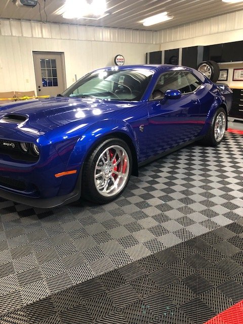

Hi Guy's
Got mine finished up. All I needed was 2020 hellcat rotors that had a 15.2 "diameter and then did a end mill adjustment to the mounting holes on the calipers at the machine shop to set them down .285 lower and had inserts made to go into the slot with the mounting bolts back side that are also .285 to fill the void. You can still go back to the 15.8 rotors by changing the insert back the other way.

Hi Guy's
I looked at a few options along those lines. In the end I decided that since my '21 will be used primarily for drag racing I'd just get the smaller SS setup. We're waiting on one more caliper and all the parts will be in. So, I guess next weekend I'll be spending some time in the fender wells. :giggle:

#60
Yes I do agree with you that is the best way to accomplish this front wheel clearance problem..
