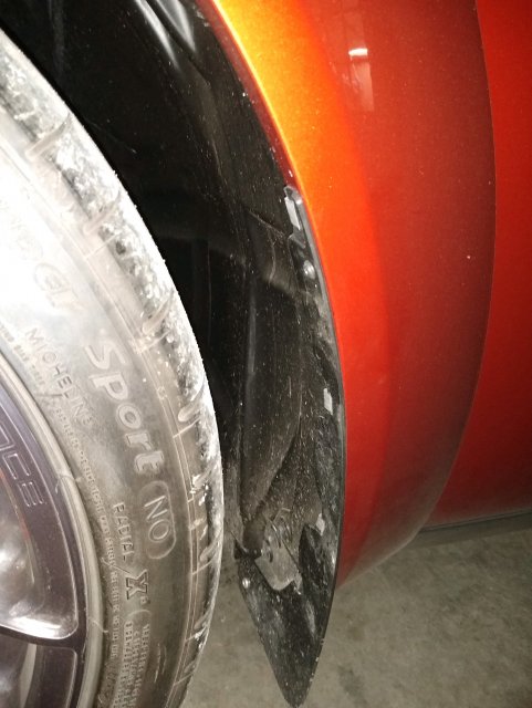

To hit a few things I've already done to the car. I've installed the ZL1Addons mud flaps front and rear. They come with two different size clips and one screw per flap. I chose to use two screws on the red car and I did the same with this one. For regular street use I'd think the clips and one(bottom mounted) screw would be ok. Both of these cars will see dragstrips speeds of over 130 mph somewhat often so the 2nd screw made sense to me.

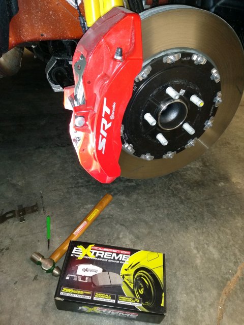

I also went ahead and replaced the brake pads with the Power Stop low dust units. I don't see any real difference between the two functionally, I just won't have to spend near as much time cleaning the wheels and brakes. The car had 31 miles on it when I replaced them, I was surprised at how much brake dust there was in the caliper after that little amount of use.

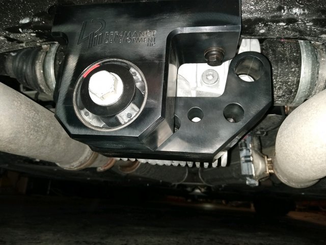

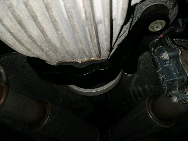

I've also already installed the P4D diff brace. I went ahead and got both the front and rear braces. I'm still not sure I see any real world benefit to the front unit but it's pretty light and it can't hurt to have it there.
As is typical, the rear unit is a really simple install.
The front is only held on by the two front diff bolts but I had to remove the pass side active exhaust servo to get to the pass side diff bolt. Not that big of a thing really, it just takes a minute to understand what you're looking at so you can remove and reinstall it correctly.

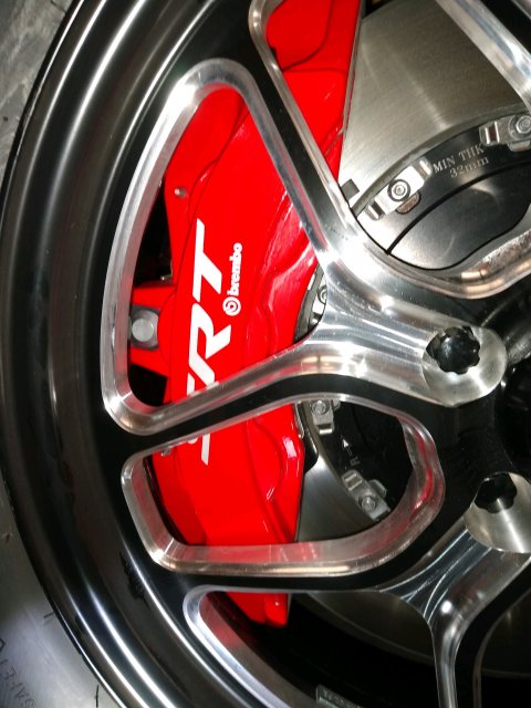

This afternoon I ran into my first real problem with the '21. Our local track will be open for t-n-t this Sunday(weather permitting) so I was planning to mount my street big and littles on it to drive it to the track and make a few passes. I took the right front wheel off and bolted the 18x5 Forgestar on. I put on two lugs and went to roll the wheel just to be sure it wasn't hitting anything. It wouldn't budge. Turns out the inner part of the wheel comes in contact with the slightly larger '21 front brakes.
I'll be pulling the Billet Specialties off of the '19 tomorrow to see if it will fit. If it doesn't fit I'm not sure what I'll do next.
2/6/21 - UPDATE: Nothing fits.

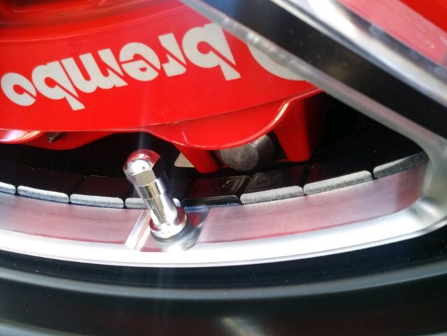

I have both the Forgestar as well as the Billet Specialties in 18x5. Neither works with the stock '21 brakes. I also have some 3mm spacers. Spacing either wheel out by either 3mm or 6mm changes nothing. They just flat attack the brakes regardless.
I'll be looking at my options in the coming days. First thought is to look for a wheel that will work. I already went through that w the '19 though so I doubt I'll be able to find anything that'll fit a lightweight tire and clear these brakes. Next option may be to install basically the Demon brakes. That's probably my simplest route, plus it knocks some weight off a really good spot as well.

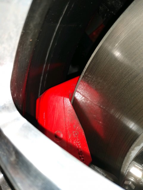

Here's a few pics just for illustration's sake..
The chips are where the Forgestar hits:
The Billet Specialty is a better fit but still hits enough not to work. The entire barrel of this wheel is what touches. In the one pic you can see a witness mark where I turned the wheel a bit to make a slight mark on the wheel. That's with the lug nuts loose and just holding the wheel to the hub by hand. With the lug nuts snugged it won't turn at all. Spacers do nothing to change this.

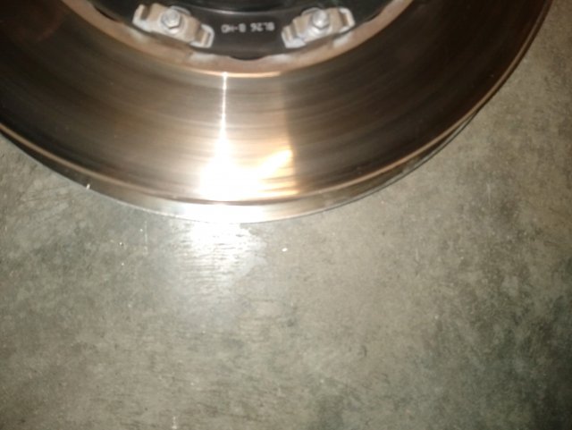

2/7/21 UPDATE:
Here's what I know so far:
1 - The rotors as well as the hats are completely different parts that just happen to look a lot alike. The hat is ~1/2" bigger dia on the '21 as well as the rotor.

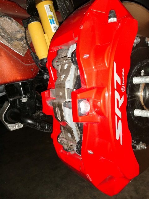

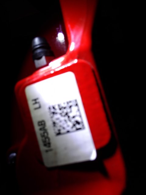

2 - The calipers measure similarly in a lot of places but carry two different part #'s.
I'm not 100% sure they are different in any functional way though. Further measuring and just general digging is required on this part.
'19 caliper pn
'21 caliper pn

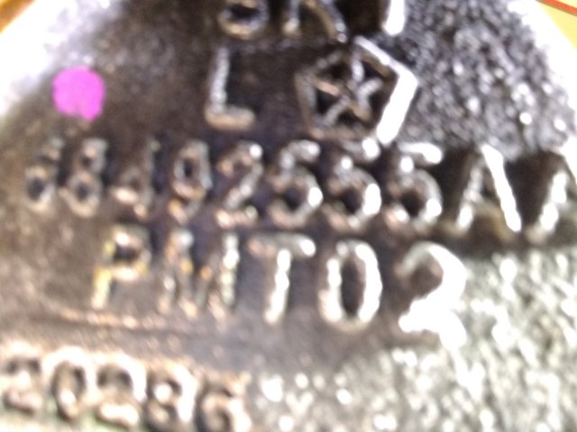

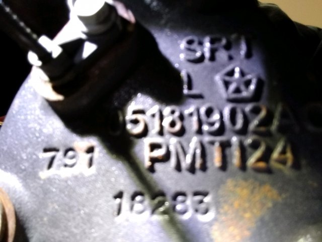

3 - The spindle/caliper mount(the cast thing that the ball joints and tie rod ends attach to) carries a different part number. This one worries me the most. If it's different then I'm looking at having to replace those as well as install smaller brakes to get the 18" wheels on this car.
'19 spindle mount pn
'21 spindle mount pn
I'll do more measuring to see if I can possibly just change out rotors/hats and the spindle/caliper mounts and keep the stock calipers.

Yes the 21's are the first year that got the larger brakes in front. At this point I do not think any of the Skinnies will bolt right on any more.
If the contact is here then I think the Win Lites might work (without my balance weights). Because .3" in diameter is only .150 in radius. I am guessing on the .3".
TNREDEYE
TNREDEYE
#1211
940
2,267
Shelbyville
2021 Super Stock
Thread Starter #14
. View attachment 37089
The two high spots just out past the outer pad pins is where mine hit. At least that's where it knocked the paint off of the caliper. After working today I really wasn't in the mood to do much investigating this evening. I'll look into it good tomorrow and know more after that.
