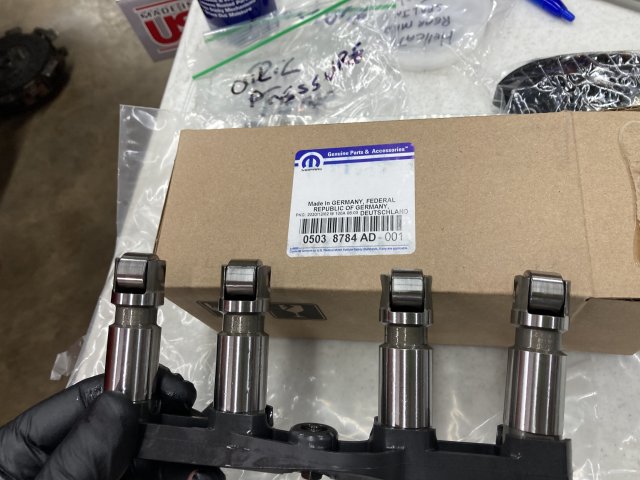

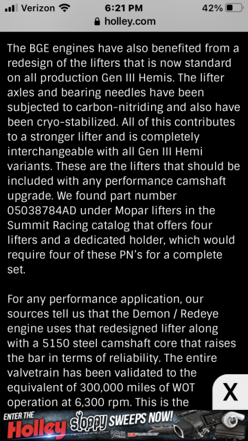

Thread Starter #222
Add new Demon/RE spec roller lifters, the latest version supposedly has cryo treated rollers and needle bearings.

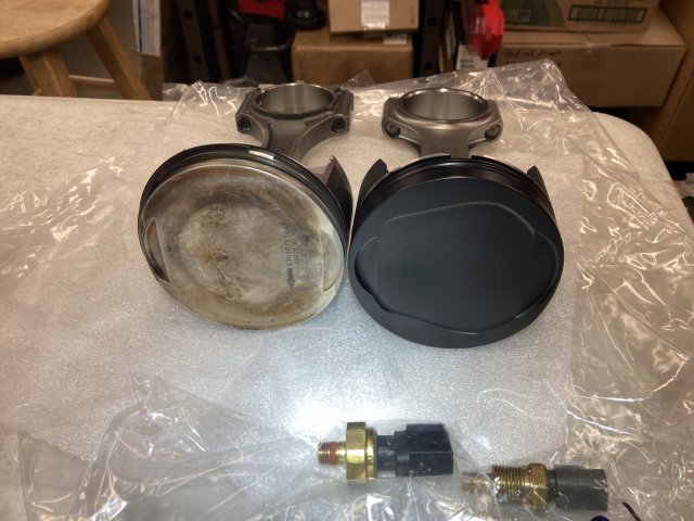

Thread Starter #223

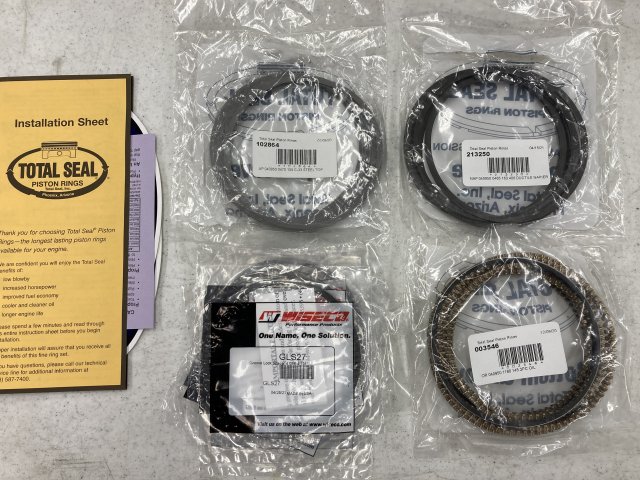

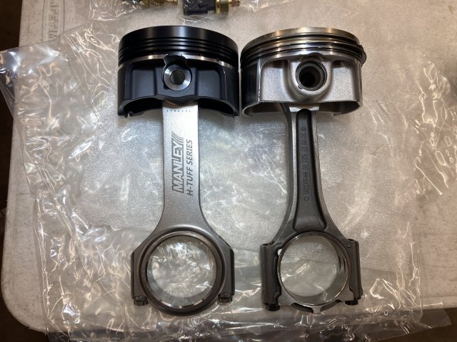

Start thinking about sizing rings. Here’s the new WISECO custom piston mated with a Trend H13 .250 wall DLC pin to a Manley H-Tuff 4130 rod compared to a stock piston and rod combo. B0406255-5AA3-42C0-91C3-A5DAEA7AC61F.jpeg 0E3A34DE-3A55-485E-8C44-34139F00B120.jpeg D92C712F-AD39-4881-934E-6247DF338D15.jpeg

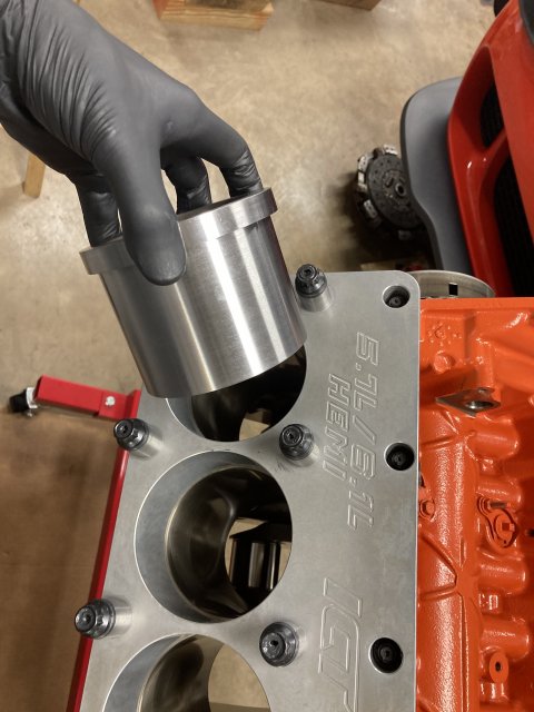

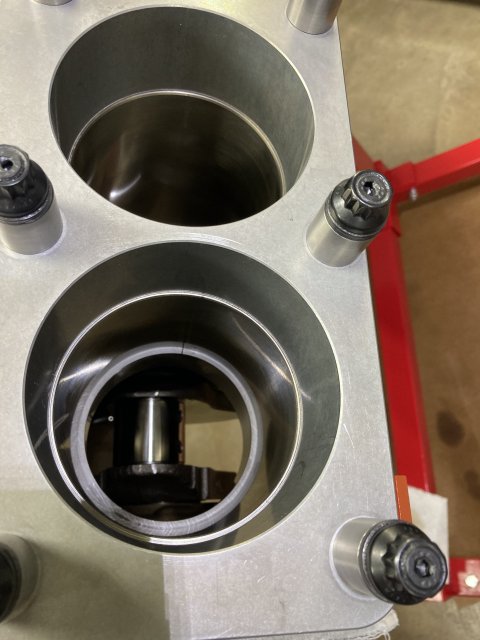

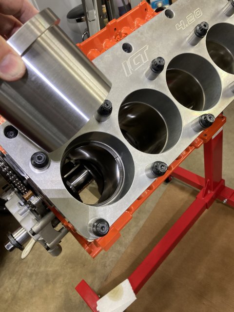

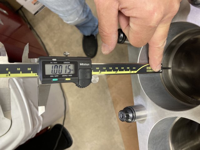

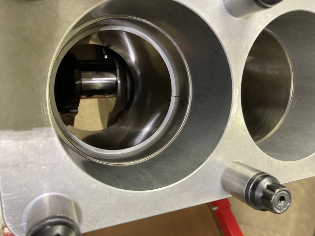

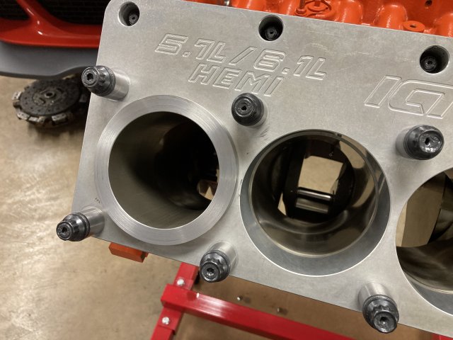

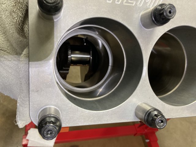

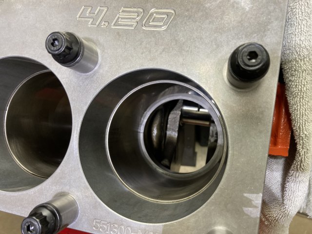

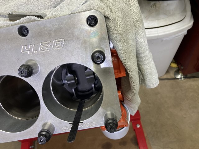

Thread Starter #224

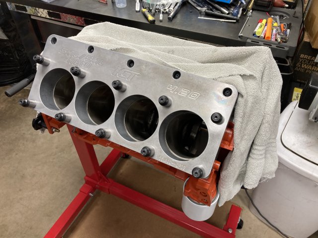

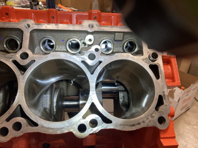

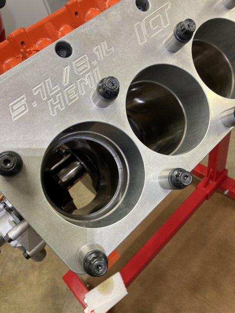

Add Torque Plate, THANKS @Hpindy so rings can be sized in bores just as they where when torque plate plateau honed to 4.0925 bore. Made a custom ring squaring tool so with tq plate installed the rings can be perfectly squared in the bores 1”down from the deck as Total Seal wants for them to be sized to .028” gap on both top and second rings. E380BFA7-F44D-4DCD-A971-26F7D0458AE0.jpeg B9C0C278-CA1A-4546-BFE7-50B7E49B52E1.jpeg 0D92A147-A464-4B09-B8AB-13A3001615E6.jpeg D8F8643A-A09D-4233-8CF7-C5AE50C84CB0.jpeg

Thread Starter #225
Modify ring filter to accept a drill

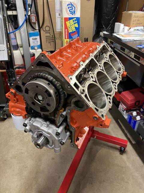

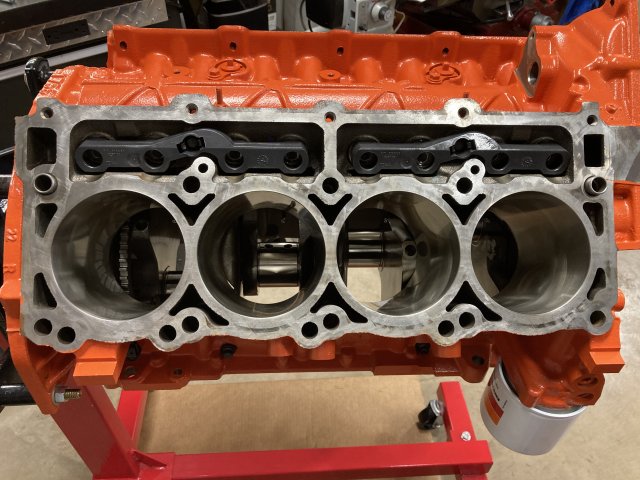

Thread Starter #226

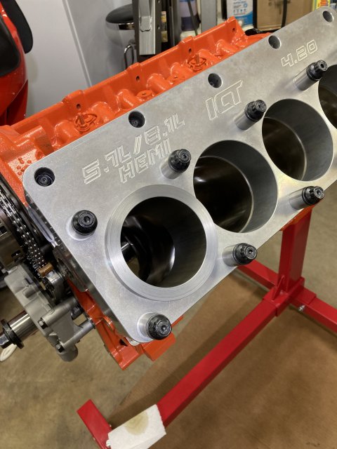

Been a long day, time for block to get some rest and hopefully start sizing rings in the morning. There’s 5 per cylinder (top, second, oil ring top and bottom, oil ring groove support ring) to do, 40 total so this process is going to take a while.
777A1B75-179C-4D9A-94F3-F4BAA70E5422.jpeg 30D78251-C94A-4CCE-B7A6-C040C333D8D6.jpeg
Stay tuned for part 2 LOL!!

Add Torque Plate, THANKS @Hpindy so rings can be sized in bores just as they where when torque plate plateau honed to 4.0925 bore. Made a custom ring squaring tool so with tq plate installed the rings can be perfectly squared in the bores 1”down from the deck as Total Seal wants for them to be sized to .028” gap on both top and second rings. View attachment 45562 View attachment 45563 View attachment 45564 View attachment 45565

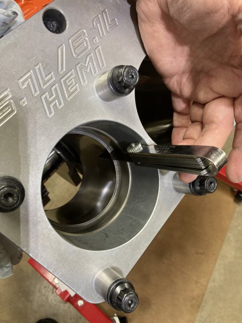

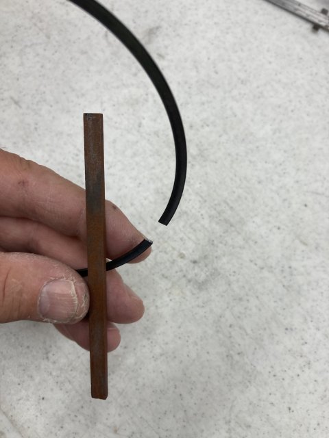

Thread Starter #229

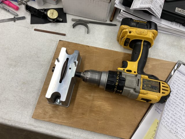

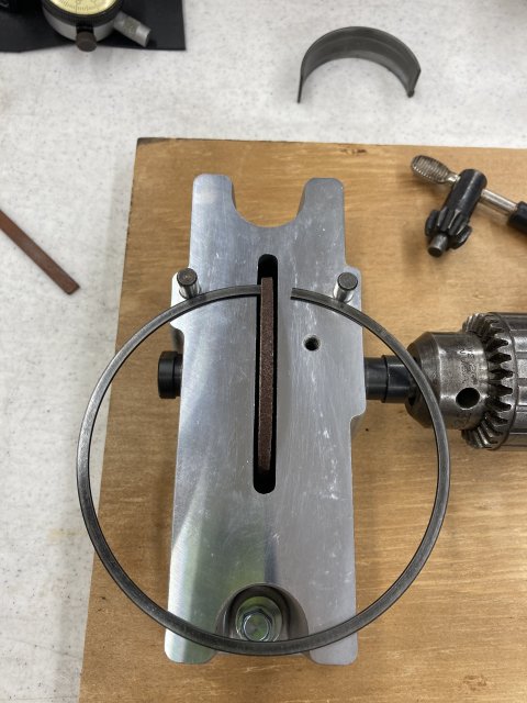

First thing to do, make this cheapo ring filer easier to use!! This makes hands free control GREAT and controllable!! Tested on a old ring first, works GREAT!!

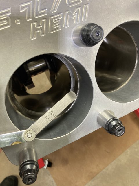

Thread Starter #230
SWEET!! .028” first shot!! Now if only the rest go this easy!!! 🤞🙏
Grind only one side and Be sure to stone burrs off the filed end AF9C1C4F-8959-43F5-A744-13A8E01CD7E8.jpeg 0BA3C46A-2256-401C-ABF0-80707487721B.jpeg 8E10DE29-D7D5-41A7-94BF-34B6F6A27279.jpeg 84EBBF0C-D6AE-4B8F-9D08-6774F2DC0CB1.jpeg C5E5D5A9-DE30-40E8-9DD1-3641C73DFC43.jpeg 77E4D72A-DF15-4993-A91B-ADEDA0A6EED1.jpeg FF281883-B56E-4564-BF75-D284D90A949C.jpeg ED5CDB34-6939-4DB8-A8AD-A6346628F2BA.jpeg 4D28FFA2-F826-4391-A304-0930BBC346BE.jpeg

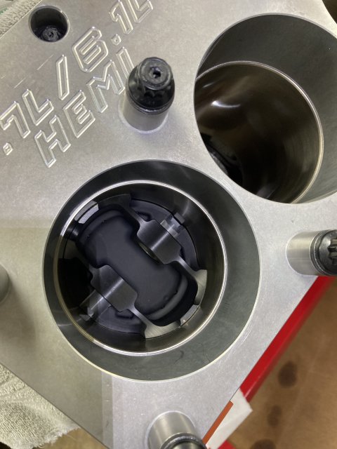

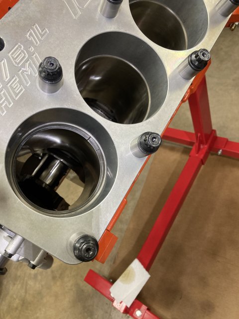

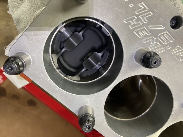

Thread Starter #235

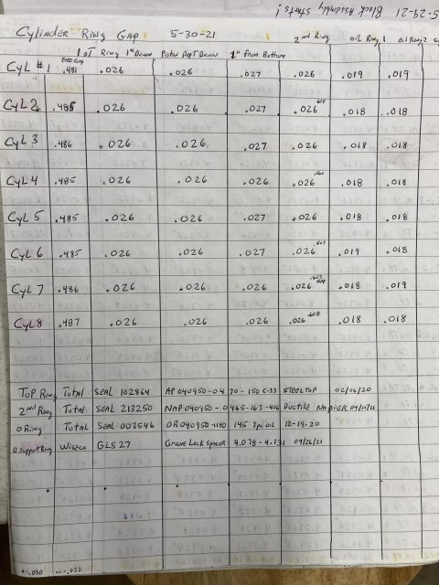

Ok, all the rings are gapped, target was .026” on top and second ring, .018” on the oil rings. I pushed the top ring down to mid cylinder and bottom cylinder and was elated to find gap didn’t change on most and the ones that did was less then a .001” on gap which means less then .0003” on bore which is just what dozens of measurements with a bore gauge told me it was. Torque Plate honing is worth the pain. A16785B9-17C3-4B5B-A7B4-734BEB7639AD.jpeg 04F51493-EA60-4FBC-AD01-591D01FEC0E8.jpeg 6D2F69FF-F479-401A-8B88-F0610AA35E5F.jpeg 67E3A5DD-75C0-4C97-8B08-E381C17705AA.jpeg 3CC53ABA-A6F4-4533-B0D5-75E038C4D9E4.jpeg 877776FE-9B5D-4DB4-9C76-114196E17F10.jpeg B392E074-4F31-4C1F-8AF8-3BF076420F85.jpeg 911BF4FC-D12E-4731-BF88-7C7B3767B7E1.jpeg 4F8A8E92-9F6C-4A19-90DE-5505994631A4.jpeg CCE1D5FF-E6ED-4E28-827F-67B41360D5E9.jpeg

Thread Starter #236
Here’s the numbers, the foot pedal variable speed control of the cheapo ring filer made it work like a pro model!! 55DCD0C4-7196-451A-9685-109A0FDE51B2.jpeg [

Ok, all the rings are gapped, target was .026” on top and second ring, .018” on the oil rings. I pushed the top ring down to mid cylinder and bottom cylinder and was elated to find gap didn’t change on most and the ones that did was less then a .001” on gap which means less then .0003” on bore which is just what dozens of measurements with a bore gauge told me it was. Torque Plate honing is worth the pain. View attachment 45740 View attachment 45741 View attachment 45742 View attachment 45743 View attachment 45744 View attachment 45745 View attachment 45746 View attachment 45747 View attachment 45748 View attachment 45749
Why not use gapless rings? I don't stay up with all the latest stuff on engine building but that was something I did 20 years ago on my blower build
3,758
8,916
Thread Starter #239
I thought about using them, actually was going to but Keith at Total Seal didn’t recommend them for my application, (yea, I couldn’t believe that?? Even called 3-4 times over the months and got the same recommendation from him- use gas ported rings) he recommended Gas Ported Rings over them for some reason which mainly was about wanting some ring lubrication from tiny vacuum a gap provides to pull oil to in between the rings. He also mentioned Something about the volume of the area below the pistons and crank is very small in these engines. Ring lubrication is why in the hone spec the Rvk value was high at around 50 to trap oil in the valley’s left by those deep “scratches” per say. After talking to about 2 dozen pro’s about the pro’s and con’s of each ring kind I just went with tried and true everybody agreed can’t go wrong with a high quality Total Seal AP normal ring set. It wasn’t about gapping them, You still have to gap gapless rings, in fact there’s 2 per ring you have to gap!!
7,473
19,638
So .026 on new rings what were the stock gap? .022?
