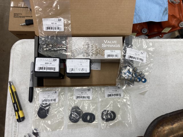

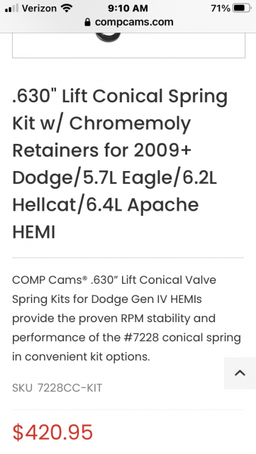

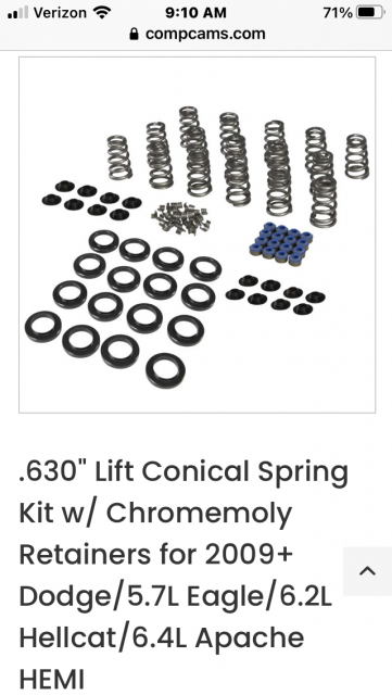

They are parts included in the Comp Cams .630 lift Spring And Chromoly Retainer upgrade kit. That kit along with the Stanky Motorsports rocker stand tie bar kit should give me a stable valve train to 7000 RPM’s and safe reving to at least 7300 RPM.

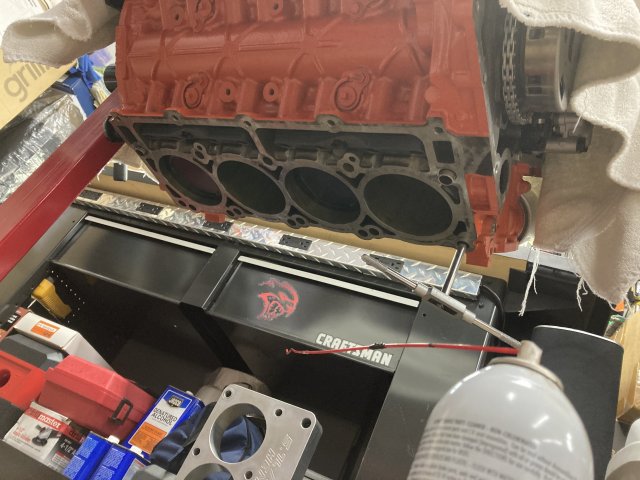

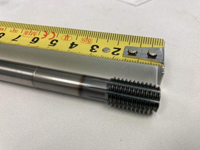

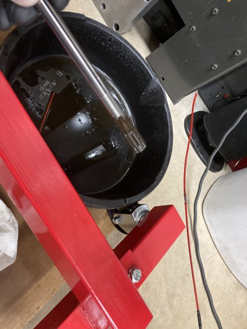

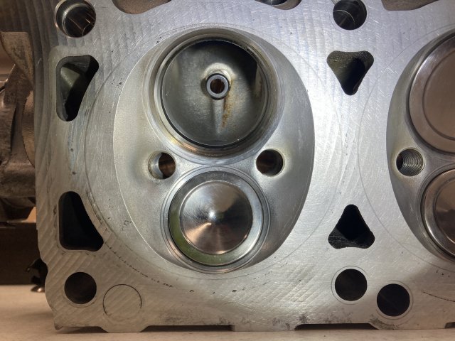

Ok, so here’s what’s been going on this last week, prepping for head installation. Started with getting a thread forming tap, not a thread cutting tap which would take material out of the threaded holes a thread forming tap reforms any damaged areas and does a great job at getting all the gunk out of the threads. Rotated block so holes faced down, lubed with WD40, rand tap to bottom of each hole and cleaned them out with brake cleaner followed by another flush with WD40. You’d be amazed at the crap left in them from the honing process.

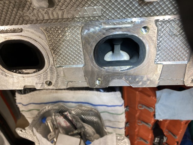

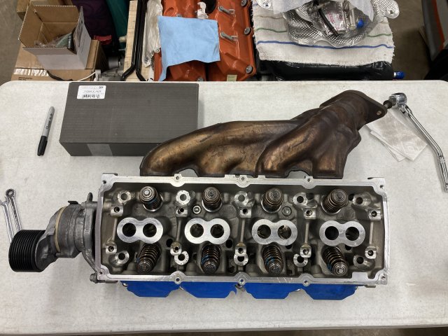

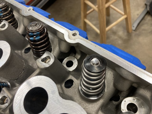

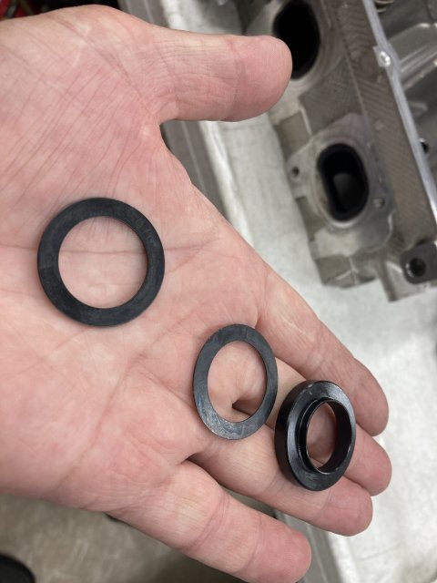

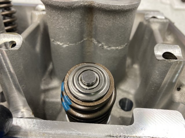

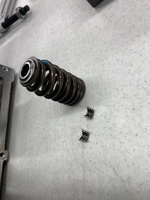

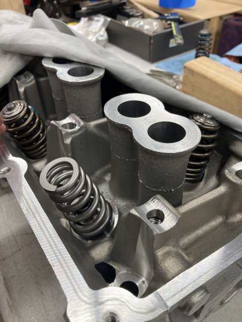

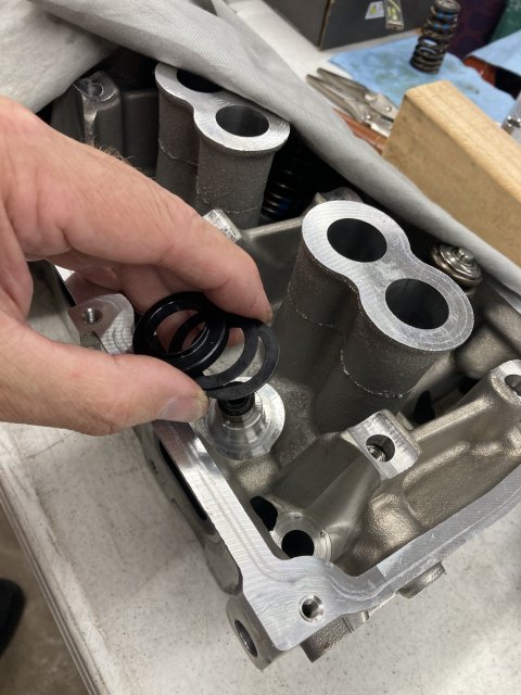

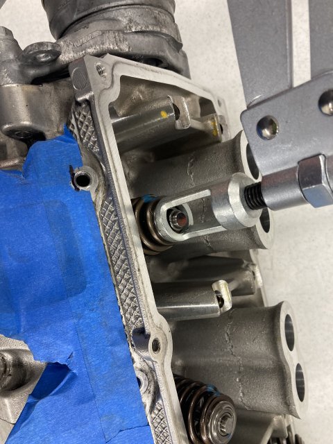

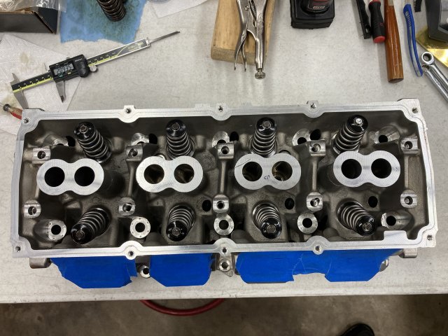

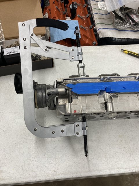

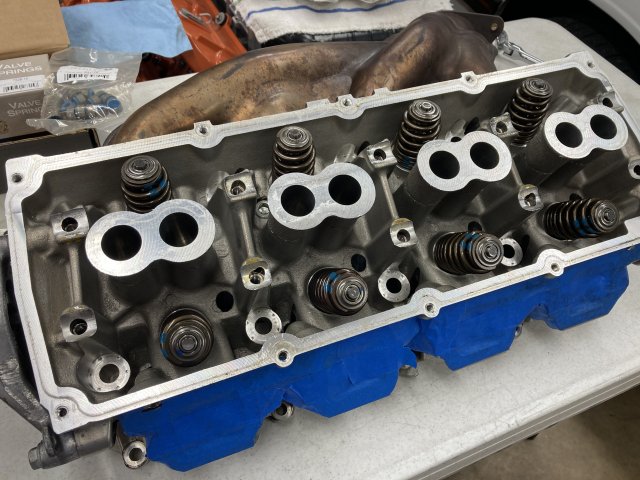

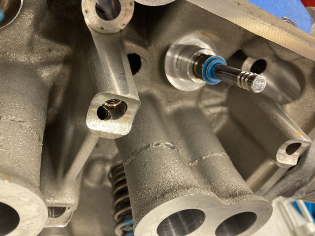

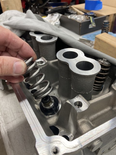

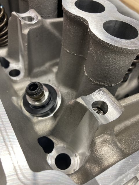

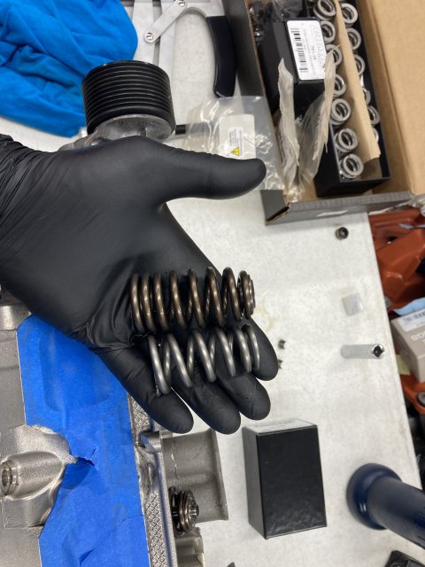

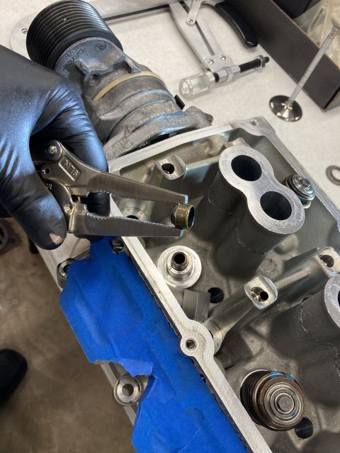

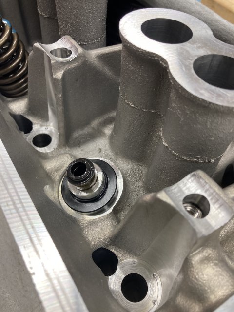

Now that that’s done and I cleaned a work area off onto prepping the heads. It was highly suggested by @Hpindy to replace the valve stem seals while the heads are off so if taking the valve retainers, locks, springs etc off to do such I mine as well install new better parts in the process. So I ordered a Comp Cams .630 lift spring kit and here we go. Change the intake side first.

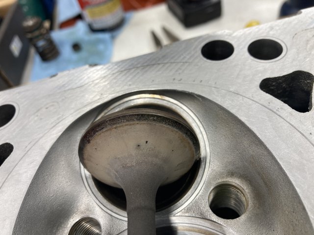

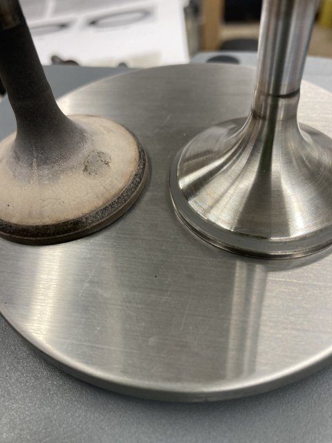

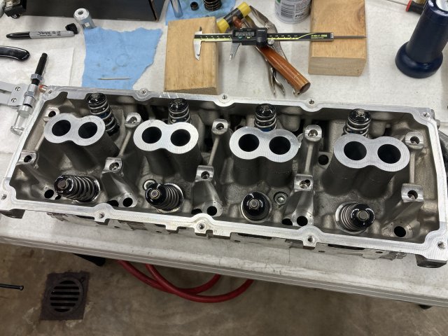

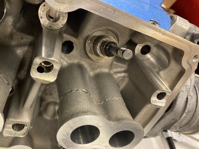

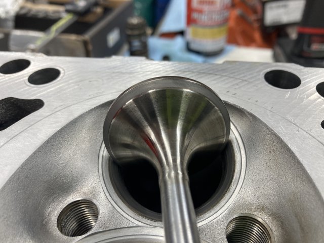

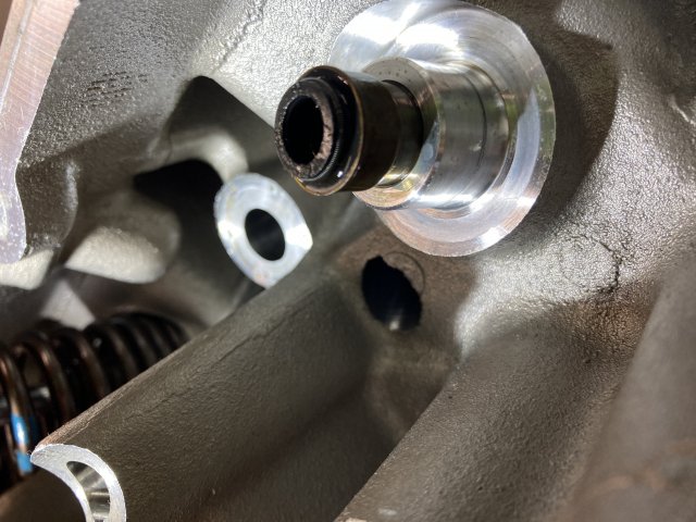

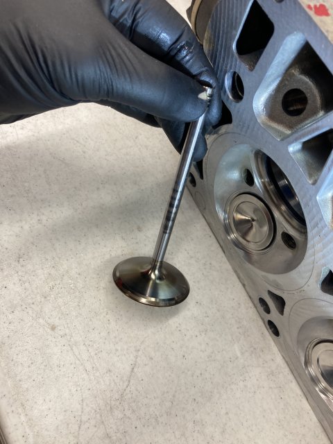

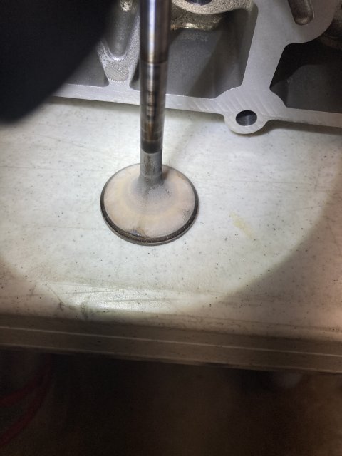

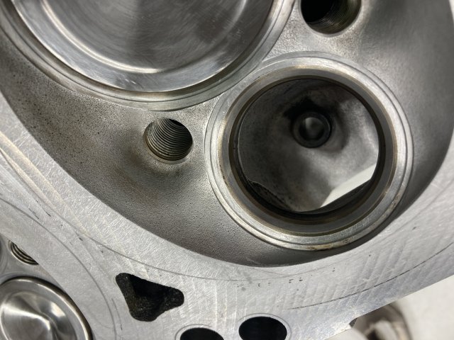

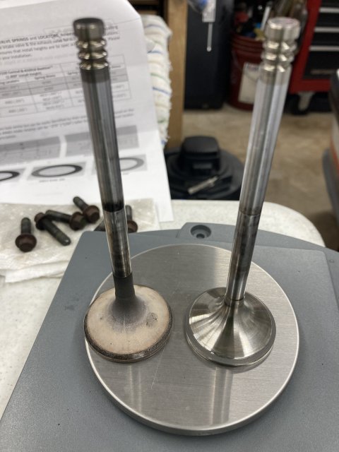

Now on to the exhaust side, and more MMT crap to clean up :( Exhaust valves coated with it pretty heavily, worst part is it smashed into the seal seat areas which required a light lapping to remove after swirl polishing the crud off the valve tops and stems. Clean the pockets and guides with Solvent, oil the stems with motor oil and reinstall all nice and shinny and clean.

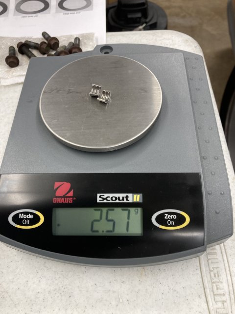

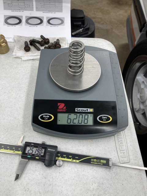

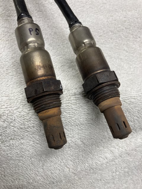

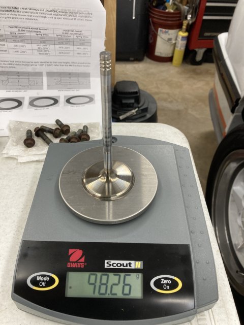

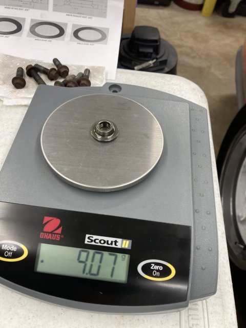

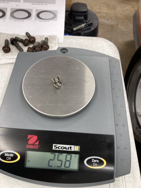

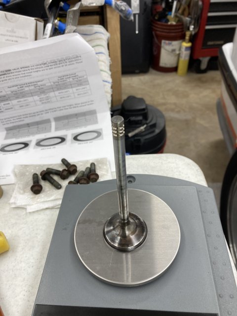

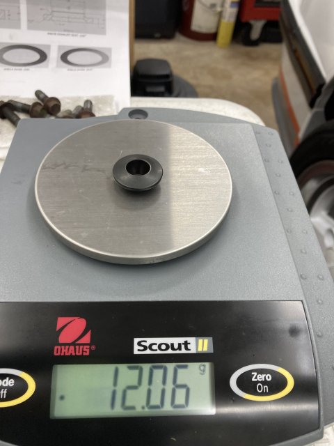

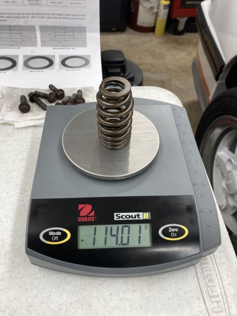

Words to note. I was amazed the exhaust valves where almost as heavy as the larger intake valves. New springs where about 1/2 the weight of original springs but new retainers were 3 grams heavier. I removed the upstream O2 sensors and was shocked at how much MMT was built up on the upstream side, I could only imagine what the inside of the sensor must look like so today I ordered 2 new ones.

Head #2 complete, next step install spark plugs indexed toward intake valve, easy to do with head off so mine as well install them now.

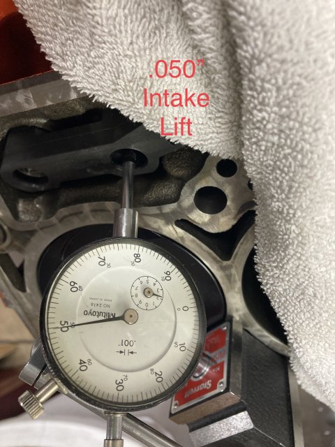

Then it’s triple check cam timing by putting a dial indicator on #1 intake and lifter and see where valve starts to open. If all good Then clean the decks and heads one more time, put gaskets on, heads on, put ARP studs in and Tq to 115 ft lbs in 3 steps. Getting close to engine going back in the bay finally.

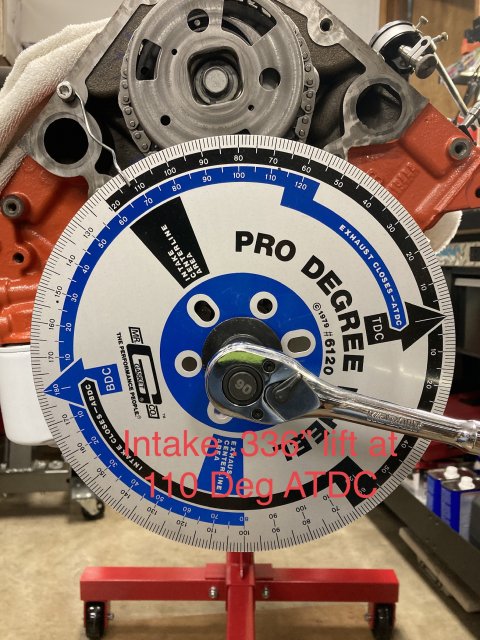

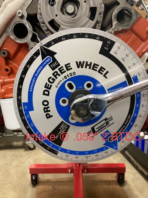

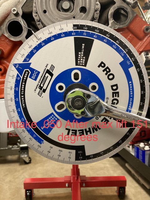

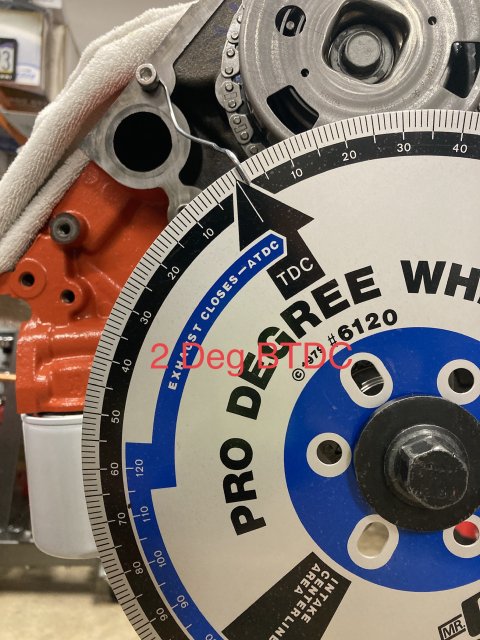

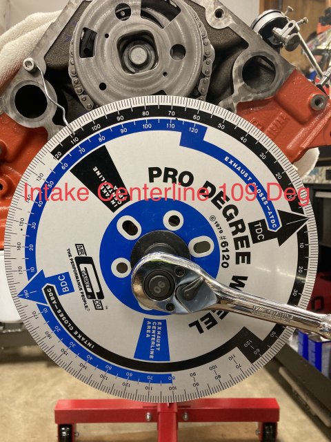

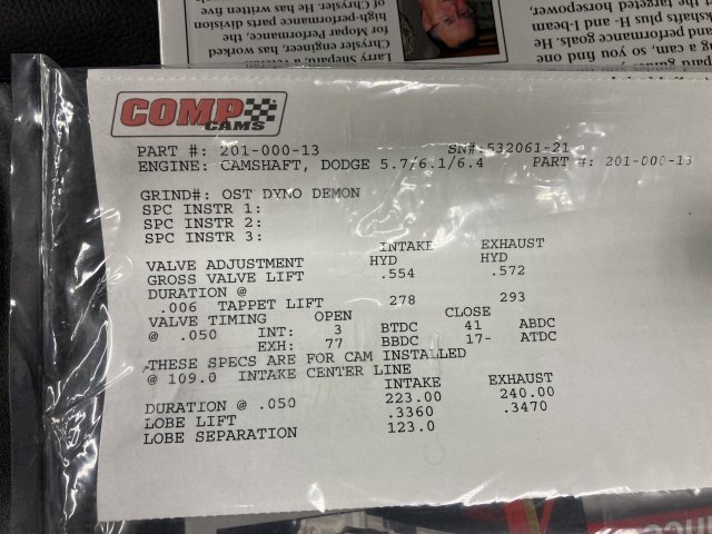

Ok, had a detour back to the block. After all this meticulous work on the short block and now the heads, all the time spent cleaning everything up to like new a thought that kept me up at night was those beautiful pistons with exact to the thousandth rings and exacting bearing clearances crashing into the hours spent on valves and heads on start up so I had to degree check the cam installation. Been a long time since doing this and this HUGE 123 degree lobe separation and VVT grind made valve events not look right in relation to piston travel location verse valve timing events but it ended up matching the cam card within a few thousandths and a 1/2 a degree which could be instrumentation alignment errors. Ready for the heads now and peaceful sleep!! B1B45E5D-48E9-4E3C-A728-8AF9C4D3999C.jpeg 146D22F3-5A91-462B-A442-FE3A9129D64E.jpeg BB2CE455-F782-4962-B976-C89E01B17591.jpeg 0FCE0E23-1B08-4810-9DDD-4BA6A35D8832.jpeg 4ACDEB69-872C-4DE2-A43F-CC87899724CF.jpeg A105C4F3-68DB-4111-AA8B-79E7CEC73A37.jpeg C5F28291-B183-4EE2-B81F-CBCDAB1CACD7.jpeg 59B2E4B2-08A0-4BF7-B692-5DAAFB588B22.png 39813F30-1FC4-43C5-818C-8F3EC748DB6D.jpeg

You forgot to port the heads when they were off;)
Thought about doing such, could have had it done deeply discounted through a friend but the Demon cam lift doesn’t warrant it so I didn’t do it. Some spray someday under the blower jetted right at the intake valves will cover that up :)

Holy crap, that's over my head right there. How's that cam compare to stock? Can't wait to hear about the tuning on that and some sound clips!
