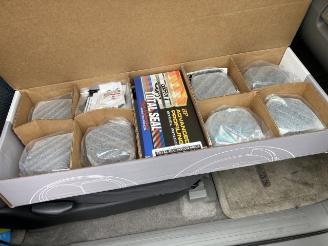

Well Santa finally arrived!!
588AB692-6BC3-4FC0-A840-AD653F2E049A.jpeg 2F93194B-65BF-4C47-A3B1-1CD0A50288A7.jpeg 4C3E8015-F383-470F-82D3-30F064E111AD.jpeg EEA9FE62-00B6-46E5-BCE8-862D3A25E90A.jpeg 2D810FE1-4941-4071-A30F-9E37A4BE1582.jpeg 9347736F-3149-4628-8C90-8681181AE9CB.jpeg CCD27E73-CBC9-4FE0-A467-D791B860A5D4.jpeg BD330B03-4C64-41F6-A51E-2D860C49F261.jpeg DAA2B95C-3442-4DF6-9BA5-695E43287AC9.png 930EEDD5-3B8F-4A32-8F1C-E070CE256581.jpeg BD060ED6-C25B-4C9A-BB1C-FF2745A6C7DA.jpeg

outstanding parts selections!

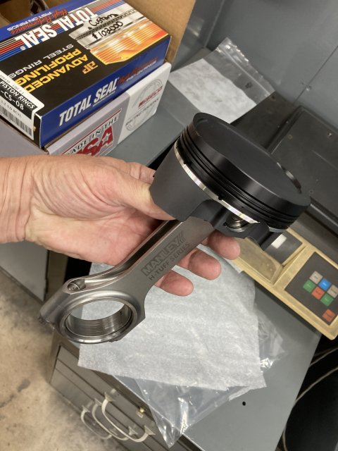

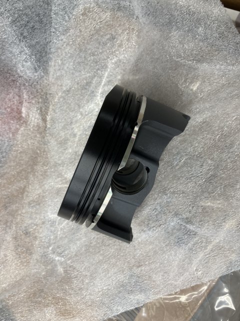

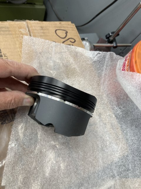

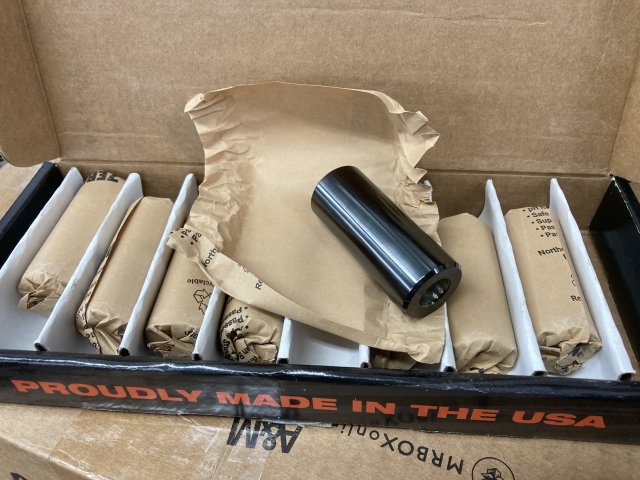

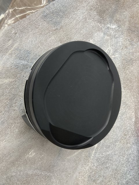

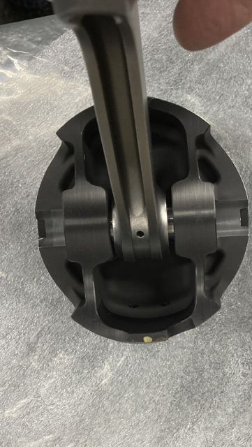

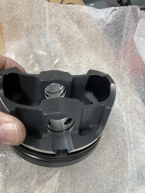

THANK YOU!! Piston is totally custom design but WISECO may make it a future offering. (THANKS @Hpindy for some guidance and suggestion in this area) The quench area matches the head chamber area which should help with detonation, the hard anodize on the upper half is supposedly over 70Rc which is harder then the rings so the ring lands should not get pounded out for a long long time, the hard coated crown should shed carbon buildup and resist detonation as well and be pretty immune from being eroded away from detonation up to a point, the lower portion is a anodize PTFE mix which also penetrates into the wrists pin bore material as well for longevity in that area as well, perfect match to the DLC H13 .250 wall PINS, sealed with Total Seal AP rings with some special coatings to prevent micro welding and wear, Manley H Tuff rods. The whole assembly only weighs 49 grams more then stock but is rated rated for 200 HP per hole the rod being the weakest part, piston is good for 250 they told me. Way more then I’ll ever ask for it on a stock crank and block. Crank and rods will be spinning on King XPC pMax Black coated bearings with the latest updates in design, their just shipping from Israel now. Longevity and reliability of power being the main focus of this rebuild. Parts delivery has taken a long time but will be worth the wait in the end is my hope. 🤞🙏

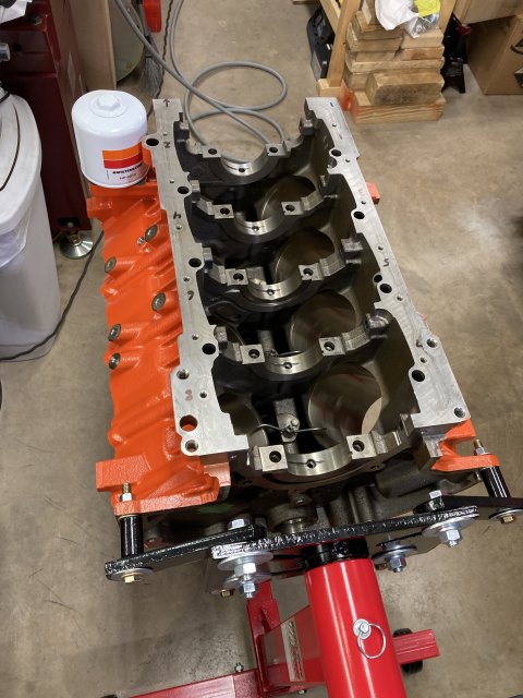

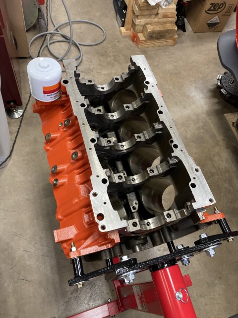

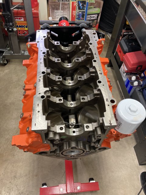

Ok, here we go finally!!! Continuing this saga mainly for those that have been watching this for months now, not doing a separate build thread.

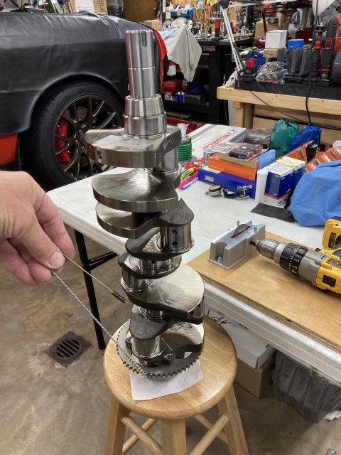

So bright and early this morning the day started off with a thorough final cleaning of the just returned from balancing, magnaflux to check for cracks, and Micro Polish of all the journals. Hosed it down with brake clean and scrubbed the oil passages with first a 7/32” brass brush then a nylon one to make sure no brass bristles remained, blow out with shop air, hose down with WD40 and the nylon brush again then yet another blow down so no lint no nothing remain. Ditto for the block with WD40 and now assembly can finally start!! YAAAAAAYYYYY !!

Thread Starter #215

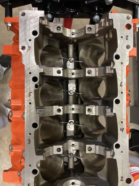

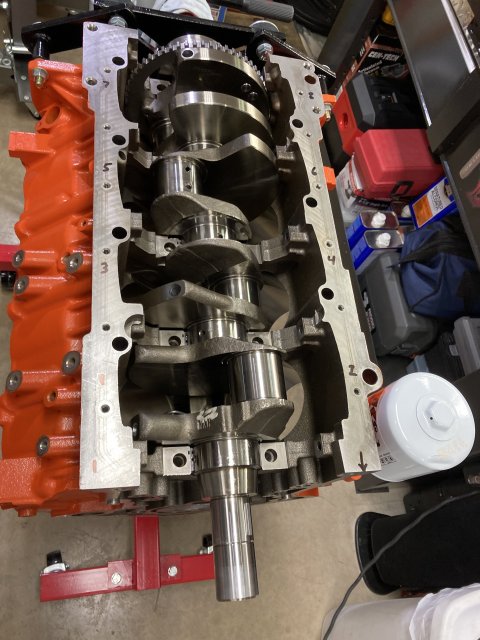

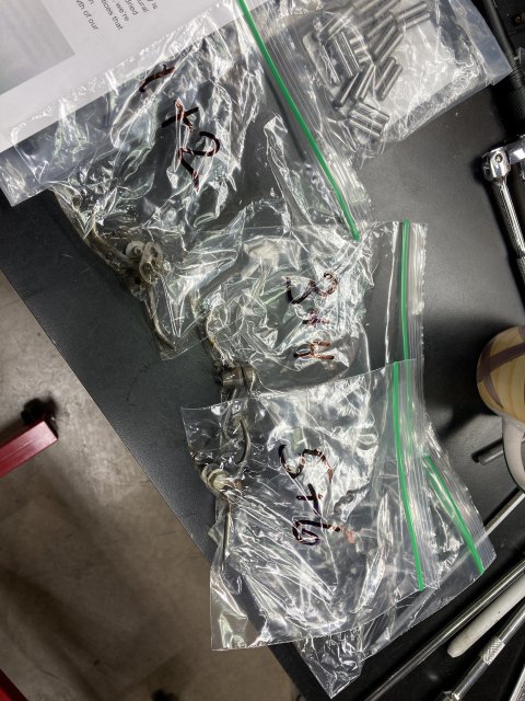

After thoroughly blowing out the oil galleries install the oil squirters. They where bagged and will go back in the same places they came from. 36893B6C-7B91-46E9-81D7-0A0C3E77A532.jpeg 12A1A1A8-B7AB-4125-BD2E-F7F4353DB465.jpeg 78A8C8E5-6F65-4FA9-9E83-0079C7440898.jpeg 0AF623F4-00E0-4C76-BC95-960B0C64F965.jpeg

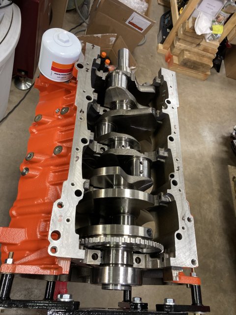

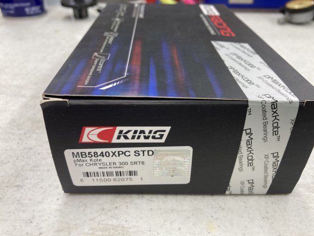

Thread Starter #216

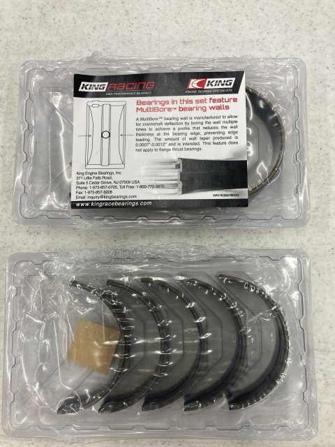

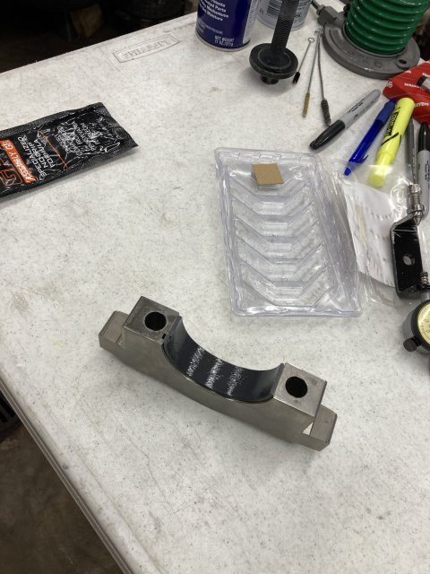

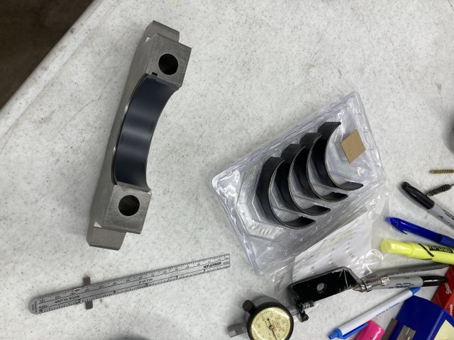

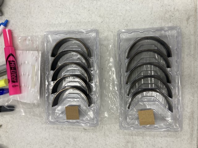

Now onto Main Bearings. Using King pMax Black coated bearings. Clearance on all 5 journals .0013”. 4593A0DF-15D1-491E-907A-F0A741D8BF33.jpeg 49DE21B4-AA75-402C-9A94-ECA7D8E89585.jpeg 9C370352-6980-4C36-B175-64705F6DE6C5.jpeg ECF7E607-9B89-4562-9820-2170973F36B6.jpeg 360FD2AC-8D24-4333-812C-8084E8C7A93C.jpeg

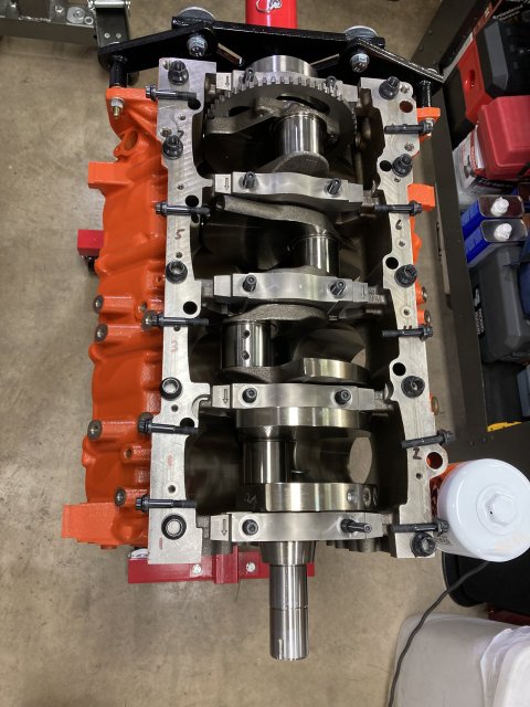

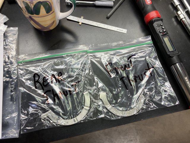

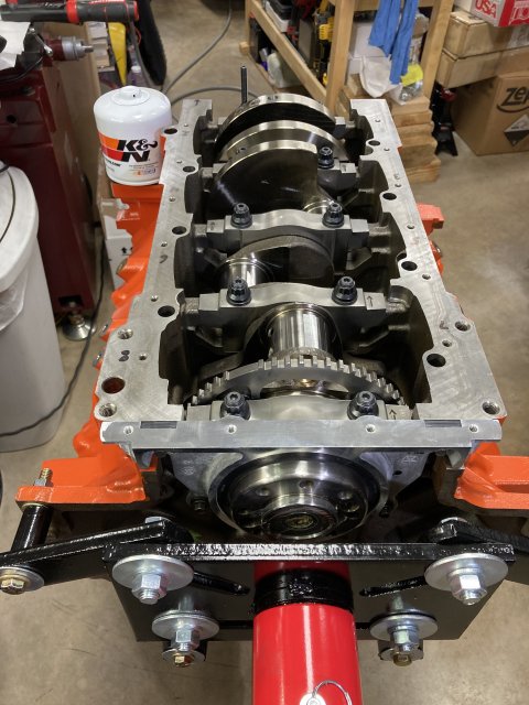

Thread Starter #217
Using Driven BR40 break in oil and their Assembly gel, very light coat on all journals and bearings. Install thrust bearings, add caps and Tq the ARP studs in 3 steps to 100 ft lbs. D3010F1F-982A-4323-A50B-B91379CE0DC2.jpeg 5EEB85A3-4E6B-4571-8E6B-4DF56D4C8C89.jpeg 199FE6D6-5217-4EA8-BE6E-59FBCFAA860B.jpeg 37DEFE80-93D0-4629-A2D1-606BB8AC365B.jpeg D2900C85-3C45-4A11-B4C5-CCAF9BD2BF05.jpeg 9801A591-1DF4-44B8-A79D-02E7D3A39B10.jpeg 16346863-BCD5-4242-A1C8-4BAE0E7769E2.jpeg 6FDA412F-628E-4343-A43D-0349C6205FB5.jpeg

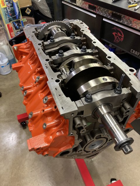

Thread Starter #218
Crank spins nice and free even with the thick gel on the bearings.

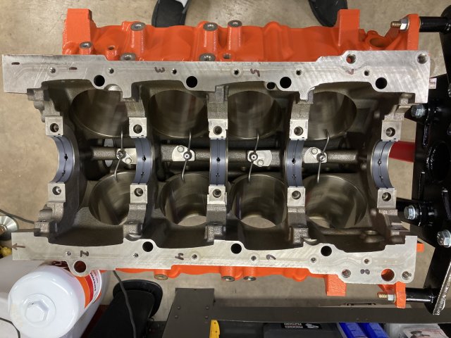

Thread Starter #219
C8870A4C-EB57-46F8-8B21-7D6604132BF3.jpeg Add new rear main seal
Here’s the steps done so far 205A76CB-A494-4254-912D-0DC48315AEDF.jpeg 47B66AF2-4922-4CF1-BE1A-B1C38C24AB31.jpeg 75C09DA3-059F-4F43-89BF-133963C56436.jpeg

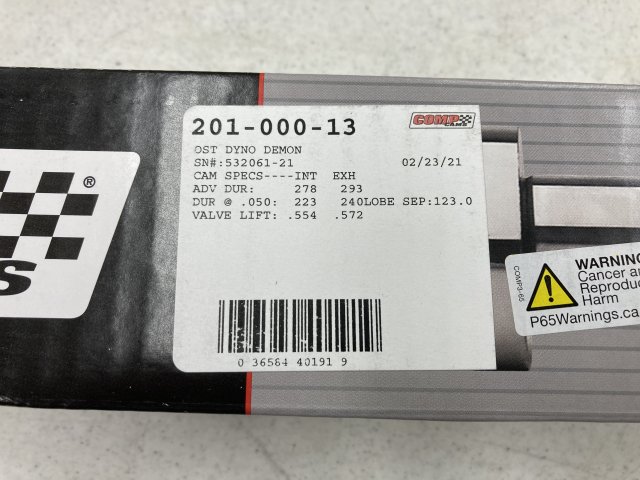

Thread Starter #220

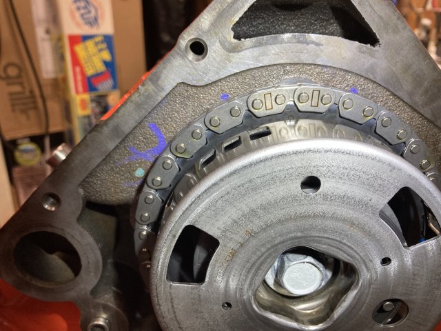

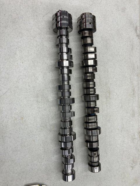

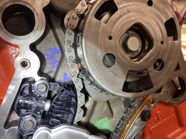

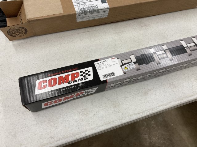

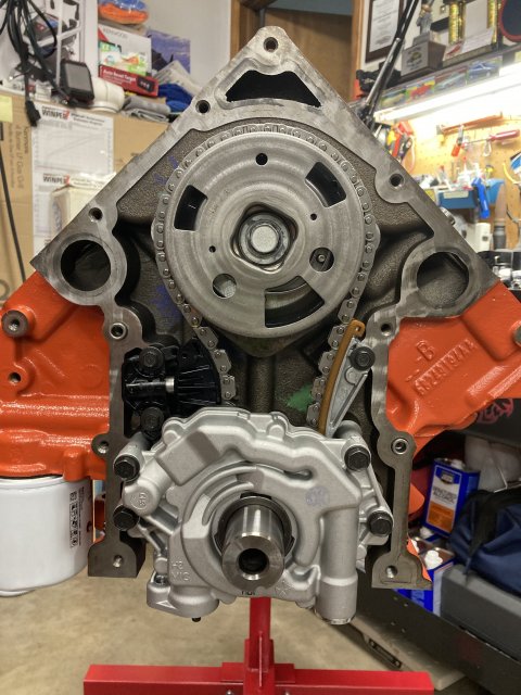

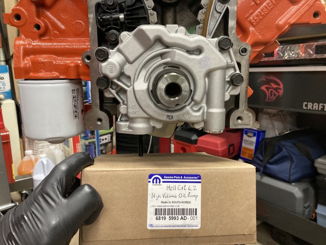

Add new Demon Cam Shaft and install thrust plate, upper and lower cam sprockets, new oil pump, check cam timing.
7B327022-CE25-41A5-A6A7-0DF6ABE7CC56.jpeg 3660B9AA-F1F9-4BC6-A6B0-C1C14391F44F.jpeg 953729B9-F723-4519-BC2F-F5C206F8717F.jpeg 6C19DA95-C259-4B03-8E0B-63E3FA1BCCB7.jpeg 60EFBC62-0183-41E5-8F1C-0CC274075867.jpeg 2A8EA25C-A31A-4B3F-B0CB-82C5B2FDDB59.jpeg F5692A3A-859A-4E2B-A507-EB405017C0E2.jpeg B2626EE9-0E20-449C-8BDA-7DE27956D1FD.jpeg 09B233BE-5EA5-47C5-90D0-FFFF30EE35E2.jpeg
