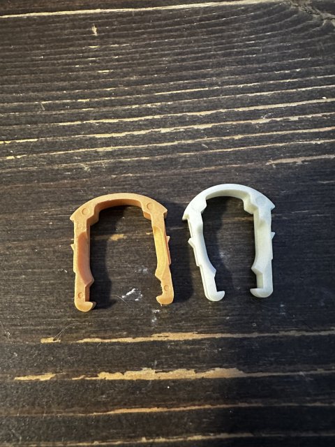

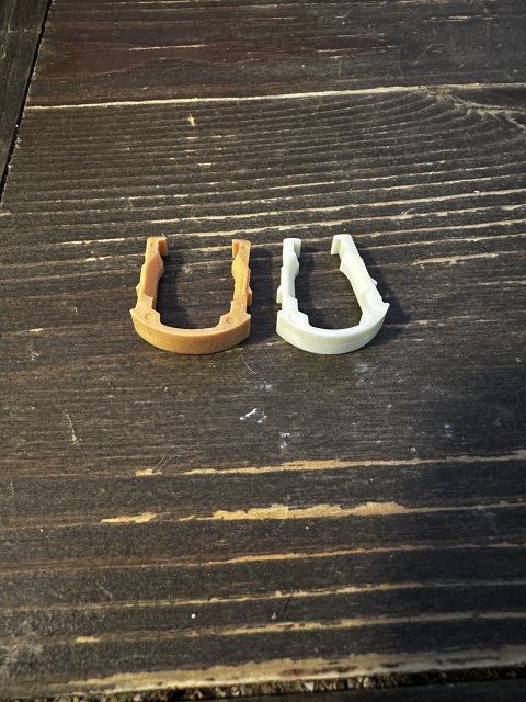

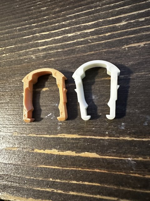

Old on the left, new on the right (white). The old one used to be white. Looks like e85 took all of the tension out of it! Car is fixed 😎 60+ psi at run, and 70+ blipping the throttle. Around 57-60 idling. Drove it around, fired it up/shut it off several times and logged. Calling it good. Hopefully this helps someone else. Thanks again for the suggestion @catdad. Was very lucky only 1 Oreilly had one of them in stock, no other stores
and yes, I got all of the dirt out, tank was all but empty

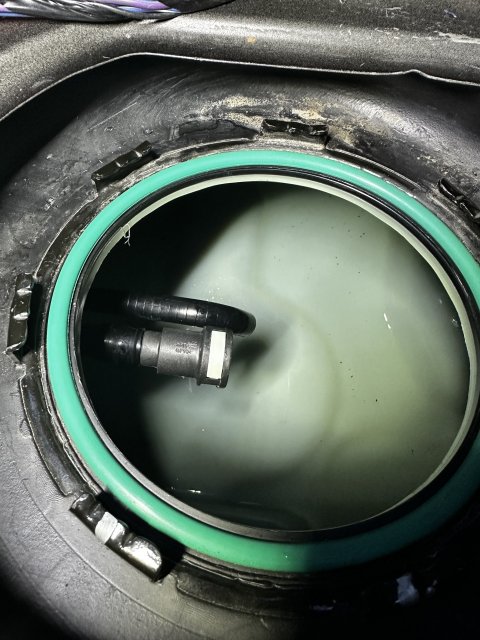

On the bright side, I can disconnect battery, pull pumps (completely) and drain the tank in 20 minutes or less now 😅

If you’re having fuel pressure issues and run e85, check that clip.

1/2” is hard to find typically, hence why they had 1 in the back they had to unbury. Not something stocked on shelves

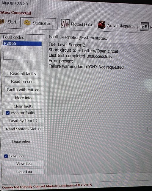

Hmm, so which one is #2? So this doesn’t show a CEL, gas light just flashes and “server fuel sensor” message shows on evic
U
8,659
7,632
Thread Starter #69
Tell me I replaced the wrong one 😑
