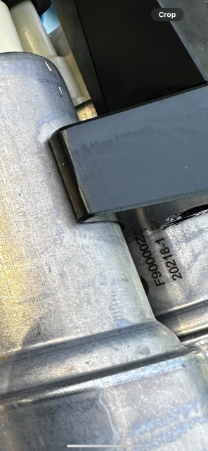

Not sure which pumps they are, can’t see. Whichever ones I jected engineering had in their Gasahol kit 5 or 6 years ago

Thread Starter #29

Number you need to see is under the black holder starts with a two you can’t see the next two digits. If they are five or six years old and the filters were black like that, they need replacing they’re probably not flowing nowhere near what they should be.

Yeah, they’re at least 5 years old. About 40k miles on them. Pretty bummed, nothing I did should have impacted them. Unless it was so low in fuel I finally burnt them up in 2 minutes of driving (to the gas station). Doubt they both went at the same time. Really weary of dealing with electrical gremlins. Have so far been lucky until this
