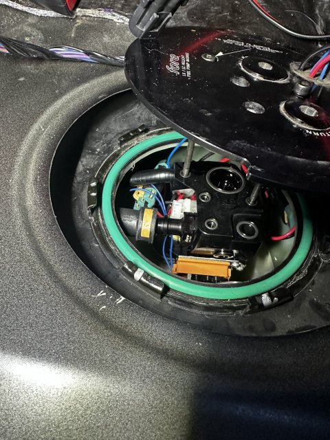

Was just swimming in fuel because nothing siphoned over to the other half of the saddle and was overfilled. Ran to harbor freight and got a battery powered fluid pump. Worth its weight in gold.
so, I look, and I see what I was hoping to see. The line shot off the for fitting, just as I expected. Not sure how, it clicked. I put it on EXTRA good this time. Will be taking it easy in case it happens again. If so, not sure what the next course of action is. Letting some fuel evaporate before I reconnect battery

Very good to know Z (makes sense after looking at the jet pump). Welp, it was fine until it wasn’t. Was logging, was fine. Shut car off, started and died. 3 psi, so it blew off again, so I’m thinking the quick connection is wiped. Does anyone know where that goes to? Looking like I’m going to have to replace that line

Looks like I’m going to have to replace the jet pump if I can’t get it to seat right

Yep, should be easy enough to fish across. Going to pull them again in the morning and mess around with the dumb clip. It’s was on all the way, I guess I’m going to have to test prying it off next time. Good news is it was seeing 56-60 psi at idle and almost 80 on a quick rev

Time for fuel pumps round 50. Few things im doing. Pulling hat, draining fuel (again), and using a pic to see if I can get the retention clip on the quick disconnect to set correctly on fire fuel hat connection. Unplugging fuel level sensor on driver side to see if fuel level still reads (would indicate the fuel level sensor on jet pump is bad). If still having the problem, I could pull the jet pump with the line/fitting and see if the clip is serviceable/replaceable, but I don’t believe it is. You have to push down on it to release, it’s not the same as the clip for the fuel rail, for example. Could maybe cut it off if I could find the correct fitting, and tried to heat up the hose to melt/bond/shrink around the new fitting, but doubtful. Gotta love plastic.

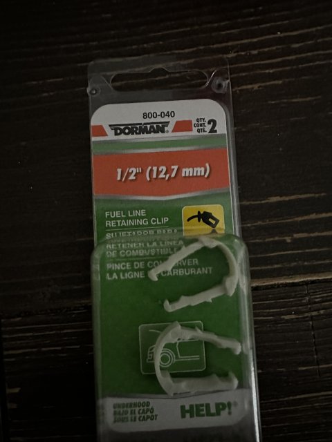

Go to the auto store. We get replacement clips for Peterbilt def lines there. Comes in the help section
Or like Speedy said, pull the lock out and run a ziptie behind the lip on the fuel pipe on the pump. Once you remove the lock you will see how to do it.

Ah, I see now. Wasn’t quite sure what Speedy meant by zip tie lol. I wonder is anyone knows what size and everything the clip is. Edit: according to the fore fitting number it’s 1/2” like the rest of the fuel system

Dorman 800-040 it looks like (1/2”). Might be in luck at O reilly have them ripping apart the store for the 1 they’re supposed to have in stock. Edit: They found it. Should do the trick, we’ll see. Thanks for the suggestion @catdad
