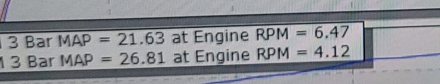

Some of the boost we’ve been playing with. 8BBF51F3-2AD2-4363-96CC-D67A83780327.jpeg AD2D6C64-112A-4E21-9F1C-49B7B92D7CAA.jpeg

What pulley combo was that and you're on E85 right?
11,025
Eek 26psi !
Right now we are testing the cogs in the rear at 27% on max OD. So it’s a 38/30 pulley setup for rear cogs.
Front pulley we started off at a 3.5” and now are testing 3.0”, which is making some good boost.
Hard to say if the 26psi was a little additional heat or not. It was 3000+ DA all day yesterday. Might have more accurate data Monday.

3.5 at max OD made 21.5 psi? Jeebus. That 2650 is a monster.
Yea. I moved up to a 10% lower. Don’t even think I needed it now lol.

I’m not sure how much boost change there would be if we removed the overdrive in the rear. Tuner said it’s very happy at 26. So if he’s good with it, I am. This is being tuned on pump ethanol.

26psi on pump Ethanol at probably 80%?
That's...impressive...and makes me want to drop forged slugs in mine.
Yes low 80’s. He’s been conservative with timing thus far, which is good. If I can make big power that way I’m good. Curious where boost ends up. I have a cam and headers and was surprised to see it this high. @Primetime Hellcat 17 made 21.5 with .25” bigger pulley. Like I said it was super hot out, maybe blower heat? But the IATs on this thing are crazy low.

Did primetime have the OD cranked in the back like you do?
That could account for some of it.
Yup. Same setup essentially aside from cubes. He’s 426. I’m stock ci
11,025
That will soak up boost levels . More cubes more volume .
Yea, I didn’t expect a 5lb gain from a .5” pulley drop lol
11,025
I hear ya. There are lots of variables.
Boost / Heat have a hand and hand, but the IATs with this blower are crazy good so far from what he is seeing. I’ll obviously give a full report once we are settled. I have talked to another guy who had a Maggie on stock CI and actually threw 26psi at it with stock internals. Lasted awhile until he sprayed it. Also saw 26psi with the same pulley combo.

Lol guys someone has to do some R&D.
FFBOS and Marc are right. The Maggie runs so much cooler than the stock SC. We’re gonna hit the rollers again in October/November when it cools off.
