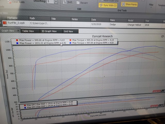

On the 3.5 pulley we saw 1030/997 at 24psi
On the 3.0 pulley we saw 1050+/1050+ give or take for power, but at 26-27psi.
After talking with my tuner, we decided to stay with the bigger 3.5” pulley due to the risk vs. gain for that boost level. The car will be much happier in my opinion where it sits with the bigger pulley. He did see some belt slip on the final runs because of idlers being not in the ideal location vs. when we first started, but we’ll adjust back. (You’ll see that in the graph)

The graph below is where we left off vs. the ported 2.4L vs the stock Magnuson 2650. I feel the sky is the limit potentially with this 2650. Porting data is still not concrete, but from the data we saw, I think it’s obvious at this level it would benefit from it. I would say easy 50-75rwhp gain freeing up the blower inlet.

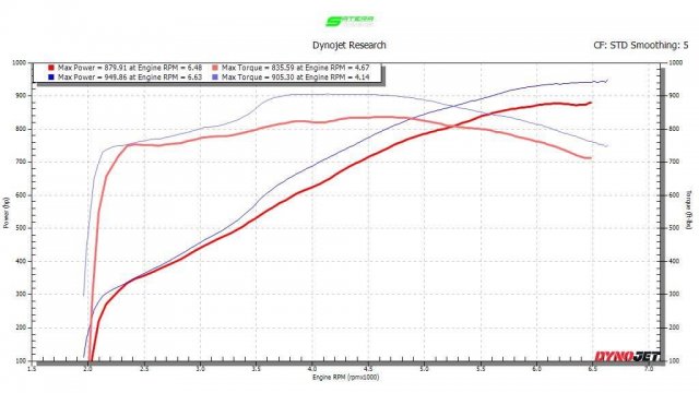

Yup. Over a non ported 2.4, it’s a 150+ wheel gain. Something to consider for those who want to do a build of the 2.4. It has its limits, RPM being the main hazard for the rotors. RPM isn’t not a concern with the Maggie. Unported vs ported 2.4 below.

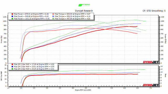

Here is a graph of:
Stock blower with 2.56 only (105tb, ported snout, cam, headers.
Stock ported blower with 2.56
Maggie 2650
Hellion

Here is a graph of:
Maggie 2650
Was all the numbers with a 10% lower as well, or did you add the 10% with the Maggie?

Thread Starter #134
10% was added with the Maggie due to not knowing where we were going to be for boost. One pull it made 21-22, the one shown it made 24. I’ll get some good data on it when I get the car back and I’ll provide the boost I’m seeing via onboard and in logs I’ll get good IAT data as well.

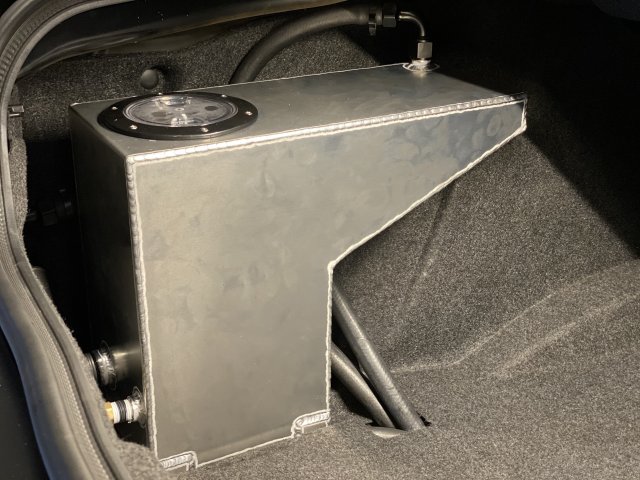

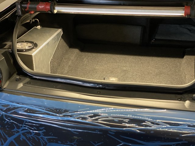

You have a ice box installed in your car?
We saw 109 IAT on the first 2 pulls and the max IAT was 129 on the last pull in 110 degrees.
We were using ice blocks and chopping them up so we could use bigger ice pieces. After each pull ice tank was still ice cold. 67D88143-C2E5-44CE-B0C3-ABFC7E00CBC4.jpeg CEC1AB98-7ECB-4787-8851-0A6F34C6680E.jpeg
Ok that's what I thought. 5 more lbs of boost is where you got your additional power from then over the 19 lbs you were making with the ported 2.4. On average every 1 lb of boost is equal to 20-25 hp. I can't want to see where my ported 2.4 with the 2.56 and 10% lower is going to put me. Should be on the rollers in the next couple days. Then out for some track time. I played with the Whipple for the last 3 years and now I'm going back to stock. I know this is different than what most are doing around here.
