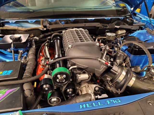

Working on getting it on now. Was a little delayed. This will be un-ported for now.
Sold the Jokerz blower. Curious to see what this thing can do apples to apples. I was rpm limited with the 2.4L if I wanted to keep it alive long term. My prior setup was very efficient for 17psi.
I added a 10% ATI. I’m using the 15% underdrive @Hpindy sells for the front accessories.
I’m running the Maggie at max overdrive in the rear at 27% and going to start with the 3.5” front pulley. I have a range of sizes all the way down to 2.7 if we want to try it.
Also moved to to 1700’s for injectors.

Bottom 9’s on boost is the plan. Weight is my main disadvantage lol. Was shooting for 9.4X in the fall with the 2.4L, I think we would go got it in good weather for sure.
I plan to try a few different pulleys on this 2650 and I’ll have data on what each does boost wise. Starting with the 3.5, going to the 3.25, 3.0, then 2.7

Making progress

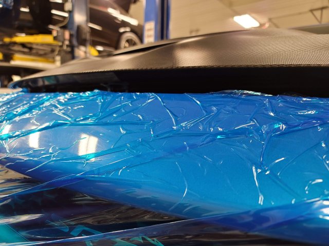

Might have to take off that 105 spray plate. Hood won’t close due to me running the FI spacers. We think it is the 105 Nitrous plate, I’ll know tomorrow...... 9E0812A8-9E93-420C-9510-C722D94F8EF8.jpeg

Might have to take off that 105 spray plate. Hood won’t close due to me running the FI spacers. We think it is the 105 Nitrous plate, I’ll know tomorrow...... View attachment 22957
you can space the cradle a half inch to buy some room if you need to. Others have done that and haven’t had any issues as far as I know.

Put some washers under your hood latch... keep the nitrous at all cost!:ROFLMAO:
I spaced the cradle to make it fit. But I don’t have the FI spacers anymore. Had a custom spacer made for my whipple. @Marc W has one of the fancy spacers made down here in Florida also. There’s only 4 or 5 in existence. And they work well. You might want to see if gearhead makes one for the magnuson.
