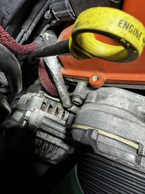

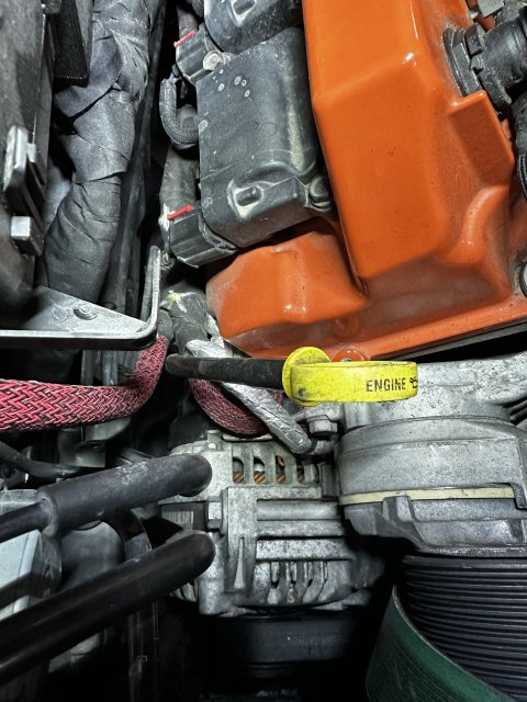

Can’t move the alternator/coil wire harness because on the challenger that sensor that’s behind the alternator is in that same loom and splits right at the end of the valve cover so no play. Had alternator off before, not doing that again lol
8,667
7,636
