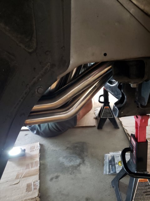

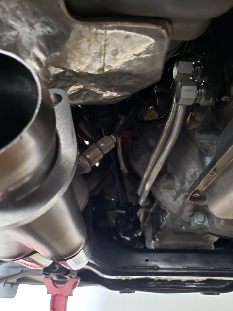

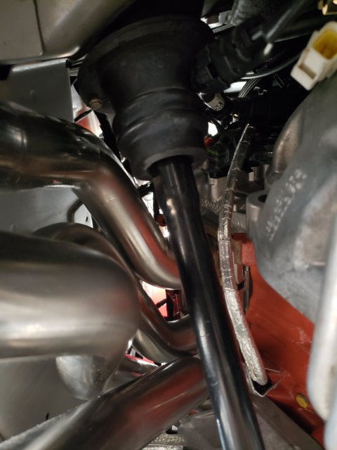

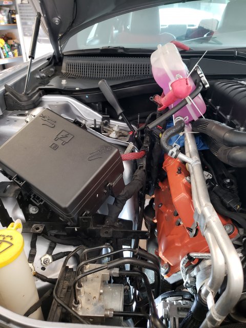

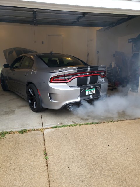

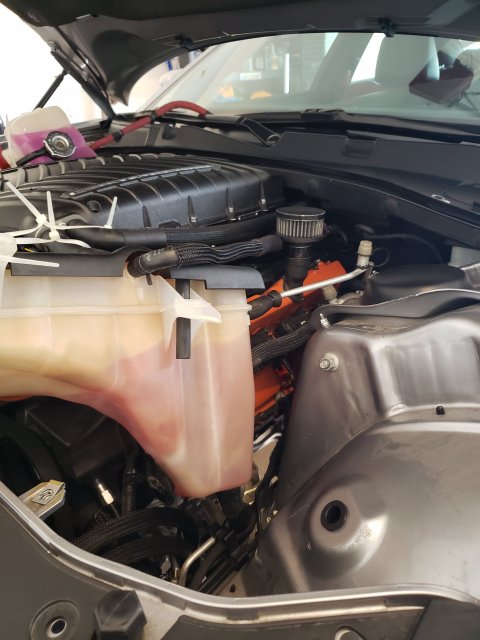

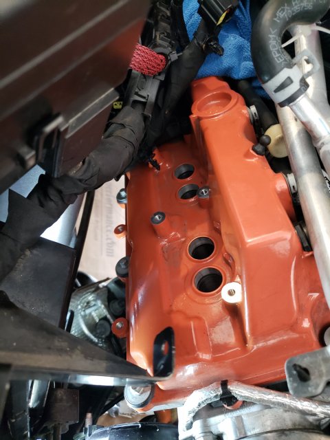

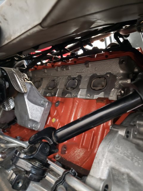

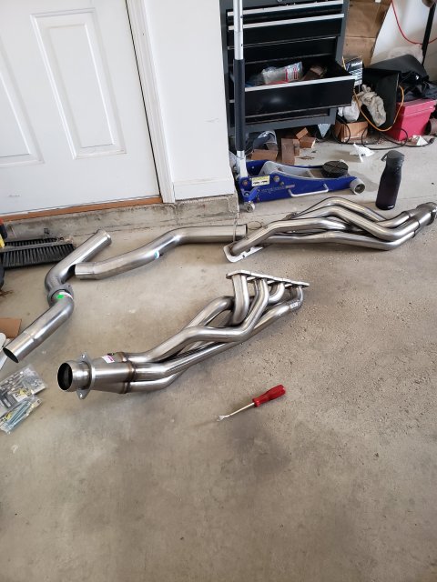

Bought the headers on Black Friday and finally installed them. I have done headers before on my 17 Daytona 392. I would say similar but a little harder with the extra stuff on the passenger side and coils. We pulled the first 2 coils and moved the wiring to make room. Did the top front 3 on both sides from the top the rest from the bottom. It took longer to unbolt the stock manifolds then it does to install the headers. Having an extra set of hands help a lot. Took around 7 hours. Smoked pretty good and filled the garage with the oil they put on them. @Jon sent me a tune for them today, thanks

They say kooks and there is a hellcat on them but you really can't see it 20230701_215145.jpg 20230701_215029.jpg 20230701_214942.jpg

When we did the daytona we took out the motor mounts. On my 13 mustang it is what you do but on the hemi it just added more time getting them off and even more time trying to line it back up so only did that once. The steering shaft is one bolt and you can see it hanging in the pics. Getting the wiring out of the way helped a lot. Even taking the wiring off the alternator to help move it out of the way. It's not a real hard job, just takes time. Everything done with hand tools

Awesome! Did you have to hack the motor up/remove starter? Or just the steering linkage?
Starter came out also

But did you have to undo motor mounts?
Nope. Starter, steering shaft and take knock sensors off
