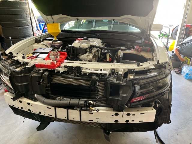

Just a few pics of my install 67425420720__A1A53747-C9F4-42CB-AE18-6E00EB1D1B36.jpg IMG_1212.jpg

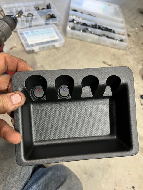

thats what I like not having to cut anything....the only thing I dont like is having to put a switch in my car I like to keep mine unchanged. But I'm still going with the ic chiller.I'll just hide the switch the best I can.
U
8,673
7,639
Thread Starter #260
You can put them inside your center console
