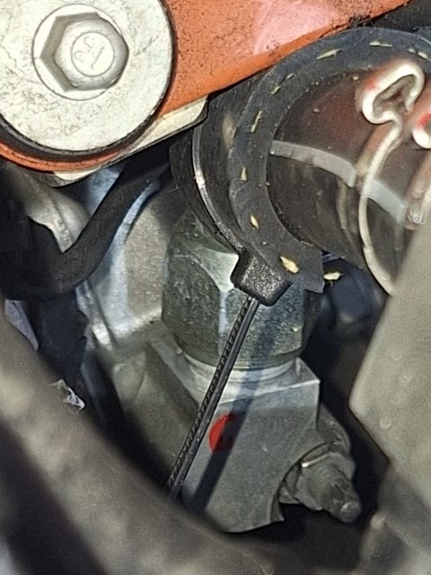

I will double check but I am like 99% sure your small piece of hard line is radically different than mine is. Yours has 2 bends in it and appears to be much longer. Mine almost comes literally straight off the AC compressor with a single bend and right up into the clamp. You can almost see it in my picture but it's difficult. There is no double bend like yours and I'm well inside that valve cover bolt.

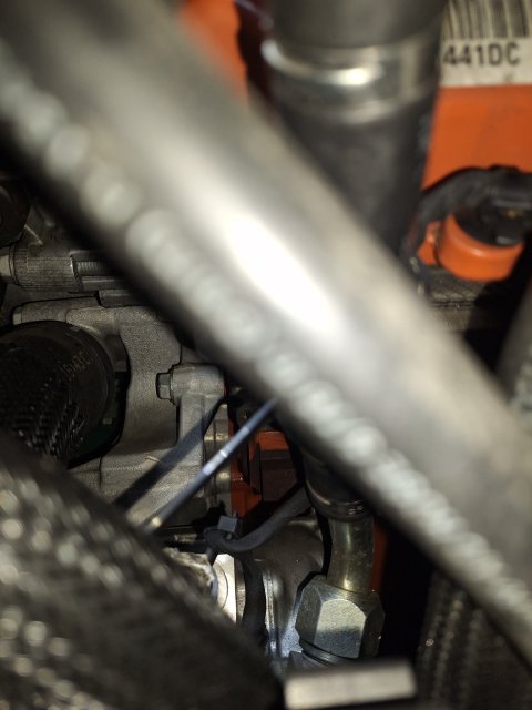

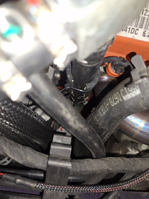

I got some different pictures. My low side hard line is DEFINITELY different that yours. Comes right off the compressor at almost a straight 45* and right into the crimp barb. Yours is longer and with a double bend to clear all that crap. A difference in kit applications or a revision from feedback? I dunno. But I sure could use a new low side port to block to compressor inlet line/clamps with your style hard line.
U
8,747
7,679
Thread Starter #223
Well damn.
View attachment 131967 View attachment 131968 View attachment 131969
Weird, must be a revision or something. I’d reach out and see if they have just that part, you don’t need the fitting for the compressor, just the hard line
