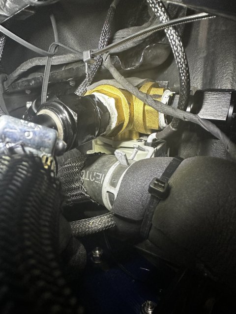

My 3 way valve is still leaking at the fittings...it's 100% better than last year but still dropped coolant over the winter. You say there's metal fittings included with the kits now? What size and style would they be if I tried to source locally?

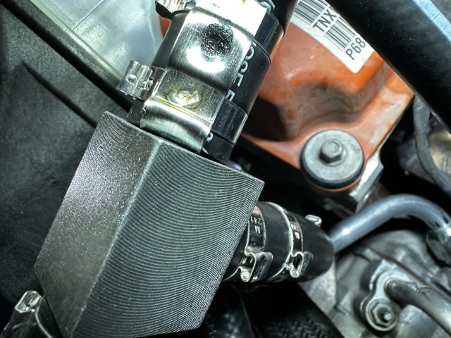

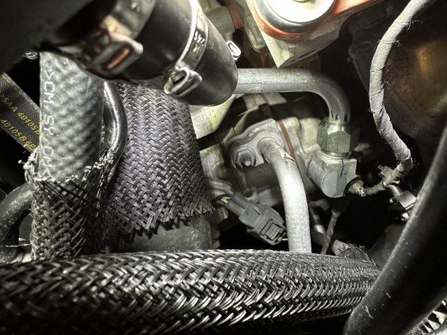

Also. Earlier I mentioned the low side suction into the compressor was essentially tight to/rubbing on the cylinder head/valve cover mating surface. Pictures. Finally. Of what I'm talking about. You'll see the piece of hose I was barely able to wedge in there for now.
You also mentioned an updated or longer line for this purpose...how big of a PITA is it gonna be to retrofit mine so it doesn't make contact anymore?
Otherwise it appears the system held charge over winter. Preliminary test at 52* ambient still got things below 40* coolant temp without much fuss. I expect it to do better once fully evacuated and properly charged to the recommended 28oz since I literally have no idea how much of the 7 containers of 134a made it into the car or the atmosphere. I tried twice to charge by pressure instead of weight and failed miserably after that low side fitting came loose at the track last year. Lol

They’re 3/4” npt. I’ve had mine apart a few times now, think it’s finally done dripping after a fittings, pipe paste, and tightening the crap out of them. You need to unscrew the hardline from the fitting that goes to the compressor, index it differently, tighten, then reinstall. Hose is just hose, just get a piece of the same kind and make it as long/short as you need for the suction line

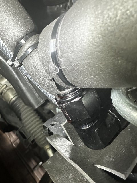

So you loosen the fitting from the hard line on the compressor, swing the hard line towards the bumper away from the cylinder wall, mark with a marker, take off car, tighten and line up marks, reinstall. The hard line and the fitting that connects to the compressor isn’t 1 piece - they come apart

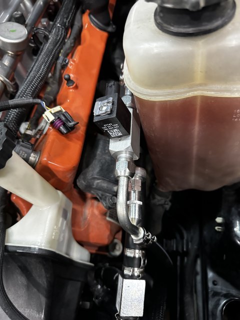

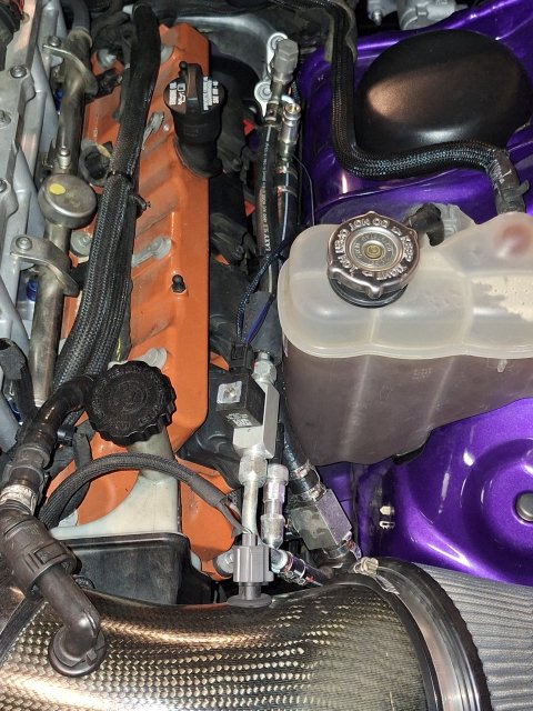

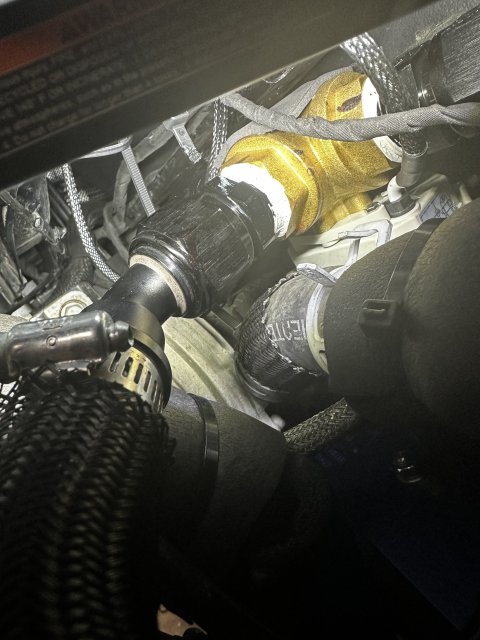

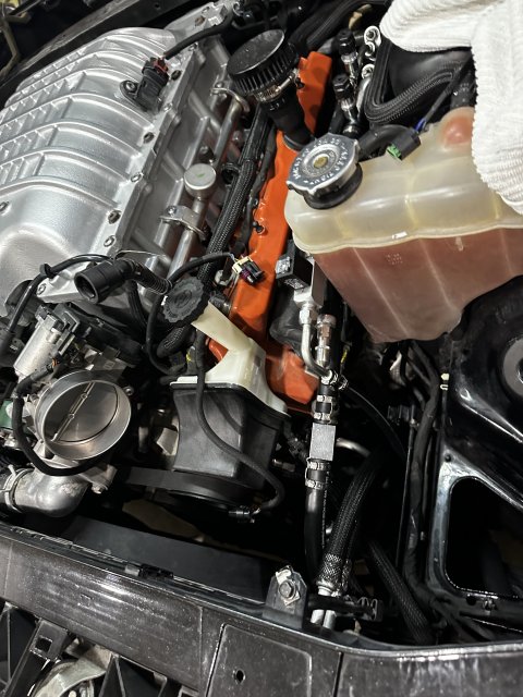

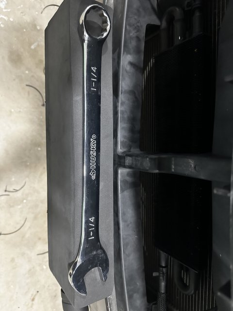

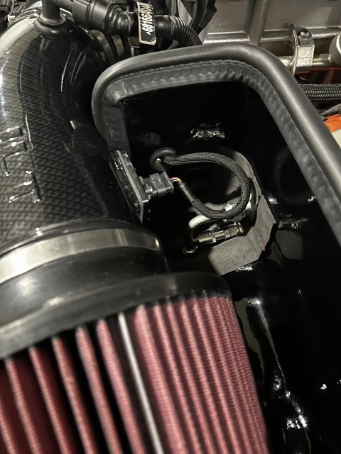

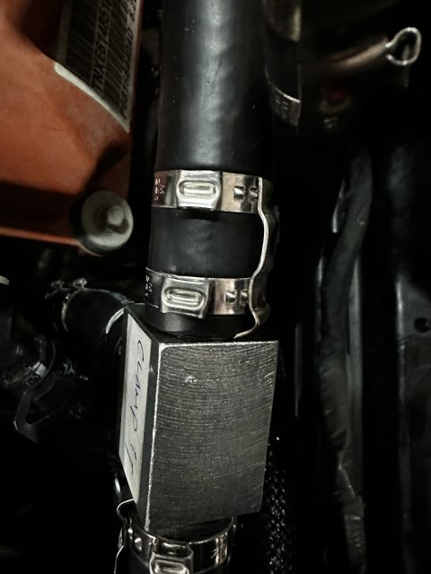

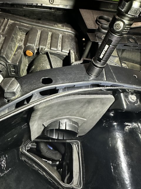

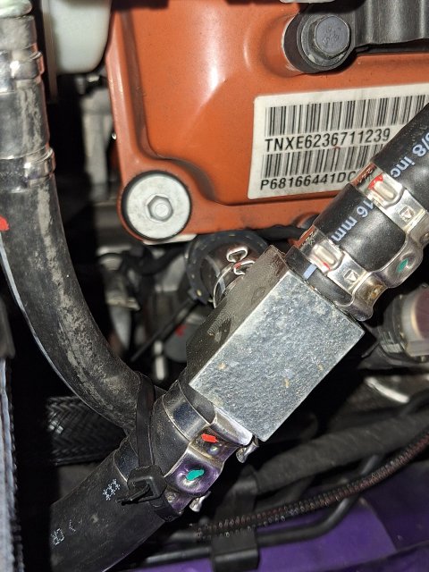

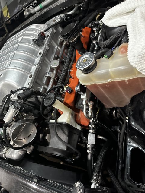

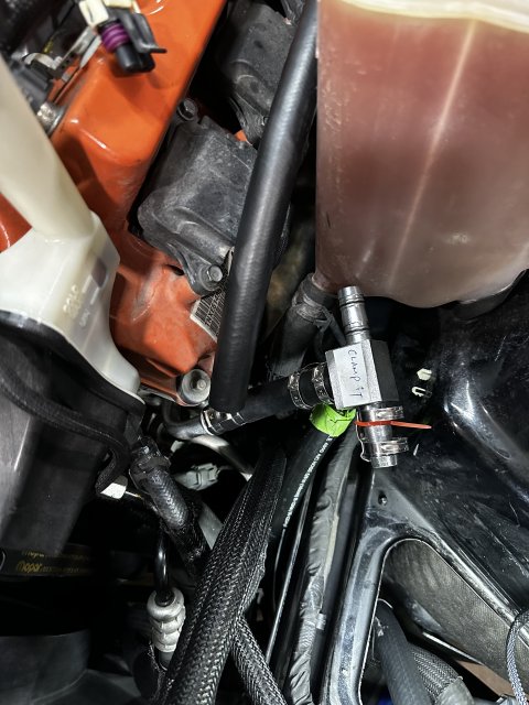

IMG_1767.jpeg IMG_1769.jpeg IMG_1764.jpeg IMG_1763.jpeg IMG_1761.jpeg IMG_1758.jpeg
U
8,667
7,636
Thread Starter #210
Hope that helps @fubar569

My AN fittings that I switched to were leaking until I got a BMFW to tighten them, all good now. Go with 3/4 npt to 3/4” barb - I would not use AN fittings for the valve.

The pictures most certainly help but I'm not sure that the lower piece of Hardline for that connection to the compressor even looks like that. It's as if mine is shorter and without the extra Bend because if we were to swing yours to the orientation that mine is it would be pointing in a completely different direction than mine currently does. Also I doubt that Allpar left me enough slack to move that block that far IF we were able to rotate the line. I would probably need another section of line to cut and recrimp for the section that runs from that block back to the low side port.

Mine was like this before I reclocked it. Looks just like how yours is now. You just need to do what I suggested.

You need to undo it and reclock it @fubar569. That hard line is on the compressor fitting tight. They installed it just how it was in the box - I took everything apart and mocked it up first

Yeah, but it’s just good year AC line, part number is right in the hose and 2 crimp fittings. I would redo it if it were my car, have already redone my coolant side and the fittings twice

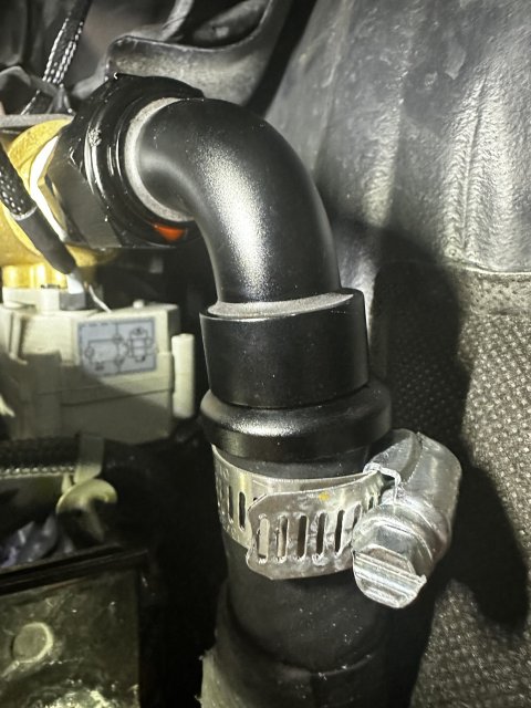

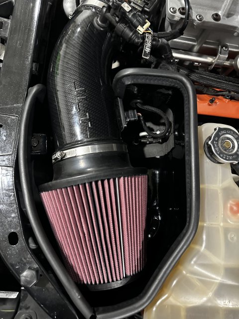

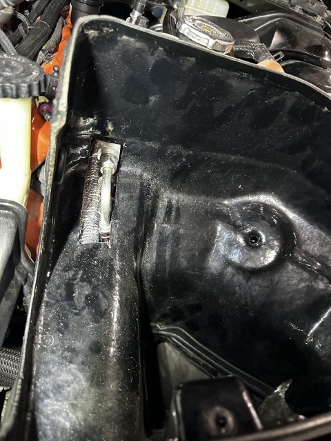

I also put some vibrant extreme wrap on my suction line before the block, pipe insulation after the block. Notched out my JLT air box to use it again

I will double check but I am like 99% sure your small piece of hard line is radically different than mine is. Yours has 2 bends in it and appears to be much longer. Mine almost comes literally straight off the AC compressor with a single bend and right up into the clamp. You can almost see it in my picture but it's difficult. There is no double bend like yours and I'm well inside that valve cover bolt.
Is yours a redeye by chance?
