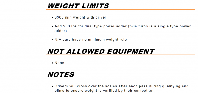

#77
OMG
"NOT ALLOWED EQUIPMENT"
None
This reminds me of the Can Am racing days, but on a drag strip!
Oh, and dual turbo is a single type power adder!
20,160
#78
lol, pretty pathetic we have to weigh before each pass. but there are sumbitches all over.
C
cole3986
#1028
1,110
1,461
TBD
Thread Starter #79
Minimum weight for the outlaw class is 3,300 pounds, what a joke. Most events with a Outlaw class (i.e.Lights Out, etc.) use 2,650 pounds or less. For example, NMCA class rules have weight depending on displacement and power adder being used. For twin turbo and small block mopar (i.e. Gen 3 hemi) minimum weight is 2,375 pounds.
Focused on the motor right now, tool steel head studs, 6 bolt billet mains and crank being used.
K
Kat von Himmel
Guest
#80
NO, it's worse. you have to weigh AFTER the pass, so your enemies can spy on exactly how much weight your car has lost, thus being able to have knowledge of your setup to which they should not have access.
Seems stupid to me. I wouldn't want to race in such a class as my first choice. 3300 pounds, also? What next? You have to have your car x-rayed, engine dismantled for pictures on Instagram, and photos of you naked, with DNA samples?
