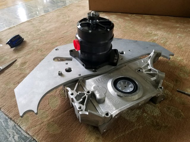

It is X Mas in May, front motor plate is done, the black thing in the middle is a big ass vacuum pump that is designed for pro mods.

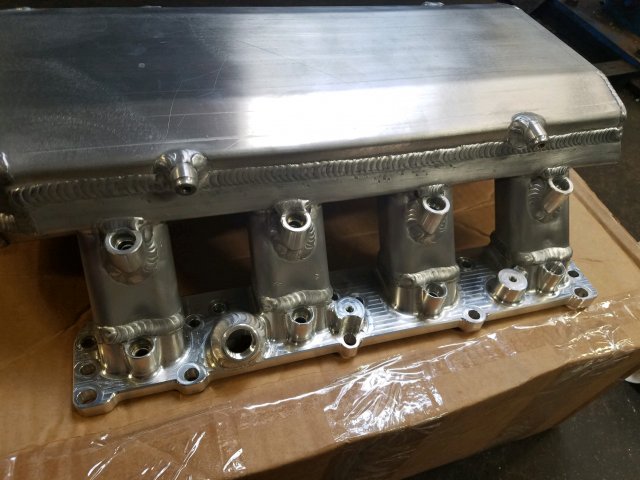

We are making progress, and spending money to support the economy. Now tell me that sheet metal intake is not sexy

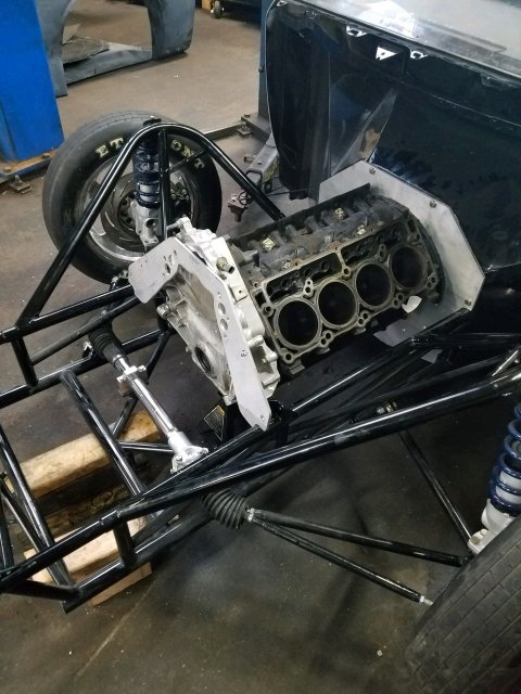

I have not even thought about that, for those who want to use motor plates, the timing chain cover needs to be modified (big time). The timing chain cover is different on the hellcat, there are three (3) different style timing chain covers (truck, non hellcat/redeye/demon, and hellcat). The hellcat/RE/Demon accommodates a bigger oil pump.
Using a wet sump set up, the dry sump was over 4.5K and feeds through the port located above the oil filter housing, I was not digging the port size or the price.

For methanol, cannot flow even fuel through a single injector, the sheet metal intake has two injectors per cylinder.

11,025
The motor is now part of the chassis now with the 2 plates .
