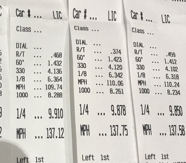

Here are some high 9 sec times slips. This will give you a look at the mph necessary to run high 9 sec et’s This was done on a well prepped track and I was running 3.09 gears with the 17” 315’s at that time. DA777280-DB3B-4999-A3A7-5185E05B6DD2.jpeg

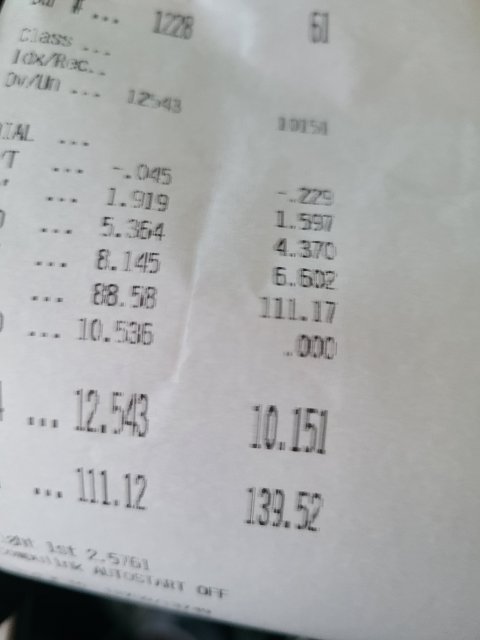

I know i need to work on reaction time but from my understanding that doesnt effect my et or 60ft. Yea ure getting 1.4 60.ft. That's where i should be but cant seem to get it there thus the thread.
How's the prep? I watched a little of the street car shootout or takeover and they were basically no prep racing. Prep was horrible.
You need more out the backend in my opinion.

Its decent. There's other cutting 1.4 and 1.3 60ft.
Hell less modified hellcats and scatpacks are getting out of the hole better than me. I just dont know what im doing wrong,

time slips will help to look into further. Is your car really heavy? We all weigh in the same area but have seen some cars pushing 5k. Are you sure the diff is working correctly? Some have said the clutches are worn are not holding well so one tire may be spinning some

2.5 pulley is slowing you down I bet. Many have tested and below 2.75 it gets too hot. Your coolant tank may help but I'd be curious what IATs are like.

Ill ask jon my tuner. Ive got the interchiller stage 2. When im coming off the line my supercharger coolant is 30 degrees. The 1.5 60ft is slowing me down too
Diff seems fine.

If you think it is working fine then I'm sure it is. Just throwing ideas out. Have you sent Jon a datalog of a pass at the track? Something maybe happening on launch

Should launch awesome with that pulley but get what you are saying down track

Yea i sent him many many. I. Log every pass. Nope doesnt launch well at all

So is it spinning or not pulling
