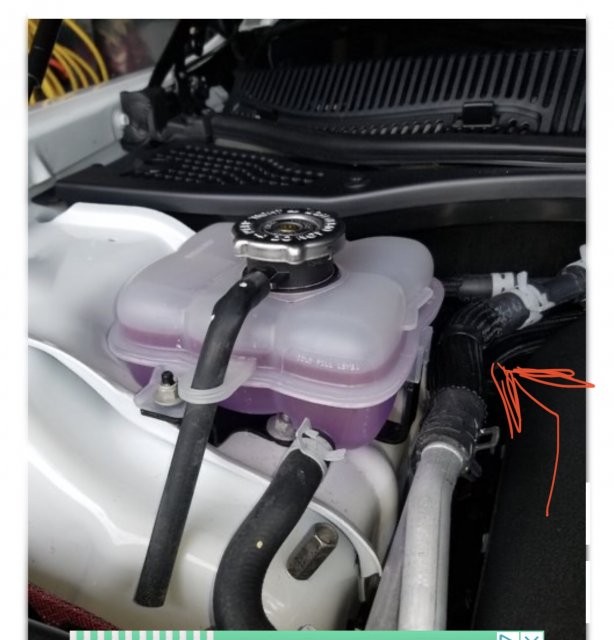

You can mess with the bleeder in the back of the supercharger but with this method there is no need to.
just pinch the hose I have pointed to here with the red arrow BEFORE you start the car for the first time After the install.
By doing this you will force the coolant along with whatever air was introduced into the system to go right to the overflow bottle where it can escape.
Im other words, the coolant coming out of the supercharger is where all the air is going to be. By pinching the hose you send that air right to the overflow bottle instead of down into the IC pump.
Top off the fluid after you let it idle And cool off for a little while Then, take it for a drive and monitor the IC coolant for a week or so to make sure it doesn’t go below the level.
hope that makes sense.
if my thinking is flawed please someone correct me, I won’t get offended.
this is the way I did it and it worked like a charm.

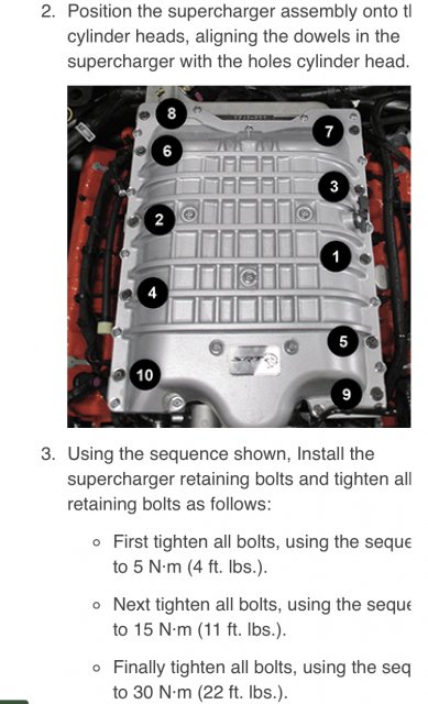

by the way, I should recheck the torque on my bolts again.
anyone remember off the top of their head what the torque value is?
I have it saved in my phone somewhere, cant Seem to find the picture with the torque pattern.

These are from my manuals:
Checked my tensioner myself
16,892
52,898
#71
FYI: While these are the values I used as well, I have seen a specific set of values (lower...) for the FI Spacer installation. I do not know what the source is, although I would presume F.I.??? Nor do I know if they are appropriate.

The different torque value for the plate install is news to me as well.
thank you fumanchu for the pics!!!
