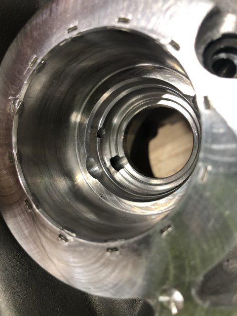

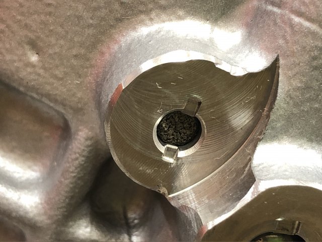

The vents aren’t the shiny balls, the shinny balls are plugs to seal drill ports, the vents are the pourous silver items, 2 of them next to the shinny balls. They are connected to these ports between the seals and bearings in the gear case side of the supercharger. See the hole drilled through this bolt, this is how the gear case breaths as well. It’s important these vents remain open, they went through allot of pains (expense) to make these ports!! image.jpg image.jpg image.jpg image.jpg image.jpg

I think you left the wrong holes uncovered, the vent ports are the porous looking silver things not the shinny balls, there seal plugs, they can be covered.

All these ports all also connected to the suction side of the blower through this port. So have them sealed off isn’t the end of the world but it probably causes more of a negative pressure (vacuum) in those areas then designed, which could possibly take oil out of the gear case and one would never know it’s leaking then. The bolt with the hole in it goes into the faster spinning rotor lobe, it is cross drilled to have a port between the seals and the bearings. The taper it has is to help centrifugal force separate oil out of the air that would leave the gear case which should be about next to nothing as it’s there to keep the gear case equalized to atmospheric pressure. See this port on the inlet side of the blower, it’s under the rotors on the right. F31C2CD3-98F4-483E-89F9-08F52C7B99DD.jpeg 1DF15C05-0DBB-4D7F-AD66-095271317501.png

This blower puked oil out those vents for some reason. This was a FAS MOTORSPORTS rebuild, could have been their shotty work though, the vents did their job. Most likely the rotors seals where shot or installed wrong pressurizing the gear case and it blew the oil out through the hollow vent bolt through these ports on the bottom

No, it wasn’t. The owner wasn’t very happy with his purchase from FAS MOTORSPORTS either, they boned him and didn’t own up to replacing the blower either.
