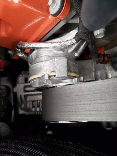

Did the Dayco fit? I just installed new idler and tensioner pulley and my tensioner is to the left side like pic a few posts ago. Once I put the plates in there will be no way the belt will work. I was looking at the gates hd belt 100582 but I don't want the green belt 20200531_123046.jpg

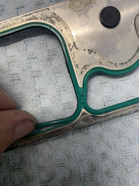

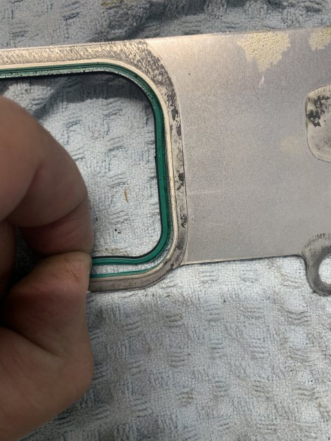

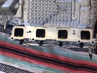

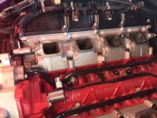

So I did this exact mod and took her to MIR over the weekend. Good times had by all, not a single issue with the car. Boy am I glad I did the swap sooner rather than later. The gaskets where letting oil blow by, the crank case was definitely pressurized. Take a look at these POS gaskets.
4,843
25,692
The ones from my Hellcat looked ok but the Redeye had some blow by for sure.

My IC was pretty much oiled up... I'm glad I got rid of the bad gaskets when I did. I could only imagine how that engine was feeling after being driven.
