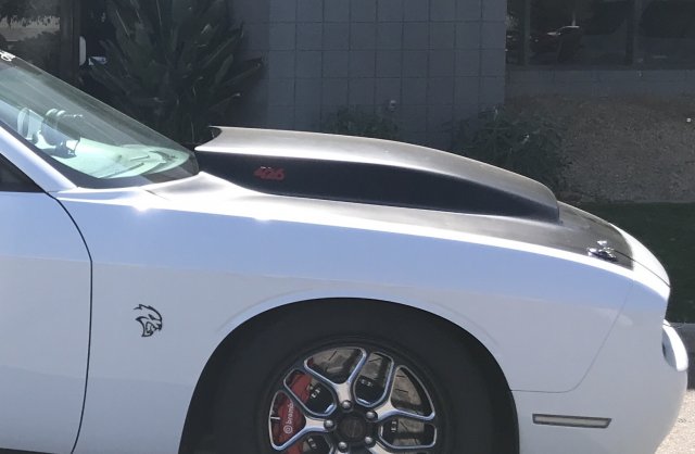

Definately will NOT fit the Redeye stock hood. I do have an Anderson Composite CF raised hood I bought to fit the 3.8 dragpack that I was gonna use but now selling. Its brand new never installed sitting in box lol. Gonna put up for sale soon.
Thanks for the info Marc. Just waiting on Whipple to release pricing at this point.
Billet version looks really nice. Do you know if the 3.8 with the larger intercooler upgrade fits under a stock Redeye hood?
Thanks, I saw on one of the Hellcat racing facebook groups that there is one of the 3.8 cars running a carbon redeye hood I just wasn't sure what difference there is clearance wise from the stock version.

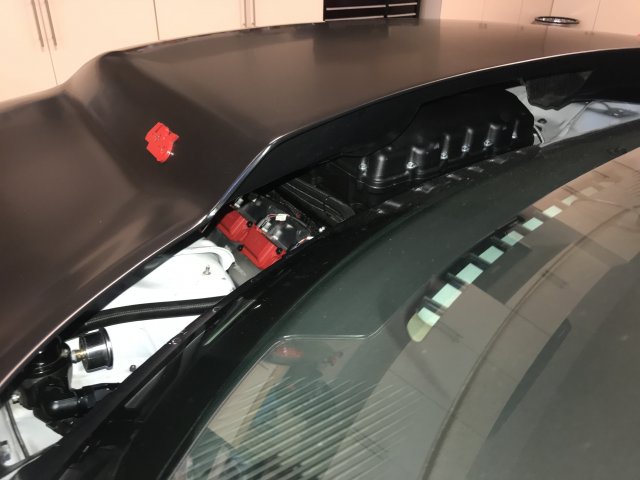

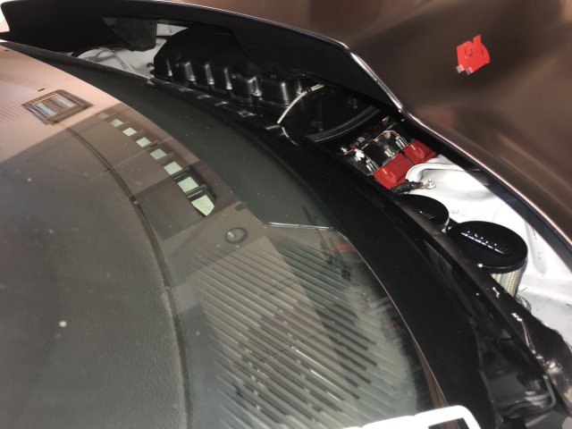

I’m using the fiberglass Kenne Bell cowel hood. These were originally designed to fit their big 4.9 supercharger. With a little bit of trimming on the underside in the rear, they will fit about anything. I like the hood. It’s light and uses the stock hardware. Fits tight and I have had it up to 184 mph with no issues. With the wipers and all that plastic shielding removed, it allows airflow under the hood to take the heat with it. It’s open enough to not allow for any pressure buildup. If the CF hood @GNBRETT speaks of selling is one of these….. buy it! 255B75C7-BEB3-4F90-81F5-06811B601D90.jpeg C0684E02-492A-4243-A25D-4A4F1FA8F081.jpeg A9B74CC3-2397-4C02-9D0E-7D0757A5E5C7.jpeg

I’m using the fiberglass Kenne Bell cowel hood. These were originally designed to fit their big 4.9 supercharger. With a little bit of trimming on the underside in the rear, they will fit about anything. I like the hood. It’s light and uses the stock hardware. Fits tight and I have had it up to 184 mph with no issues. With the wipers and all that plastic shielding removed, it allows airflow under the hood to take the heat with it. It’s open enough to not allow for any pressure buildup. If the CF hood @GNBRETT speaks of selling is one of these….. buy it! View attachment 104751 View attachment 104753 View attachment 104754
Yep, Anderson CF one. NIB. They are pretty similar just the CF is a little lighter. Not by much tho I bet.

Yep, same exact one. NIB
The one I wanted but I was told 4 months to get it. So I opted for the fiberglass version in stock. The Anderson CF’s are beautiful 🤩

I was actually on the fence on getting the KB one or AC. I really like them both cant go wrong with either.
