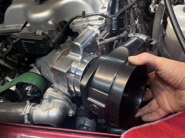

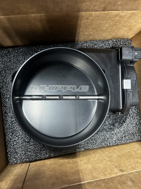

Well, getting closer lol..... Ordered from Dusterhoff. Says friday they shoud have a bunch in. Pre-paid so hopefully I get in a week or two! Wooo-hooo Psyched!

Just got email from Dusterhoff. States Nick Williams shipped them yesterday and should be here friday. Believe it when I see it lol.....

I was referring to the TB but yea its the same fit tho. I already have the billet 3.8 just not sure if im gonna use it or not right now.

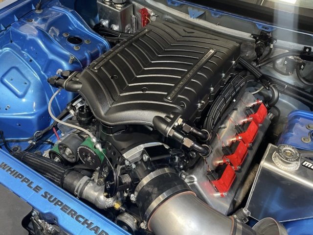

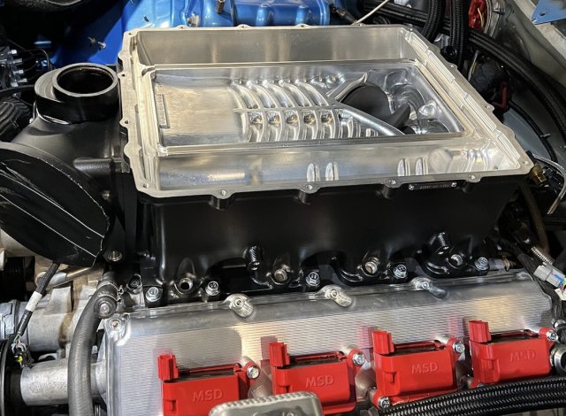

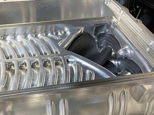

Billet version… 29FF91D8-2034-485B-9849-8908DE7A74C9.jpeg E1EBBF7E-765F-4294-AE90-44E58BB5E179.jpeg A40E6A58-D49A-43D4-9B68-5DBCE5CEDF44.jpeg

Billet version looks really nice. Do you know if the 3.8 with the larger intercooler upgrade fits under a stock Redeye hood?

Waiting on Whipple. Where have I heard that before? 😂. I have that one in the pictures for sale. It’s the billet version with the big IC and a vacuum bypass. Whipple is not making that anymore. I don’t know how long it will be before the cast version will actually be available. As far as the hood goes… I would say no.
