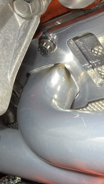

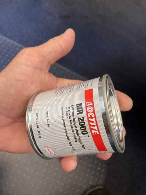

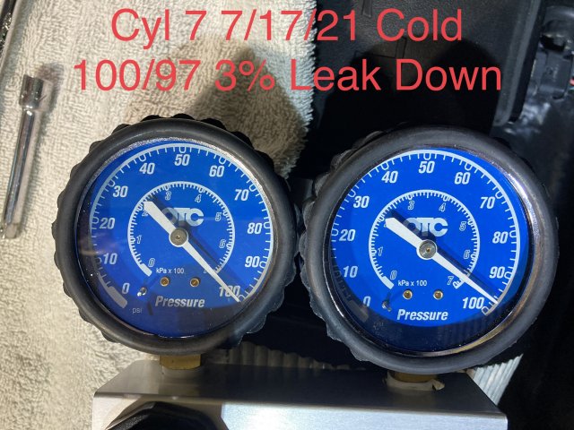

Start up went well, have about 600 miles on her now on 93, be going back to corn soon, 2 oil changes on Driven Break In oils, on PUP 0W40 now since 300 miles, one more oil change at the 1000 mile mark to Amsoil 5w50 Signature Synthetic and its party time!! Clicking in start up video turned out to be a header leak, fixed it with high temp putty, worked GREAT, no more ticking thank God!! JBA sending me a replacement header no charge, class A++++ company, no hassle replacment, no idea when or if I’ll change it though as long as the putty holds up!! It’s good for 2000F continuous so it should. Leak down test in what was the problem cylinder 7 is at 3% Cold with .026” ring gap, other cylinders all in the same range at 2-3% leak down so all is looking well to start leaning on her now. Looks like the operation was a success!! Yaaayyy!!

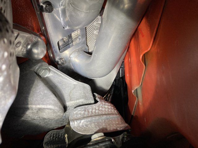

View attachment 50061 View attachment 50062 View attachment 50063 View attachment 50064 View attachment 50065
Not a whole lotta room in there with those headers.
Damn.
3,823
9,057
Damn.
Correct, DS has about 1/2”, PS only clears by about 1/8”. But they lined right up to the flanges on the pipes exactly the same as the stock exhaust, I did not have to loosen the down pipes at all for alignment. Car will be on the dyno in near future once back on corn and if no gain from before rebuild I’ll be going back to massaged stock manifolds someday as under hood temps increased dramatically compared to stock double wall manifolds.

You just put that Loctite putty on externally, wiped clean and it held? That's pretty good! BTW that .026 ring gap is pretty generous (got it, high boost and maybe more tricks??? Lol.) so 3% cold seems good/reasonable to me. Glad this thing is moving along for you.
3,823
9,057
Yep, cleaned well with degreaser and squeezed it in like caulking with my finger and wiped off the excess. I tested it on a piece of smooth billet aluminum rod stock, just cleaned with same degreaser and rag, just plopped it on, no sanding, next day hit it a few times with a small hammer and couldn’t chip it off, but at $80 a can it better be good!!

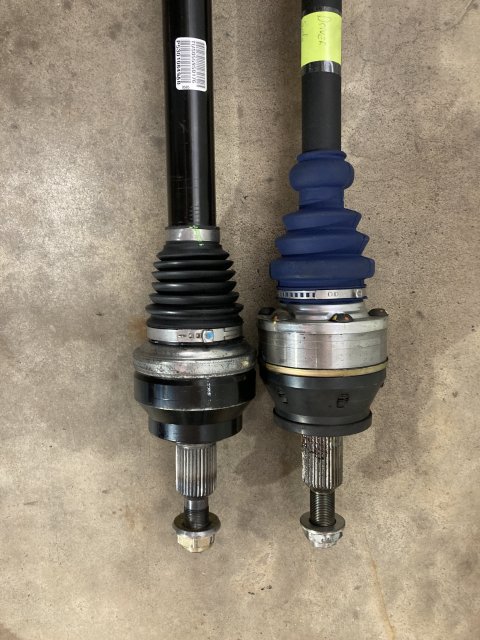

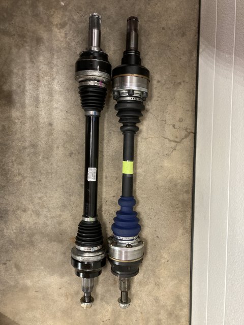

Removed the DSS Stage 5 axles to send back for rebuild and installed Redeye axles. They run with much less NVH then the DSS ones, we’ll see how these hold up.
