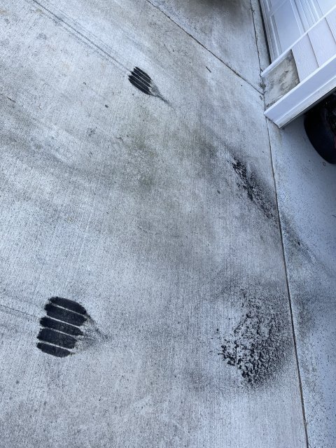

Tested the line lock with the manual - talk about a sweet smoke show!!!
It was only a six inch "stripe", but talk about putting out some smoke!!!
Did it with the shop door open and I couldn't see in there for about a minute...
Do not hit the wall like I did.

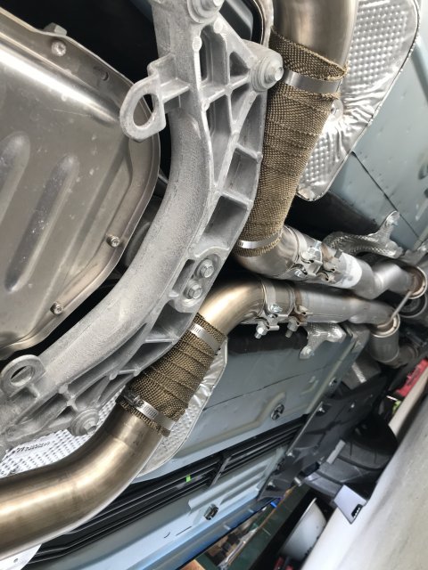

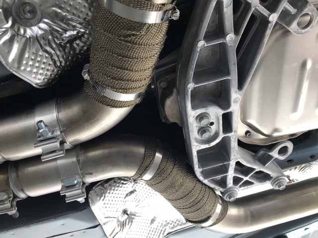

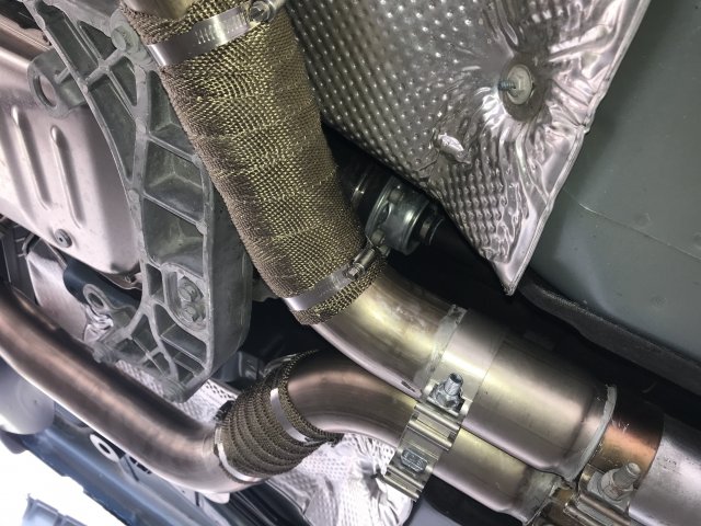

PUT HEADER WRAP ON MY STAINLESS PIPES.
Pipes are 3" (a little bigger than factory 2 3/4) and are closer to the floor pan at certain locations and tranny cross member (practically touching crossmember). They generally fit ok but not as well as I liked. Had to be persuaded with a pry bar for all around clearance while fitted in place but bolts still loose at all locations. Even after fitment, were still to close in certain locations for me, so i wrapped'm.

I had the same pipes. I thought they fit fine on my cars

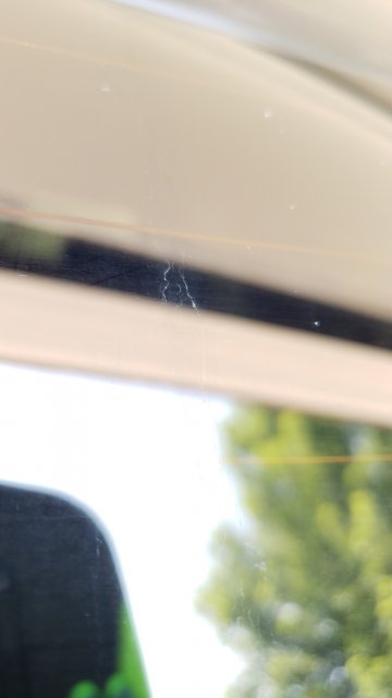

The DSRT rear spoiler drips badly after being washed
Resulting in this hard water streak
Anybody got a good product/technique for removal?

Like I said, they generally fit eh.. ok. But when I got the flare on the end of the pipes to sit perfectly square and even on the beveled end of the factory exhaust header ( where they were perfectly even all around the flange), they were hitting the floor on the pass side or the tranny cross member on the drivers side. I kept playing till I found the happy medium, but still too close for me (@ 1/8" to the floor on the pass side and 1/16" or less to the tranny cross member on the drivers side). The wrap wouldn't even fit between the crossmember and the pipe, I had to use the pry bar again just to open up the clearance temporarily and then pull it through. But the big picture plus is....NO LEAKS! :D

That is the issue with them is to get them to not leak. I spent a lot of time adjusting mine when I put them on to test last year. Think I never got them to completely seal. I'm thinking if you run e85 it won't be so crucial to seal them

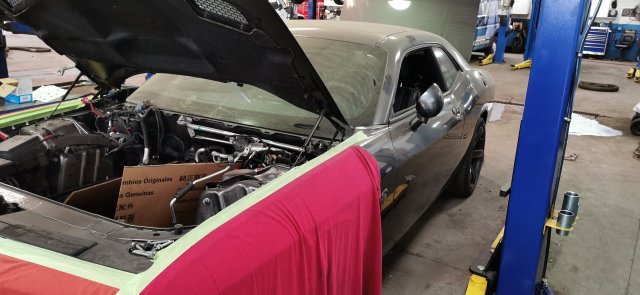

I went to the dealer to see my car. Which if I'm lucky I may see again in August.
It looks like a barn find.🤣🤬😢

Yep saw one like that a few weeks ago. Brother, good news, I know we have been talking about our mutual problem, but they recover.[twothumb]
