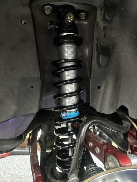

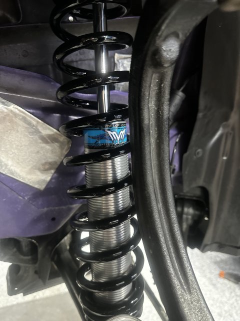

I like! All of the electronics are out of this car right? Wonder if I can disable the active suspension and switch to these
Yes shock delete engineering makes plug In adapters to keep light off

Ah no way really? Good to know. Let me know how these work after you dial them in

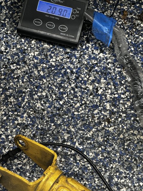

Was about 30 pounds total front and rear yes you loose the rear springs. Going to be a bit I’m putting in a cage also and my 3.8 whipple
