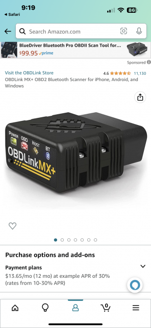

ELM327 interface
Plus 5 for software?
8,634
7,601
ELM327 interface
$50 for softwar (off their website) and get an obdxii
8,634
7,601
Er, obdmx+

I would think this is windows based. No iOS so I need to use my surface pro
the lab top I use for my Buick is vista yet lol

I use it with my android phone...also, use a bypass cable if MY 2018 or newer.
