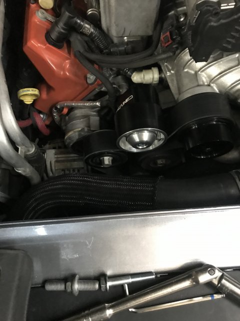

Think I’ll need a longer belt
I had to remove my catch can so I’ll have to either buy a new one for fender mount or figure out how to make mine work 0754D8D4-9F08-4A86-A61B-B6C4040F5293.jpeg

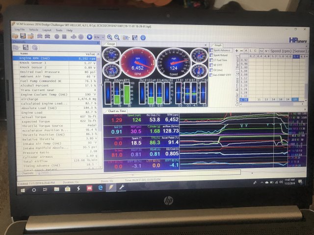

tested the flex fuel tonight added about 9 gallons of e85 (I tested this about two weeks ago it tested e70) what it was tonight I have no idea ,I logged earlier and from a 4th to 5th pull to redline I saw max 13.5 degrees of timing ,,alcohol% at 27 ON PUMP GAS curt said the percentage could be 10% or so off either way ,well after topping off with Ethanol I drove maybe 3 miles and it showed 57% I do a pull on the interstate and I was like I thought I filled up at Mapco not EXXON because guys im telling you theres a tiger in my tank o_O the cat roared !! I punched IT at 78 mph and the broke tires loose im like wtf ,,so I look down at the log hell its getting 18.5 degrees of timing and no knock retard I hit it again 18.5 degrees all the way thru redline from 4th to 5th no knock retard .OMG ITS FAST AS F=====:ROFLMAO: I COMPARED THE LOG AGAINST MY 9 .92 PASS TORQUE NUMBERS AND IT LOOKS BETTER AND ON THE 3.10 PUSHING RIGHT AT 15 PSI ,I WOULDNT BE SURPRISED IF THE CAR WOULDNT RUN HIGH 9S WITH THE 3.10 I can only imagine what it will do with the 2.65 ,,,,THIS CAT LOVES ITS CORN LOL
