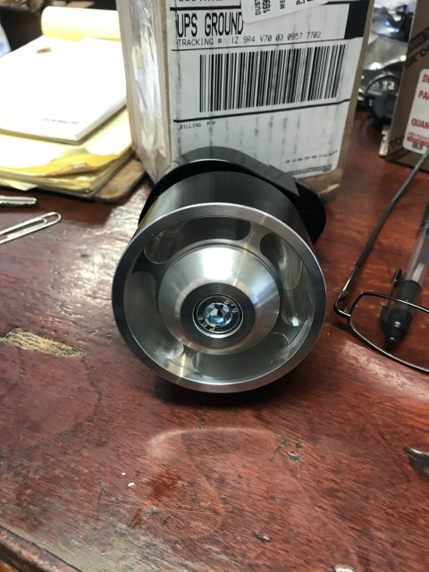

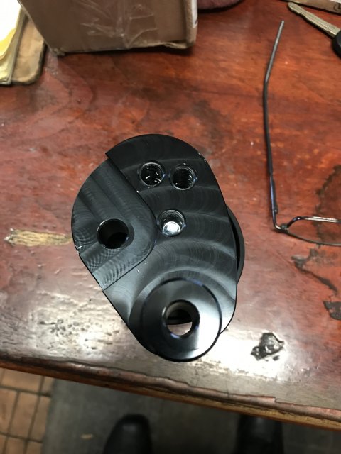

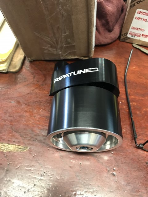

Thread Starter #428
Adjustable tba idler pulley came in today it’s purdy
