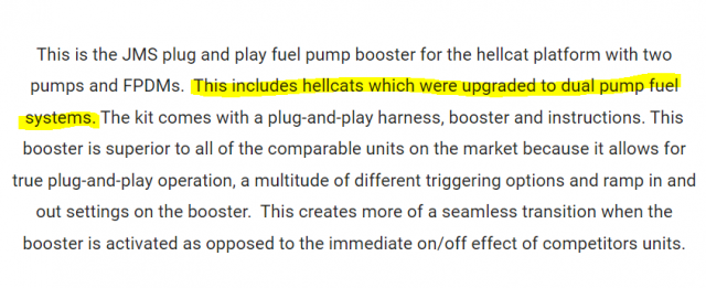

JMS says this is expected and a known issue with this type of drop in fuel system. They told me yours should not work so that could mean something isn't right on yours, or maybe mine's the one that's broken? I'm trying everything to get it to work so I don't have to ask Jon to take it back or I have to try to sell it or something if he can't. I wish this issue had been publicized since it was "known" according to JMS and the folks in the FB thread as well. Yet websites still advertise this as working with a dual drop in system.

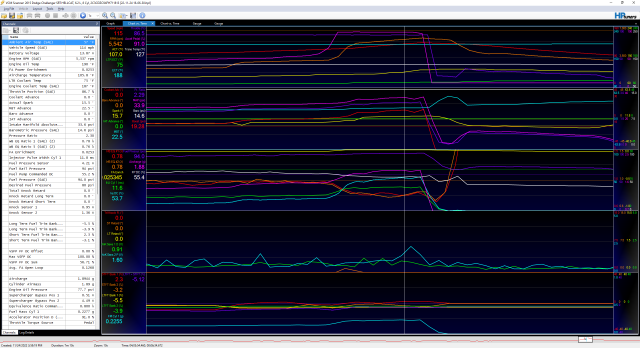

@16GoManGoHC2 you have several variables in that log that are way different from mine. Your commanded fuel pressure is 73 psi which has been lowered from 80psi stock and ID1700 injectors are giving you much overhead as well. You're still tickling over 13ms of inj pw and if the tune has stock settings for limits the bypass will open at 13.5ish so keep an eye there. I'd rather keep my fuel pressure up to at least 80psi if not higher on mine.
These things probably work fantastic on cars that came with two pumps from the factory like a Redeye/Demon/Trackhawk. I haven't found anyone else using one on a dual drop in system and with the 3rd pump add on costing like $300 (+ maybe a harness?) I can see why.

@Speedy! I've been down this path, unfortunately it's yeah run the BAP or upgrade to triples. For my experience when OST was tuning the car when it died at the 660, that was it. For reference here is a wot pull for me at ~20psi.
I am commanding 80psi but giving it 94psi, I should probably back that off at the regulator to 85psi (give it some head room). In some of my other tunes when I was running 104/93 mix it was commanding 94.3 to give it some head room. Since I've reset a lot of those tables that is an artifact. However my FP DC is barely up there. Plenty of room left and the injectors are barely sneezing. (This was a fifth gear pull, and I was only testing to make sure the trans was ready to rock n' roll).

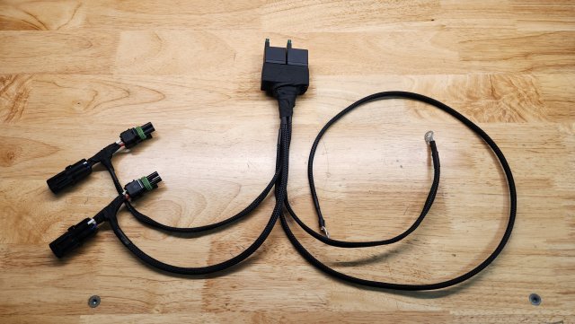

Anyway, hindsight is 20/20. Here's the harness I built and according to JMS fixes the issue. Lunch and then a test drive but to be honest I'm not confident this will work based on my previous testing. 20221203_134732.jpg

Pretty nice looking work for a engineer 😆

Anyway, hindsight is 20/20. Here's the harness I built and according to JMS fixes the issue. Lunch and then a test drive but to be honest I'm not confident this will work based on my previous testing. View attachment 88899
Nice harness, you cannot run the third pump off another fpcm, its not a thing. Thats when you would have to switch to the fc3 from fore. Imo if you are using a triple pump and the stock lines thats a bottle neck. -10an to a Y block then -8an to the rails. Still a dead head system so the only worry would be vapor lock.
