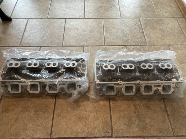

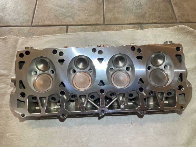

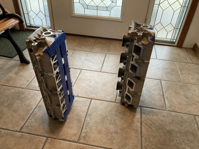

Time to get this party started!!
Only delay is going to have to let them warm up to room temperature before I put them on the block which is ready and waiting
99F93C98-9370-4F82-B0A3-42E9F1D5DD51.jpeg 15132498-4FEB-42B9-9EE3-9E540B80F31E.jpeg

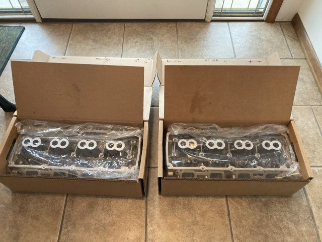

BEAUTIFUL WORK!!
80BB4F3F-3531-4A66-A1AA-85573ADAA334.jpeg 896597A2-2FB0-4204-923E-B40A3537306D.jpeg F581AC85-9772-48BB-A228-91DC5DDC03DB.jpeg 57D78939-F702-411B-BA34-3378FC43CAFE.jpeg E78C23EE-CE71-4B67-9B71-D4CDC0ED6582.jpeg 36FD1E6C-7FB4-4A8C-9F71-CD40D4C3C269.jpeg 214359B3-9A55-44BF-9741-E82C36351DDC.jpeg 49689053-DD25-4A88-A09F-1E434037119E.jpeg 3E260176-27D8-45B8-917C-92080A0CF912.jpeg 71C0D507-E119-4A30-829F-F74EEC7D3E6C.jpeg

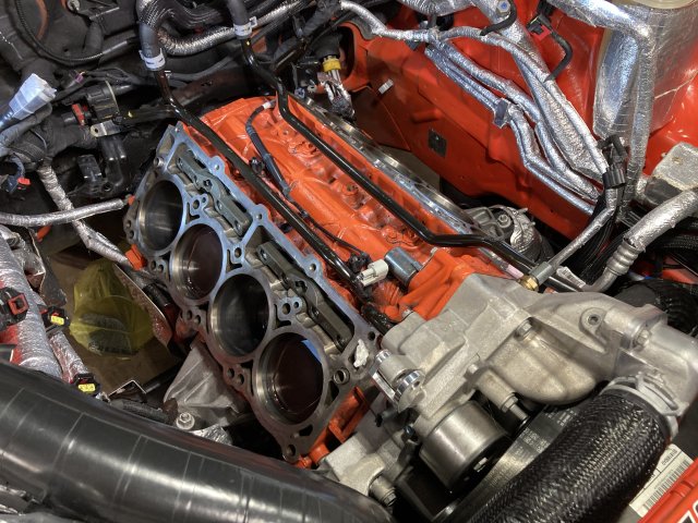

Just got done torquing, 125 ft lbs twice I’m sweating lol

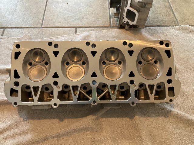

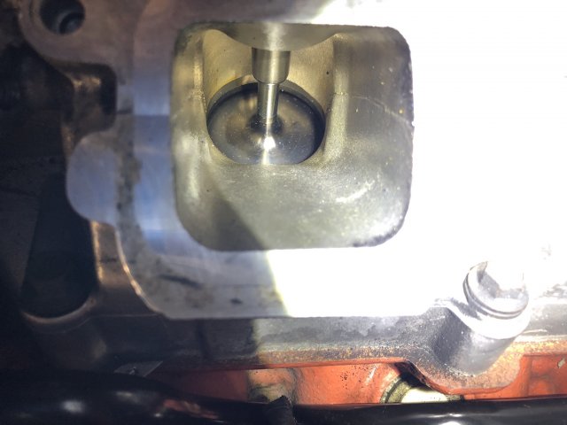

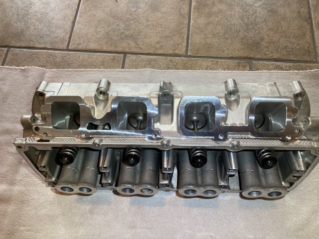

Really no need to measure, you can tell by eye the difference!!

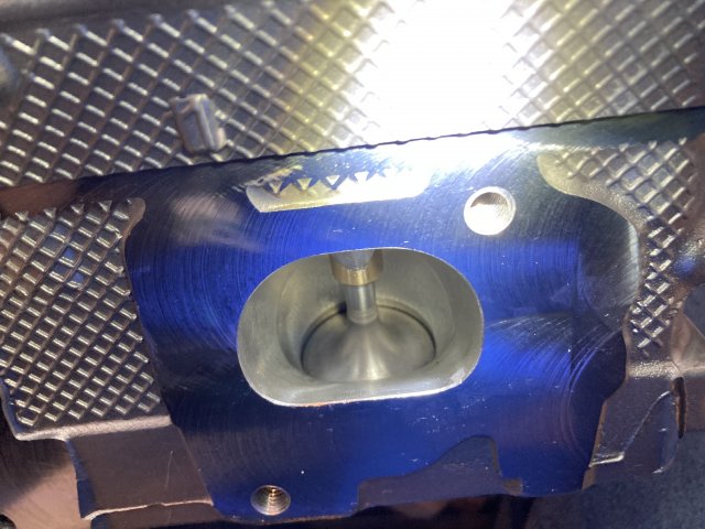

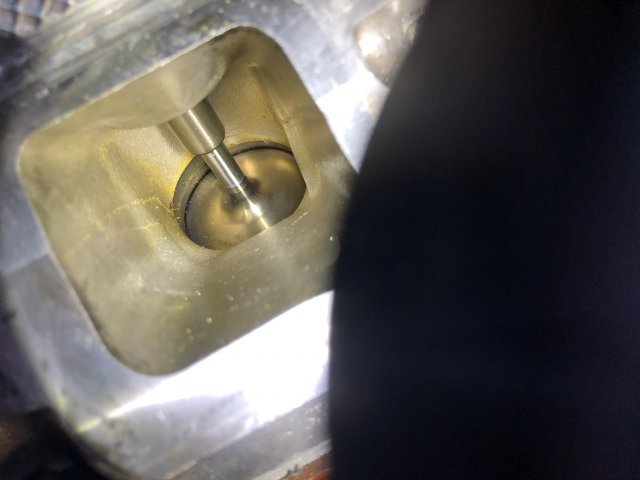

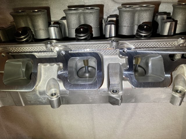

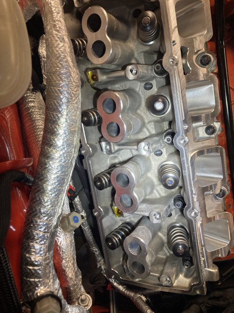

Before
ED5CAA13-4556-4C7A-9AB2-022C7F4833D8.jpeg 97E34FC1-C488-47AC-AE27-5D3FC8701B26.jpeg
After, ie now
The pocket above the valve is about the same size as the valve now!!
Replaced valve guides and all. Silicon Bronze valve guides, 5 angle valve job, back cut on the valves, TOP SHELF PRO work here no doubt. NICE work THITEK Craig!!

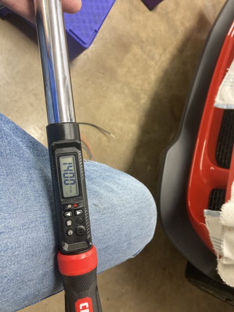

Are you able to put studs in then the head or do you have to set the head on then put studs in?
3,752
8,909
Thread Starter #1,292
Put 2 small studs in the top for alignment help and set head in place then put the studs in, they have hex sockets in the ends so pretty easy and quick. Did a final Tq to 140 from recommendation from @Hatermkr per AJ I believe as that’s where the studs came from. Will hit them again once more before putting valve train on.

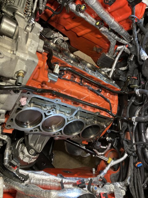

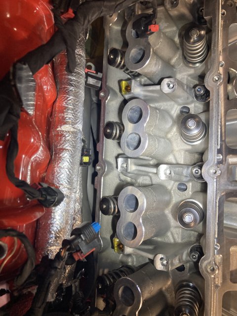

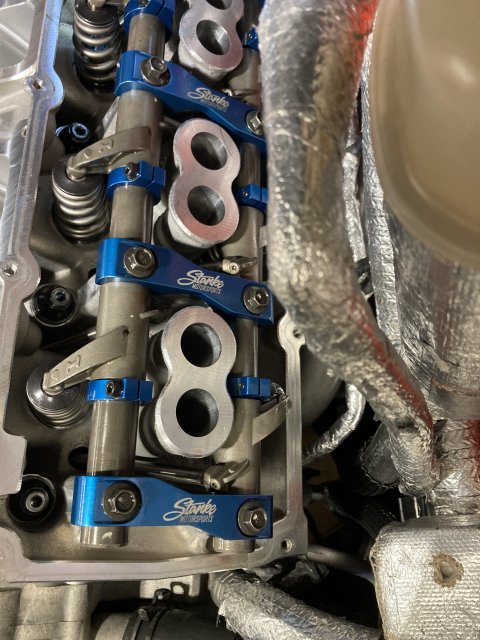

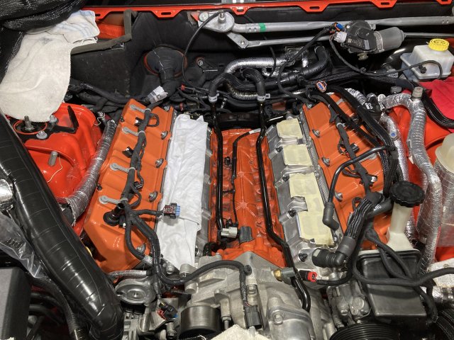

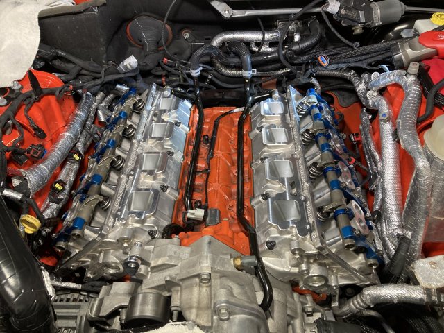

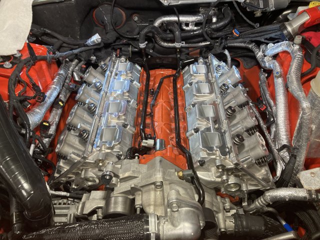

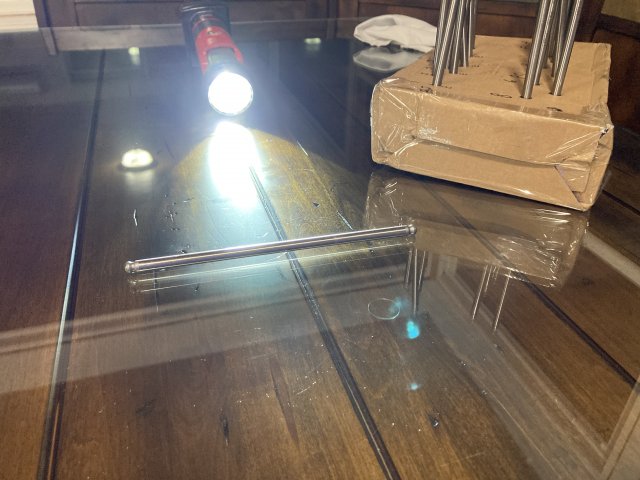

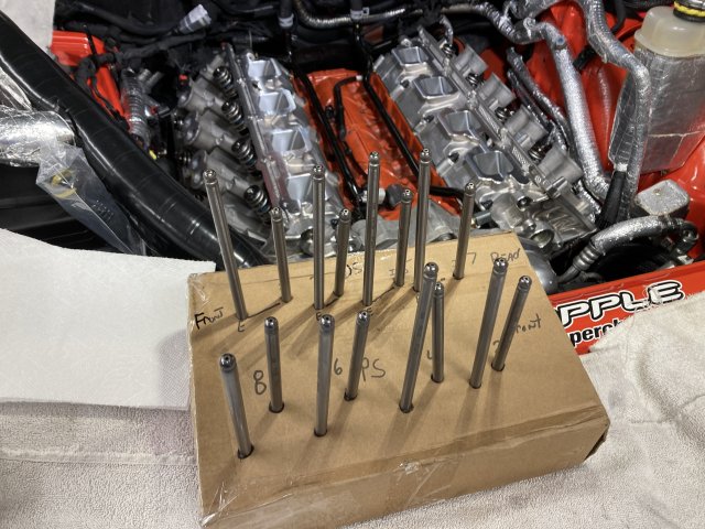

Doing the heads in the car was no fun. I chose to not put the exhaust manifolds on before putting the heads on to save weight and be able to land them exactly on the dowels without touching anything. Well that worked, getting the driver side header on pretty easy but the passenger side was a REAL BITCH!! Yesterday was pretty much consumed by putting the headers on and the exhaust system on and then last night came the valve train, checked all the pushrods for straightness, all good, set the clearance on the STANKIE valve train stabilizers and then the valve covers and filled her with cheap 0w40 PUP for startup and flush. Also bled the oil system and made sure fresh clean oil was up to the valve train. Today is more fun work up too only I’m hoping lol. my plans are to just fill the coolant system with straight distilled water. Start it up let it heat up and then dump it through the block drains and the radiator drain to get any oily crap out of the coolant system and then fill it with Mopar purple stuff in maybe take it for a hit.
A2E5D1C4-1760-4938-AB4C-F1581C888EA1.jpeg 28A7672C-43F4-4E39-8492-FF6A1E184F20.jpeg BCC5B096-A786-4A1F-83D1-35A5264253B7.jpeg 90916EE9-FF38-443D-BCAD-D5050856E69D.jpeg 38AD04E7-B5F0-47B9-956A-4E5933DA6B88.jpeg
See the oil on the 2 rocker stands each side? That’s what oils the top end.

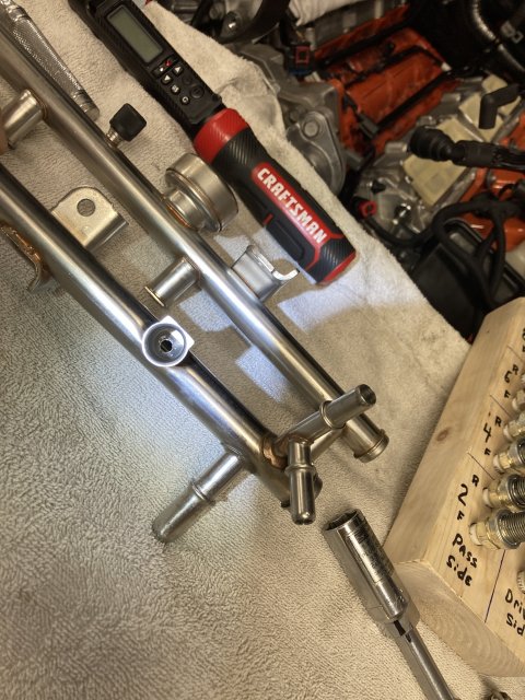

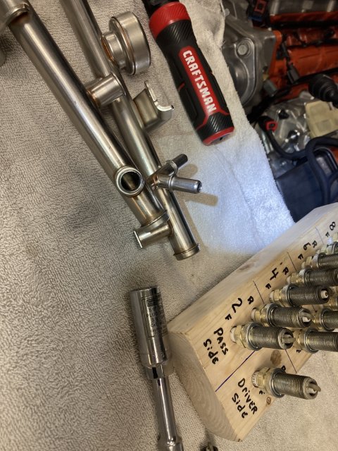

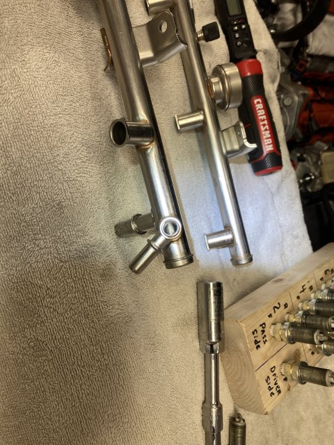

Any reason you have not switched to redeye fuel rails?
I dont like the idea of cutting up $300 fuel rails.

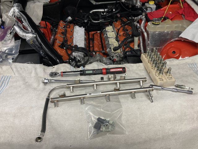

Will be putting on ported Redeye Fuel Rails this time around!! We’ll see if they help with fuel delivery or not compared to ported regular Hellcat fuel rails or not.
Ported out sizes match what was done with regular HC rails

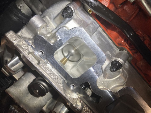

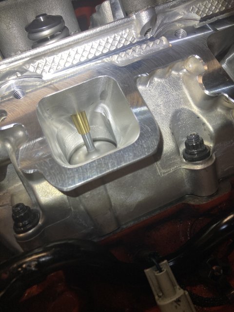

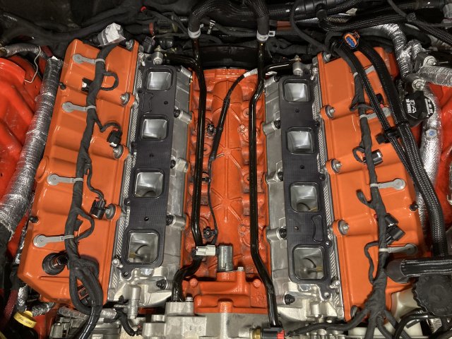

Well in test fitting the blower insulator plates I found out how far opened up the inlet of each intake port is, about a mm or more per side had to be milled out of them.
658C75F3-266F-45CD-9DAD-DF571C833358.jpeg B8D26C66-B2E5-4B16-A3A5-7E32578E2A91.jpeg
It’s ready to put the 2.4 blower back on, I have to remove the Whipple hoses so tomorrow comes playing with my favorite, antifreeze :(
