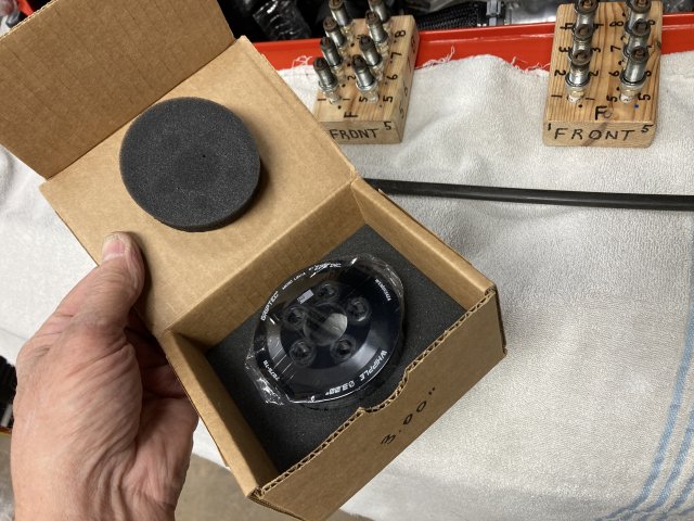

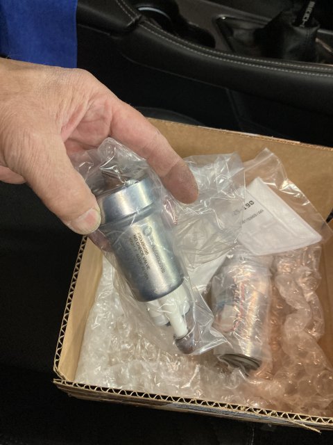

Speaking of fuel system, new fuel pumps arrived today.
Along with a 3.00 pulley a buddy of mine sent me and that bracket from Nitrous Outlet for the insulator spacers. On Sunday!!
7B7C394D-F95B-4E70-978E-ED7CAE3C79D7.jpeg C72E9318-E909-48CD-BD24-72D1D0512349.jpeg

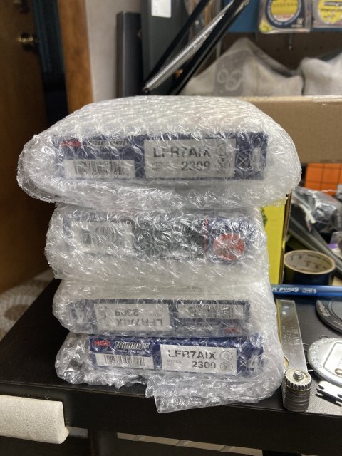

And 16 new plugs too!! :)
With any luck should be running by next weekend. I plan on insulating the coolant lines right to the inlets on the blower, rather not cosmetic wise but they need to be for maximum cooling.

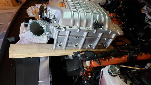

If I had to lift it off by hand with 2 people for the sake of protecting my car I’d sling it just like I did but instead of attaching to the engine hoist if you don’t have one substitute a 2x4x8ft for the hoist hook and lift it that way one guy on each end up and out, easy peasy. To try and lean over the car from each side and lift and walk it out the front is asking for disaster even if it’s just a elbow dent in a fender that’s too much!!!

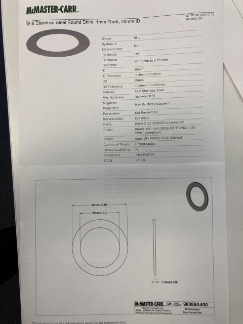

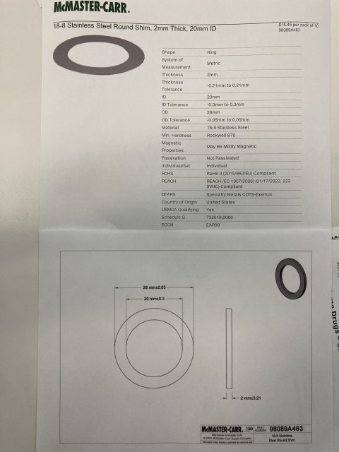

Those spacers for behind Litens pulleys, McMaster #’s below
F5C2E718-3CDA-4A84-884B-B989C2B16B28.jpeg C46D63F5-ED67-4805-93D7-26C2D7902C70.jpeg 5C1924D3-FAA6-45CF-8C10-442CD461E9E9.jpeg

Being serious, they are just over 100lbs.
The trick for me was to lift up the front enough to get some short sections of 3/4" hardwood pieces underneath the front of blower and raise it up, then I could rock the rear up and get more sections of hardwood under the rear.
That got it up above the pins.
Then I was able to slide it forward on 2*4s.
Like so...
Then it wasn't so far away and I was able to lift it, pivot around, and immediately set it down on a table behind me.
