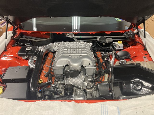

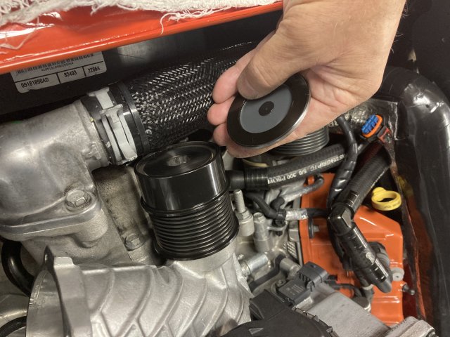

Disassembly begins!!

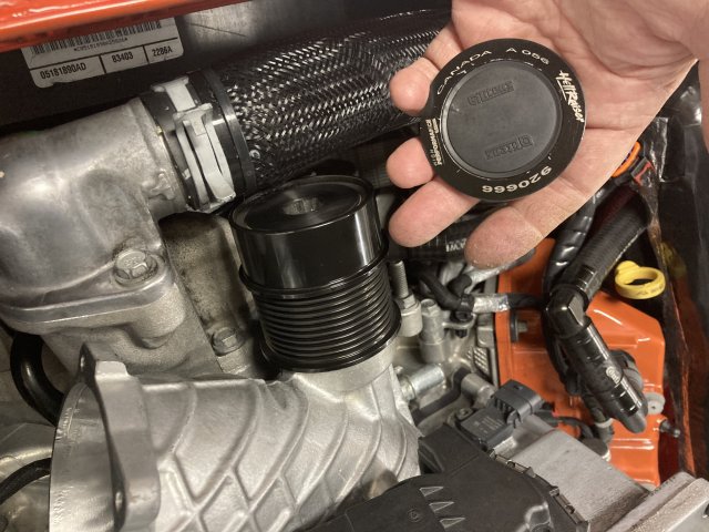

Found the pulley front right below the crank pulley, looks like it is just rtv’d in place?? Pulley still clutches fine, blower feels and looks perfect, belt is greased so that was probably the boost loss, I could have probably kept running the other night. Needless to say it’s coming off, probably today.
96FCD42E-1C13-4469-AA93-2E7BD9DDB27C.jpeg EFCD3464-0336-467F-9C11-35223E1053BC.jpeg
I’m planning on using the insulator spacers even though a couple guys with the Whipples (those going mid 8’s) say their not needed and don’t use them but how can they be of hurt? I would think they would help keep heat from the blower base? I ordered the longer bolt kit and special front bracket needed that Nitrous outlet sells to use with their spray plates in case I decide to use them.

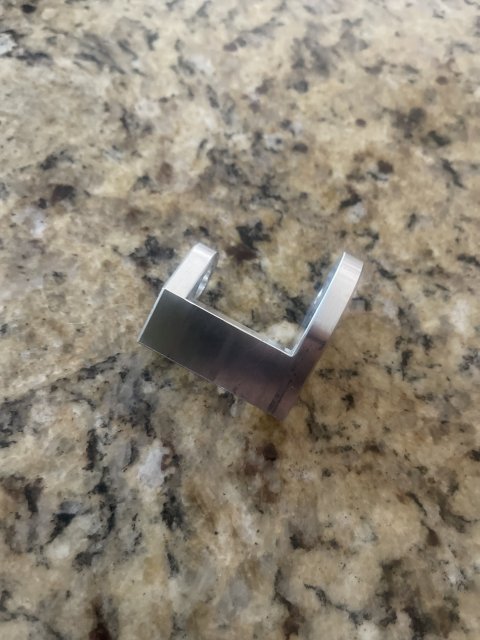

Bracket is for front support of Whipple to water pump, need a different bracket if putting spacers under the Whipple such as the Nitrous plates or in my case insulator plates. I have to make sure the O-rings will have the right places to seal too on the bottom of the Whipple to decide if I’m going to use them or not

You will have to take picture of that on. Does the whipple come with a bracket then for mounting?
Yes, but the bracket they send only works with no spacers and gaskets they send. This bracket was $50 plus $13 shipping 🤦🏼‍♂️

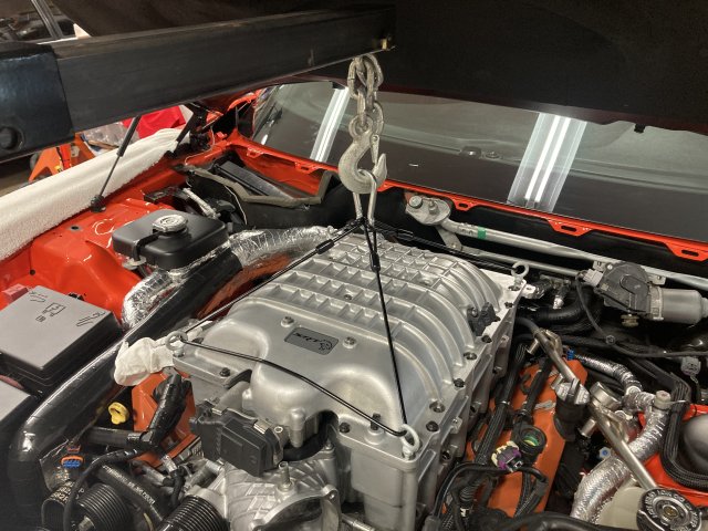

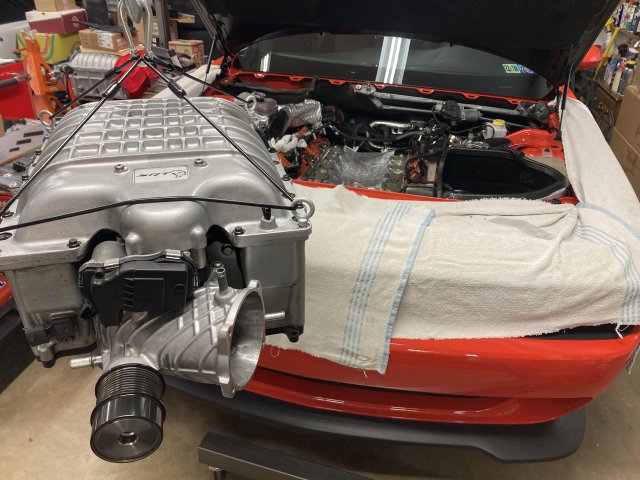

Blowers off :)

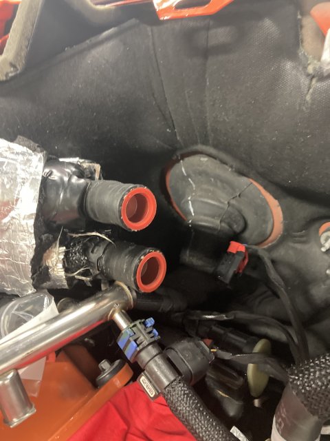

Having the proper size plugs and caps in hand at time of hose separation keep messes and fluid loss to a minimum. Devised a quicker cheaper way of lifting the blower instead of making a plate to lift from the center of the lid which I never was too keen about, these M6 forged lifting eyes screw into the blower body, rated at 750 lbs each they won’t break.

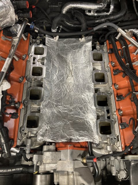

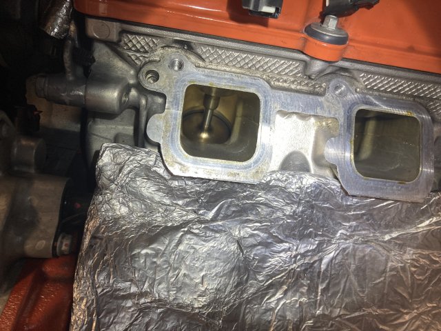

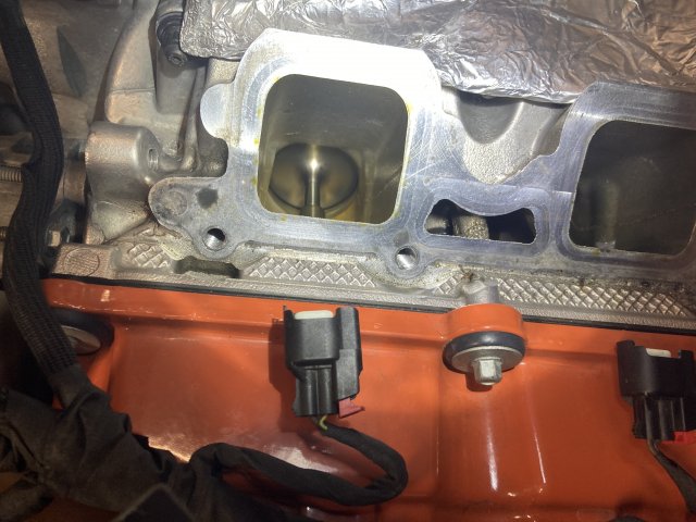

I think about 3500 miles on engine now, valves pretty clean yet, benefit's of running a good catch can!!
9B828E85-7067-4892-9679-1618CA44EDEC.jpeg C3EEBC62-228A-46D5-8450-61F26C7E0D1B.jpeg E5105467-CF36-4391-8835-5D21109B19AE.jpeg B92C2A9F-BCA2-481B-BA08-EAA3931D0168.jpeg
I will keep this valley insulator blanket in place when I put the Whipple on but no blanket stuck on the bottom of the Whipple I don’t think, still pondering on that one .

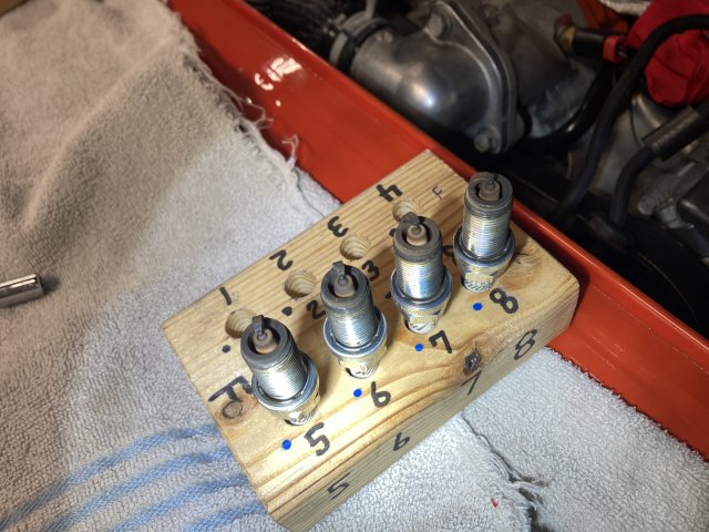

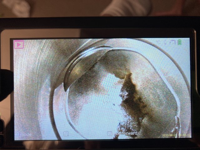

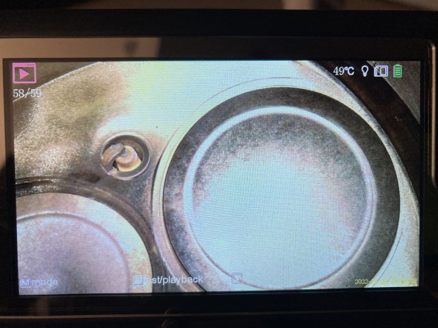

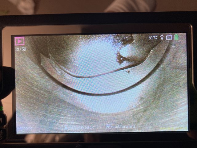

Coil packs off, 1 plug out of each cylinder, ready for bore scope then leak down test. Notice the MMT staining from just 1/2 tank of fuel with 1/2 qt of Octanium Unleaded last fall never cleaned off the plugs, it’s the same every where else it collects, only one thing removes it, abrasive cleaning. Glad I’m on clean corn now!!
ACB4E9F8-03A6-44BE-9688-CC233ACF4C4D.jpeg 4CD70558-10CA-497C-85E8-1A4863C793F2.jpeg
4,385
10,906
I think you just want an excuse to play with the New bore scope
3,752
8,909
Thread Starter #934
No, you all know me, I gots to know!!

Not needed, I lifted it off with one hand.

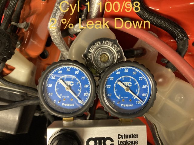

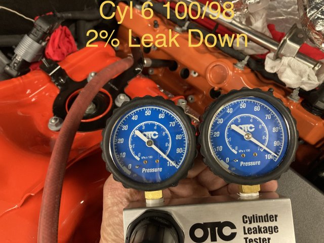

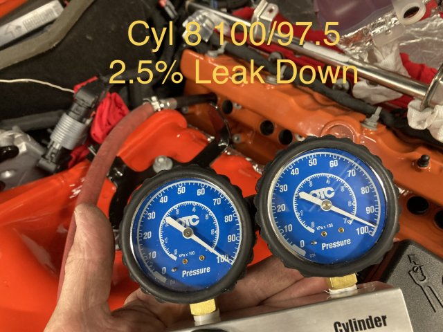

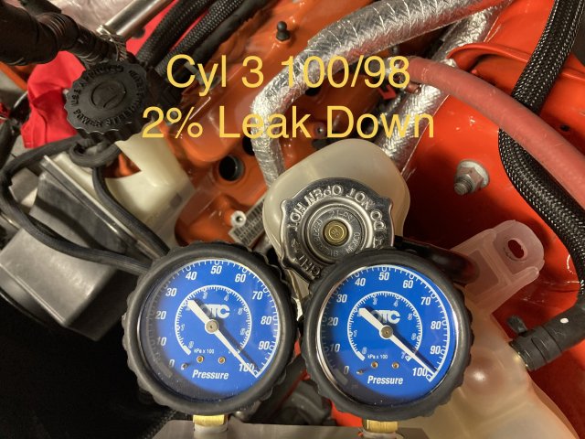

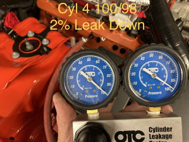

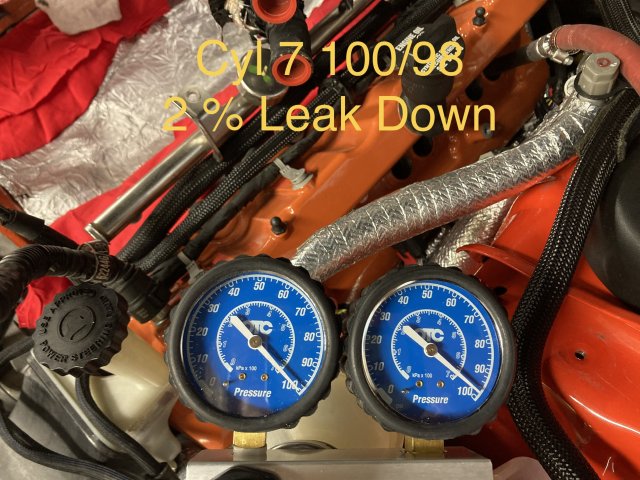

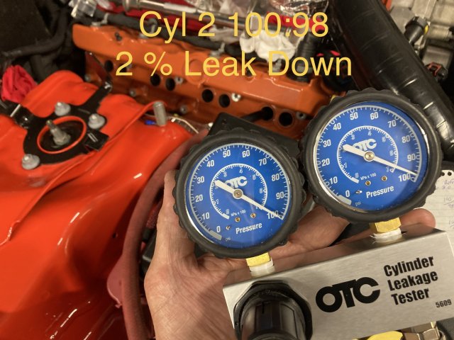

Leak down test says PROCEED :)
Very good for a stone cold engine with big ring gaps. Actually gotten better since the last test 1000 miles ago, I think she’s fully seated in now, 3800 miles since the rebuild.

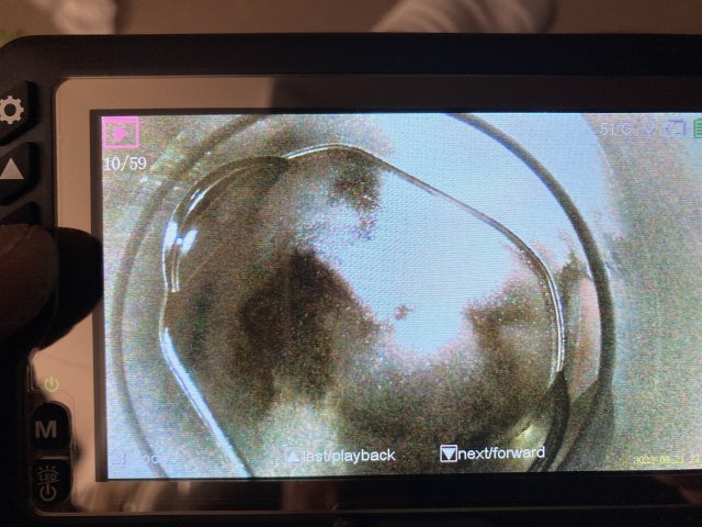

5D4B4813-9104-41D8-8DBE-252048C255B8.jpeg EDB02C46-1A29-40B1-8C2E-0984CBEB1708.jpeg 2E8530EA-B1C9-4613-9551-5DA1BCB09E1D.jpeg 9537A447-9772-4D83-857B-F1F0B183000D.jpeg 2B3EC9E3-3ED4-4CDA-A975-6A3A5D56F24D.jpeg D36A751F-AE61-44FA-A0E0-DCC5A9F891E8.jpeg 0ADC50E9-C0DB-4458-B56B-4965BE7920B8.jpeg 21A498F0-7F0A-4E6D-AA7C-DD4297B5E6E6.jpeg E60DDCF6-CF76-45FB-9053-D87057ADEE13.jpeg

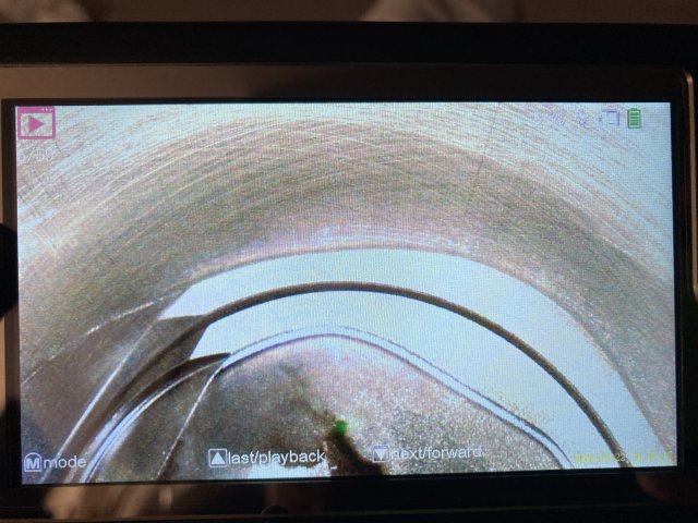

All the cylinders looked like this, clean and perfectly broke in. Happy to see this!!
