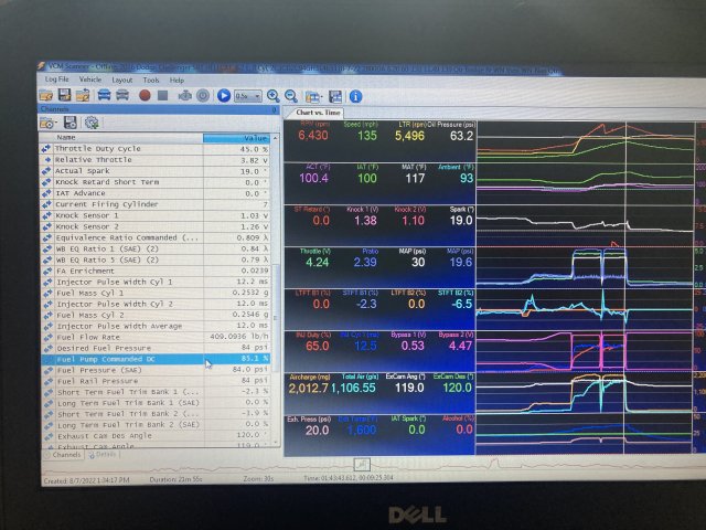

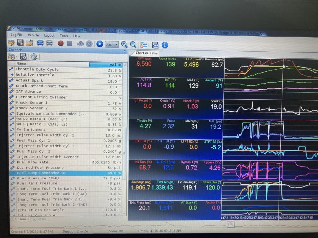

Tell me more about the conditions that were true for this picture? (Before I say something stupid....) :unsure:
i.e., Was this cruising steady state to get a an IAT of 66F???
Yes, cruising to the test bridge from home the long way, about 2 miles, that picture taken in third gear going up hill accelerating part throttle. Did a 60-130 hit across the bridge, coasted to the end and off the ramp, turned around which took less then a minute off and back on the bridge and did a 1/4 pull the return direction. Here’s HPT data and temps at the end of each pull, not bad in 93F ambient. By the time I got back home, 2 miles, chilled water temp back in the 40’s and IAT’s below ambient again ready for another hit. This while cabin AC on not in drag mode KC only, too hot for that shit!!
7304C94D-CAA8-4832-9AFC-43FF11CAE75C.jpeg C4A3A616-9662-47B3-9D7A-ABD8B30E0569.jpeg
This answer your question?

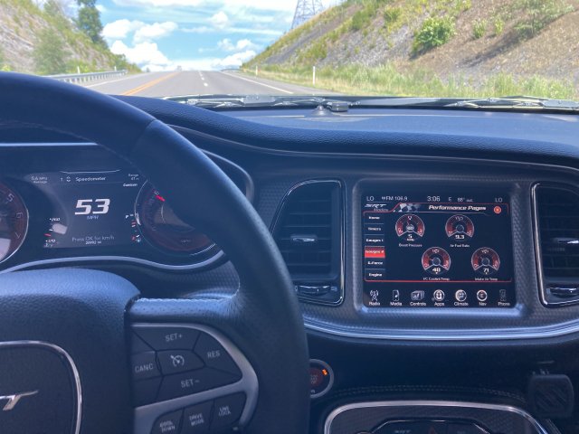

Here’s another picture day prior about same ambient cruising for another test run

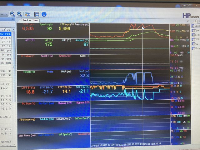

Here’s a gent I’ve been helping same upper and lower as me M6 with no chiller. BIG difference in IAT aye with no chiller
CA8A09C3-F9A5-465F-B7BE-6C4CF988BF0A.jpeg !!

His blower will melt.
175 is where overtemp kicks in on mine.
I was this guy last year. I did the BMR icebox for this year. I'm always watching my IAT on street hits.
Like my V...I believe if I weren't running E85 I'd have lost the motor long ago.
A chiller is my next "power" move. 100%. Unless something else takes a dump first.

Yeah, you maxed out your duals like I have, its not a good place to be in, whats your inj duty cycle look like?
Inj DC there on the log as well in pictures, usually stays under 70%, I’ve got a bit of head room yet there. I’m running dual 285 pumps atm, have new inlet filters on the way, if they don’t get me head room back stepping up to dual 295’s will. This will keep me until I go Whipple someday.

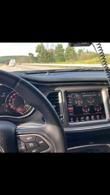

Here’s “steady state” cruise on the highway at 80. Chilled water temp below freezing and IAT below ambient. IAT depends allot on boost and load.
My car very seldom sees “steady state” cruising, it sees more bruising and running hard!!
