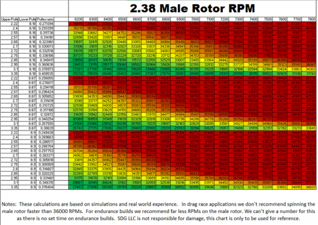

SDG just posted the rotor speed with different pulleys set up on their facebook page this weekend. Shows green to red in speed

They did both blowers also 2.7 and 2.4
We have a thread on that. I will add it to that thread

Mine has been in the red…. When I bought it one of the shift points was at 6800. I wonder how long my blower will last. I have been debating if it’ll be best just to get a whipple. Or send it out for a blower plate and have it inspected. Unsure. Seeing those charts are scary. But mooo powa!! Spin it to win it!

My gut says it's cumulative. Spin it hard a few times and probably no big deal, but repeatedly and things start to go south. I also wonder how things like billet bearing plates and ported snouts effect the chart data.
Neither should be you are still spinning it that many rpms

I'm reading it's a combination of RPM + Heat. More air = more pressure = more heat.
