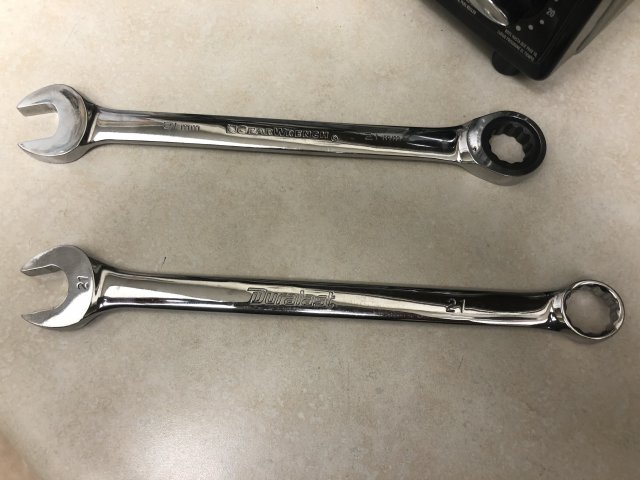

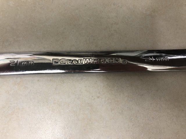

I can take a pic if needed but I bought it at NAPA auto parts here local.
It's not a pivoting head, it's a straight wrench. I have a regular combination 21mm wrench to brake the bolts loose then I put the ratchet one to work.
The wrench will not get trapped if you take out the vertical bolts first so you can slide the diff forward as you loosen the horizonal bolts.
Obviously the DS has to be off at the diff to slide it forward. ( on a floor jack )
Just measure the head thickness if it's not troublesome.
The one I linked is 1/2" thick
5,205
9,661
The name on it is "Gear Wrench" from NAPA auto.
The regular one is Duralast from Auto Zone.
5,205
9,661
Yes it is 1/2" also.
