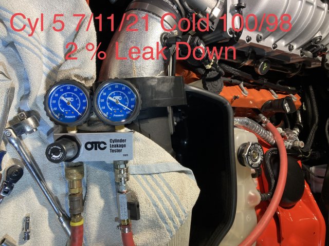

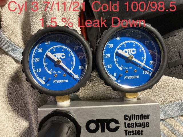

Thread Starter #454

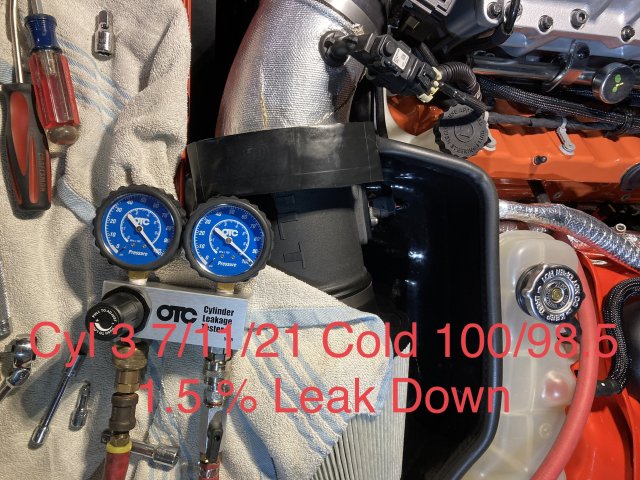

So today being it was supposed to rain and it didn’t LOL so I did a leak down test on cylinders that were easy to get to which was 3, 5 and 7, 7 was the problem child that lead to this rebuild had to be honed the most due to a hair of heat distortion ( honed out only .0025” to get perfectly round and no taper) and became the target cylinder for the rest, it only has 1 1/2 % leak down at the moment I think that’s pretty damn good for gapped style rings COLD and less then 75 miles of run time!! Plateau honing and 3F81BFE9-8355-479D-9840-166AE057CE6C.jpeg E1684520-0FAC-48BF-8D73-CEF0CBF37555.jpeg 7AFD27B3-0B95-4B95-A2D3-F36CA28F2E19.jpeg DC4127AB-49F8-41B5-8D50-1B095305EBF6.jpeg 253DDDDB-7FBC-436B-B031-09C13419B538.jpeg 8BDD4AA9-DFEC-482E-91EF-F8B2BDF45B62.jpeg A7C50A69-B48E-4862-B4EF-FFF87A0611CE.jpeg F14B9D08-A7CB-464C-AE49-AC83576FDFD1.jpeg 04BD243B-1BDB-4ECB-AD8B-D7FD34A758E1.jpeg AF67B725-3274-4862-A66C-76D2D1BD6775.jpeg 3C908EB6-07D3-47F9-BB8B-8C6374C30828.jpeg 1BF1DB63-F386-4CAB-893D-FF763FC77CC0.jpeg ADABDFC5-1E68-4616-A398-371F3862A85A.jpeg 43FAACA7-CB8A-4F44-8190-1FDD671458E2.jpeg Quick Seat worked well together it looks like. Notice heat band on ground strap right about at the halfway point, perfect!!

So today being it was supposed to rain and it didn’t LOL so I did a leak down test on cylinders that were easy to get to which was 3, 5 and 7, 7 was the problem child that lead to this rebuild had to be honed the most due to a hair of heat distortion ( honed out only .0025” to get perfectly round and no taper) and became the target cylinder for the rest, it only has 1 1/2 % leak down at the moment I think that’s pretty damn good for gapped style rings COLD and less then 75 miles of run time!! Plateau honing and View attachment 48877 View attachment 48878 View attachment 48879 View attachment 48880 View attachment 48881 View attachment 48882 View attachment 48883 View attachment 48884 View attachment 48885 View attachment 48886 View attachment 48887 View attachment 48888 View attachment 48889 View attachment 48890 Quick Seat worked well together it looks like. Notice heat band on ground strap right about at the halfway point, perfect!!
Good results, she's healthy !
