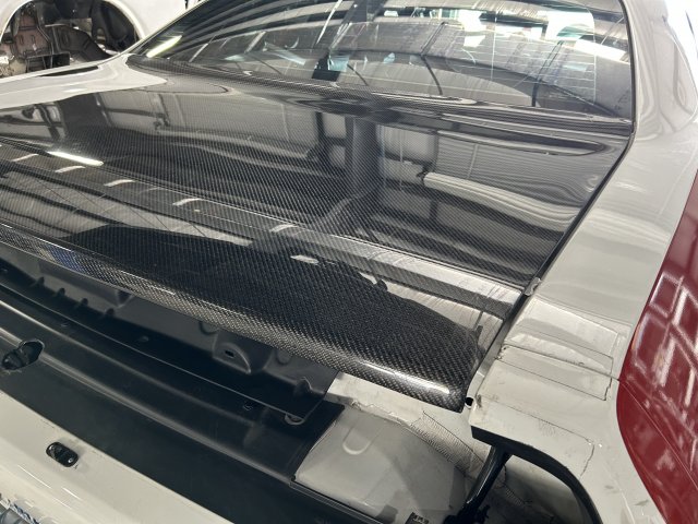

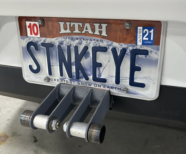

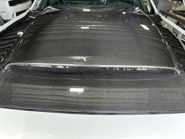

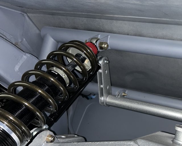

Waiting on some pics of the rear/ladder bar from under the car. It’s complete and the drive line is finished. Dual chute anchor is in place. It’s rolling on the wheels now. Fuel cell and rear vented catch tank are being mounted and fuel system being put in place. The new carbon fiber deck and wing will cover it up and…... finished 👊. Latest pictures I have with more soon. IMG_5014.jpeg IMG_5015.jpeg IMG_5018.jpeg IMG_5019.jpeg

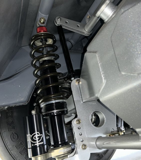

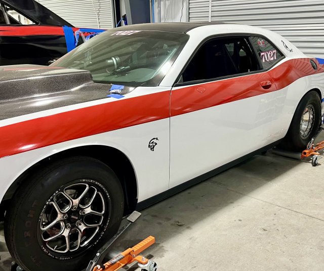

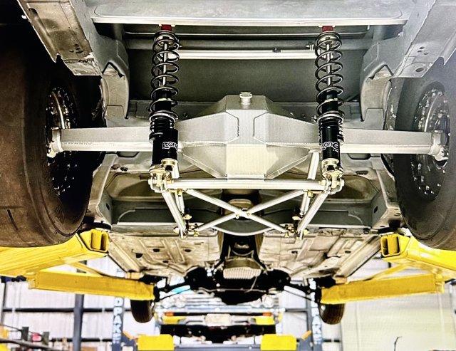

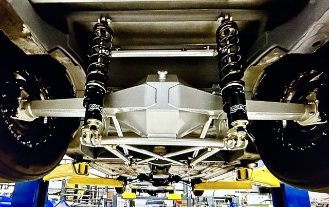

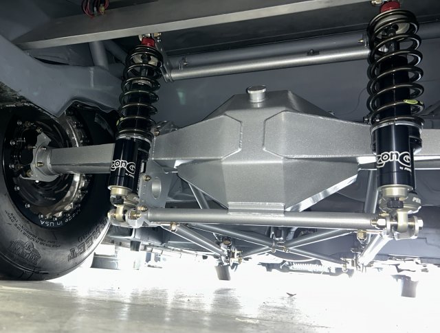

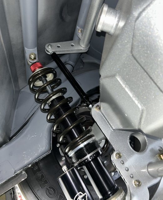

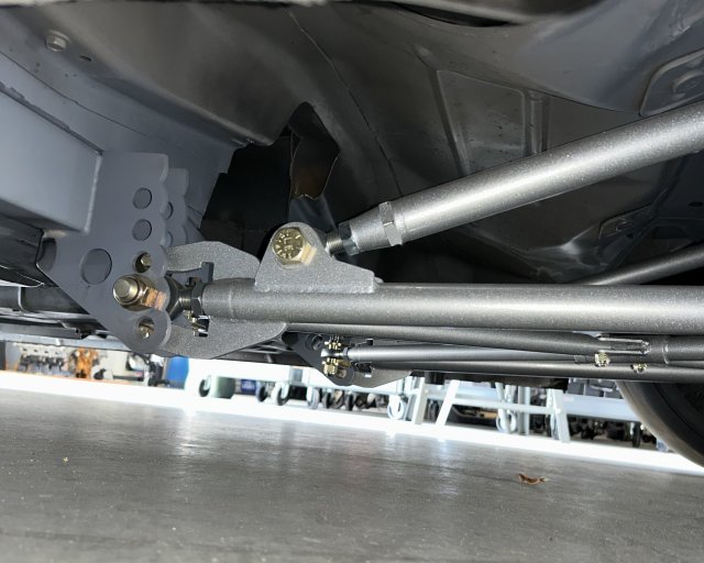

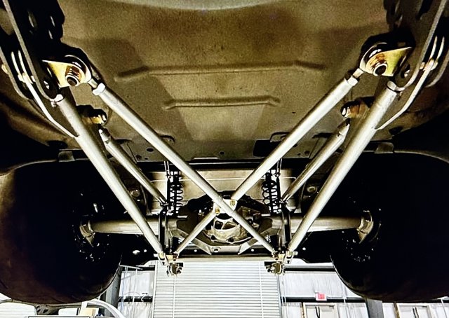

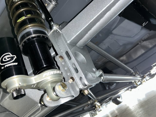

Back on the lift so we could get some pics of the finished rear from underneath…. 👊 IMG_7336.jpeg IMG_7337.jpeg IMG_7338.jpeg IMG_7339.jpeg
8,694
7,652
Looks beautiful!
18,724
98,695
Looks. Like she’ll go straight.
That’s going to be nice. At this point.. straight is good. Front wheels on the track instead of in the air is even gooder

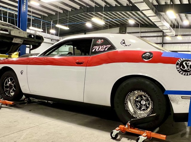

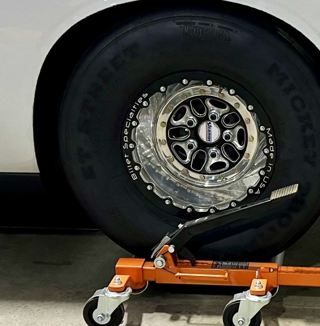

Something’s happening 🫣 IMG_3391.jpeg IMG_3392.jpeg IMG_3394.jpeg IMG_3397.jpeg
4,117
10,340
Who will make a pass first? You or me :)

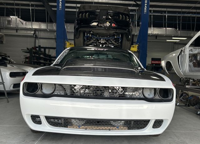

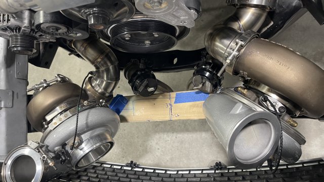

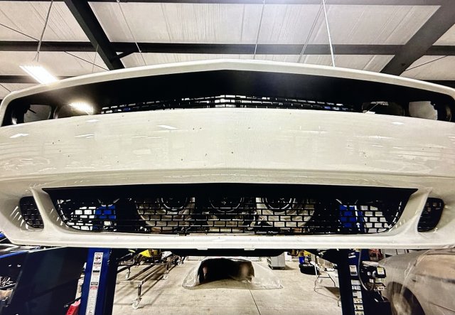

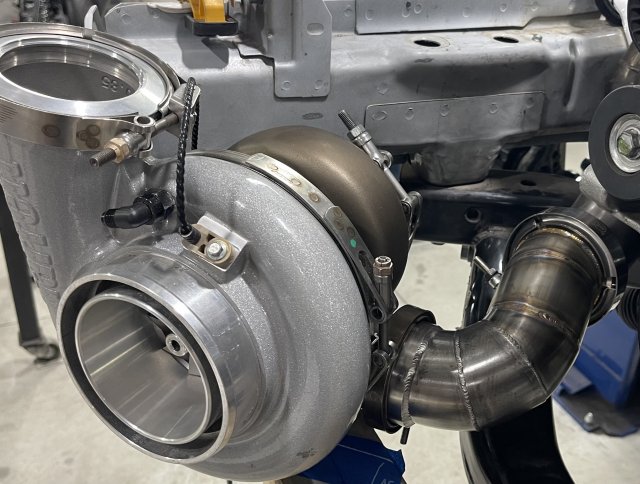

Headway 😊. IMG_7395.jpeg IMG_7393.jpeg IMG_7392.jpeg IMG_3472.jpeg IMG_3450.jpeg IMG_3460.jpeg IMG_7396.jpeg

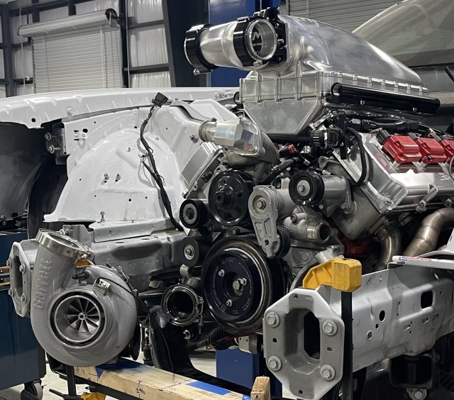

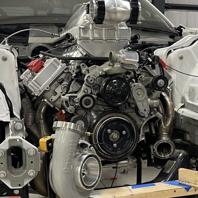

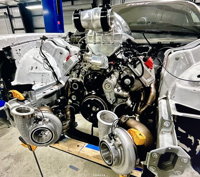

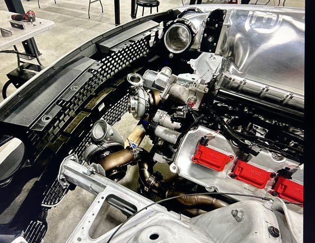

Car’s back in Utah for the new motor and some finish-up work. Need to complete the new fuel system for Methanol and some additional electrical. I finally get to get back to hands-on 🤗 Florida sure is nice. The drive back and forth… sucks IMG_7520.jpeg IMG_7517.jpeg IMG_7519.jpeg IMG_7518.jpeg IMG_7500.jpeg IMG_7502.jpeg IMG_7503.jpeg IMG_7504.jpeg IMG_7507.jpeg IMG_7508.jpeg IMG_7509.jpeg IMG_7512.jpeg IMG_7511.jpeg IMG_7513.jpeg IMG_7514.jpeg

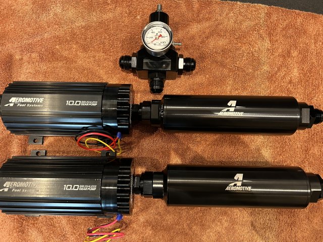

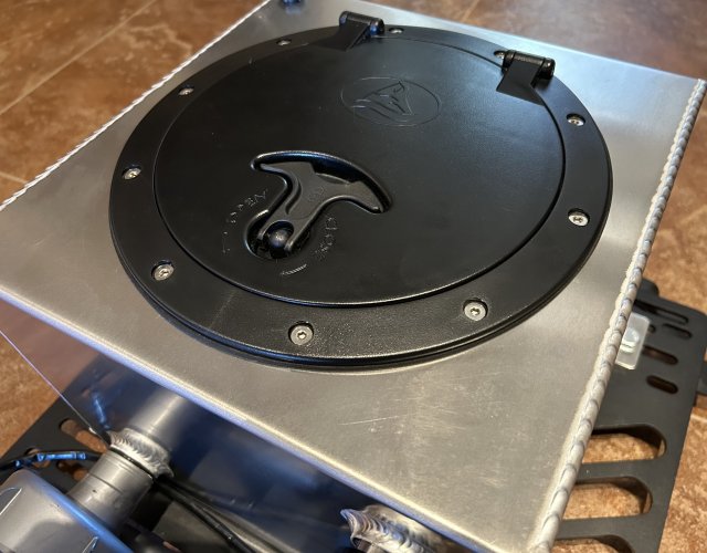

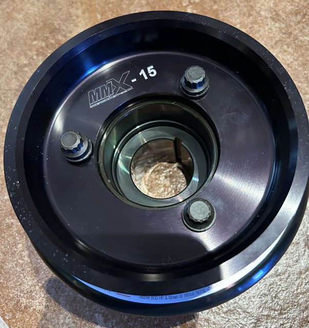

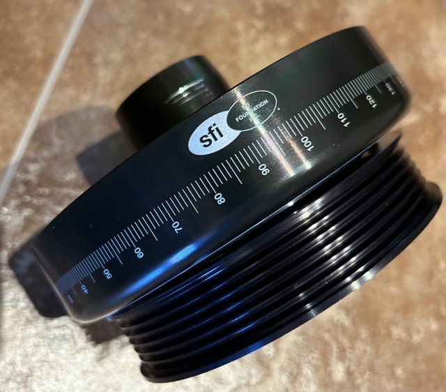

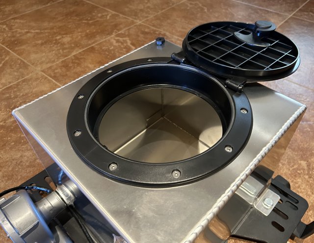

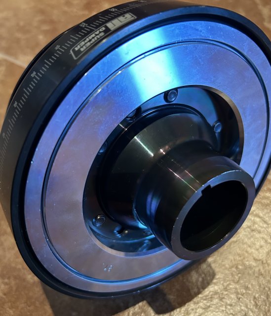

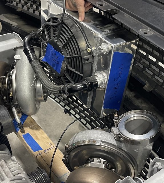

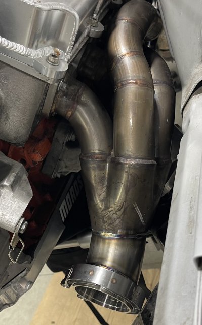

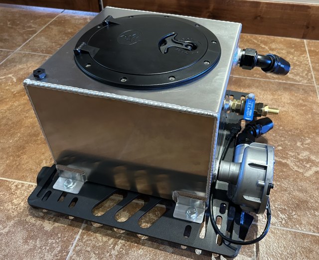

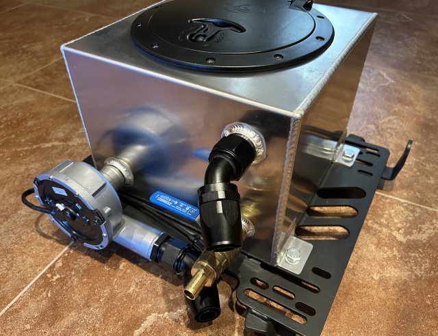

So…what’s up you ask. Is that thing ever going to run? Sometimes it doesn’t seem like it but yes… progress is being made. Back home from Florida with its beautiful Redeye Racecars Rear and now… it’s in California getting some additional work on the cage, including a fresh 7.50 cert. I could have had Redeye Racecars do that but Carlin Fabrication did the cage and they get credit for it, so nobody else can work on it. While there, we will be fabricating a unique dual chute setup that is going to be different than what’s common. They will look like they’re floating 😳. So in the mean time…. I finally got my ice box and been getting it ready to install. A 5 gallon PNR with my old DC pump. It’s mounted on a PLM seat base (same as my drivers seat) and will ride shotgun with the hoses passing through the firewall. The other thing I picked up recently is a new harmonic damper. ATI as before but without the supercharger pulley and with a 15% underdrive alternator pulley. Saves 5 lbs off the weight of the supercharger version I’ve been running. Pics… 😎 IMG_7560.jpeg IMG_7561.jpeg IMG_7562.jpeg IMG_7563.jpeg IMG_7564.jpeg IMG_7567.jpeg IMG_7566.jpeg IMG_7565.jpeg IMG_7568.jpeg
4,117
10,340
That underdrive is worth its weight in gold for a turbo car. That’s also a serious ice box! Awesome setup.
