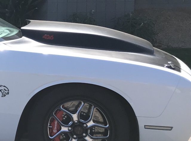

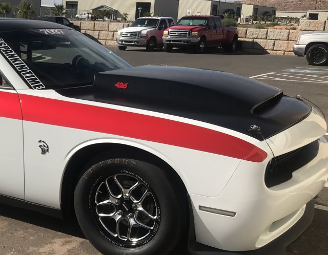

The ladder bar rear is done with the anti roll finished yesterday. It all goes to powder coat next week. Custom coil overs and Strange 40 spline axles are ordered. The fuel cell placement and tin work starts next week. The new 14” wing is being fab’d and the latest decision is to replace the hood and deck lid with Anderson CF. Redeye Racecars is a Anderson Composites dealer now, so we’ll be sporting some of their stuff. So…. Anybody want my cowel hood? It’s the fiberglass version that was sold by Kenne Bell. While off the car and being stored in my trailer… it fell over and suffered a couple minor skuff marks to the mat black wrap. Could be just touched up if you’re not particular. Otherwise it will need to be re-wrapped. $400 with the Mopar hood pins included. It’s at the shop in Vero Beach now. I’ll do a separate ad on that shortly. IMG_0805.jpeg IMG_1516.jpeg IMG_4251.jpeg

The ladder bar rear is done with the anti roll finished yesterday. It all goes to powder coat next week. Custom coil overs and Strange 40 spline axles are ordered. The fuel cell placement and tin work starts next week. The new 14” wing is being fab’d and the latest decision is to replace the hood and deck lid with Anderson CF. Redeye Racecars is a Anderson Composites dealer now, so we’ll be sporting some of their stuff. So…. Anybody want my cowel hood? It’s the fiberglass version that was sold by Kenne Bell. While off the car and being stored in my trailer… it fell over and suffered a couple minor skuff marks to the mat black wrap. Could be just touched up if you’re not particular. Otherwise it will need to be re-wrapped. $400 with the Mopar hood pins included. It’s at the shop in Vero Beach now. I’ll do a separate ad on that shortly. View attachment 144965 View attachment 144966 View attachment 144967
ll take the hood. Pm sent
